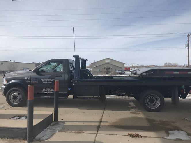

Here you go, OP.
Nice, barely used '17 Ram 5500, oil field hotshot rig, complete with step deck trailer.
https://www.ksl.com/auto/listing/4525833?ad_cid=1
Nick

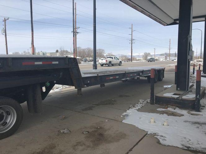

Notice how close the trailer sits to the deck, and the length from front of trailer to back of truck. Seems like that could be an issue on uneven ground. Nice rig tho for sure.
Yes, seems too close. Also note the trailer size and axle placement, I think it is going to overload the truck pretty fast. Odd that it is for sale already. The seller sounds like a woman, so maybe a divorce settlement?:)
