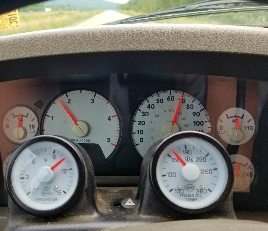

Back on flat land again finally. Towing in my sweet spot with 3.73s and 19.5" tires. If I drift down to 1500-1600 RPMs the energy is lacking a bit. If I keep 1750-1900 RPMs the engine is much more responsive. While in Elkhart the wife and I test drove a 2017 dually aisin with 4.10s. What a beast. It had air suspension. First comment from my wife was this truck rides NO better than our truck. I checked the air pressure. 65 psi front and back. Got it up to 50 MPH and first thing she said was the truck felt squirmy. Below is towing my sweet spot.
I do like that white instrument gauge cluster.
Wow, a better ride with H-rated tires? That's impressive. Was the skwirminess with a 5'er in tow?

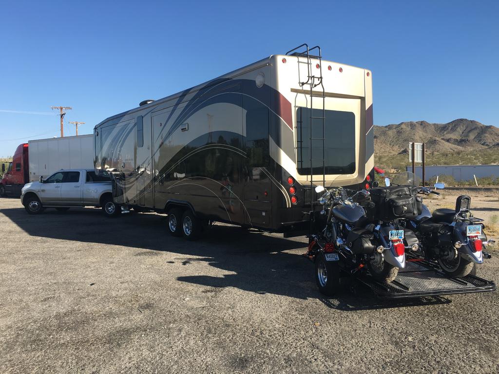

Towing doubles at 35,340# combined my truck is ROCK solid. Add another 5k and I guarantee it would be no different. The FACT is my pin weight is at least as much if not more than the vid above.

12V I am not sure what you mean by towing double. It is not the pin weight that matters. The wag danger comes from the 25+k that is on the rear part of the first trailer that is violently putting side to side squirm on the rear of your dually. The tail wags the dog. Now lets talk about your double towing. I suppose your first trailer is a gooseneck. What is your second trailer and how is it connected to the first trailer? How much tongue weight and how much total axle weight on first trailer?
Here are my weights. The last number 1,780# is the weight on my single axle MC trailer being towed my my 5er. My weight being towed is around 25K with about 6K pin weight.

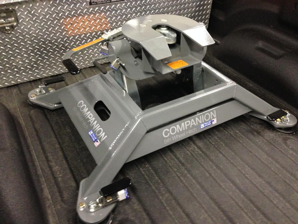

Do you know the capacity of the hitch on the rear of your coach? What brand hitch do you have in truck?
