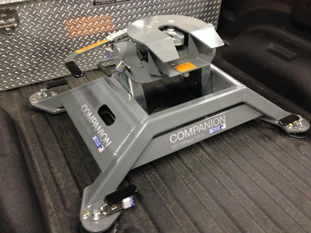

RV hitch 3,000# towing and 300# hitch weight. Truck hitch for 5er is Companion RVK3600
You would never tow a 30K 5er the pin would far exceed the RAWR. The 30K towing is for gooseneck applications.
