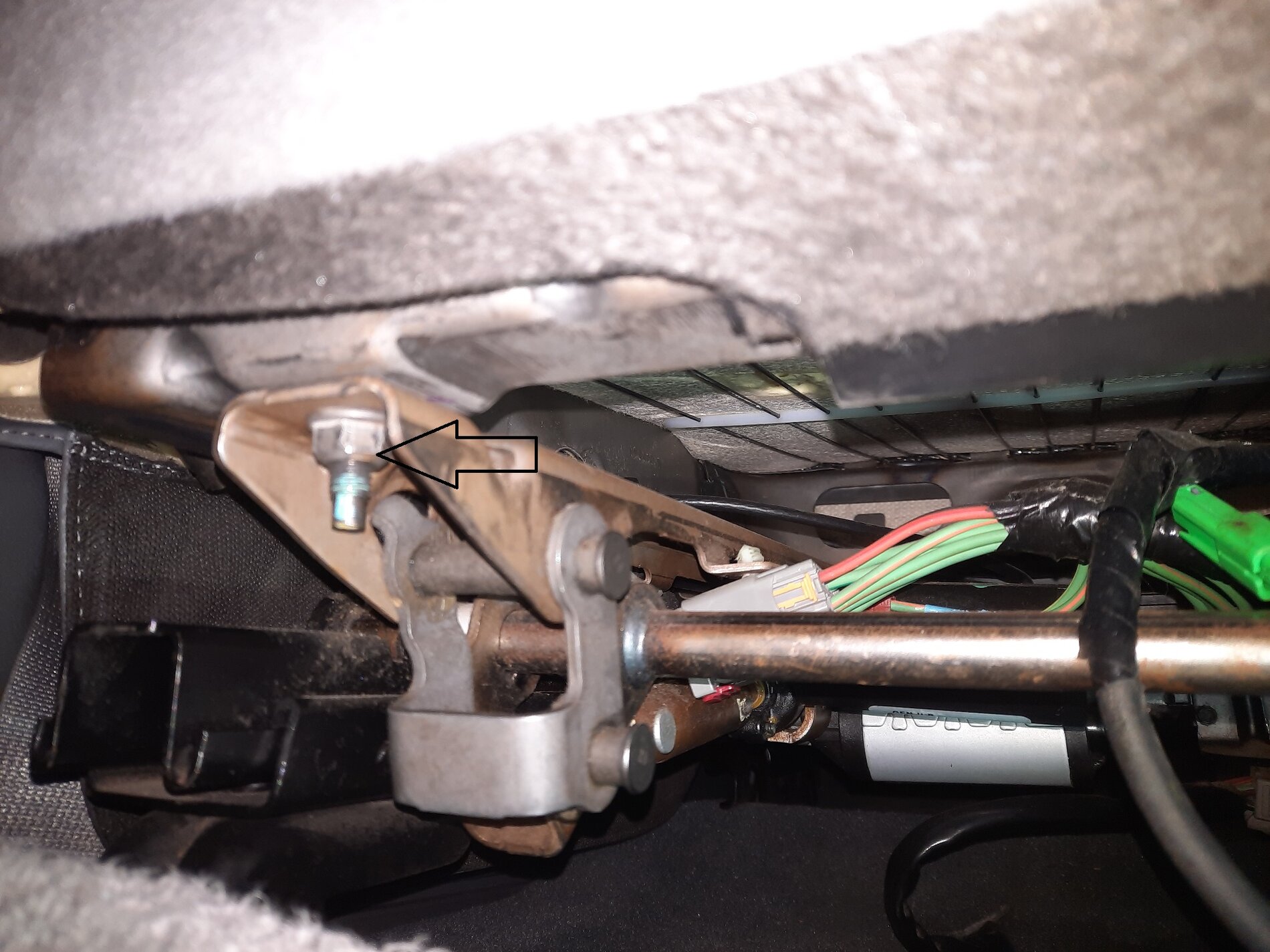

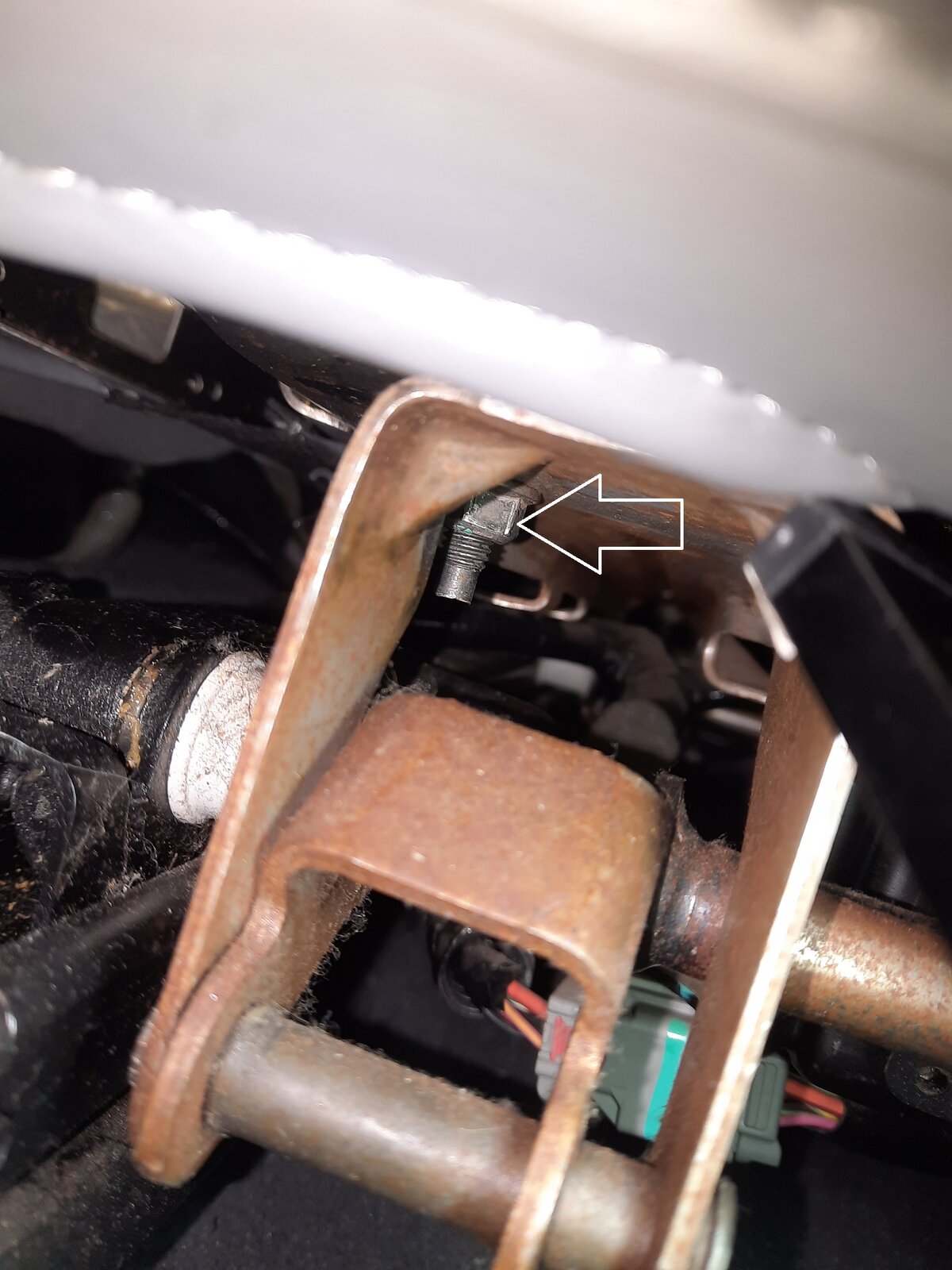

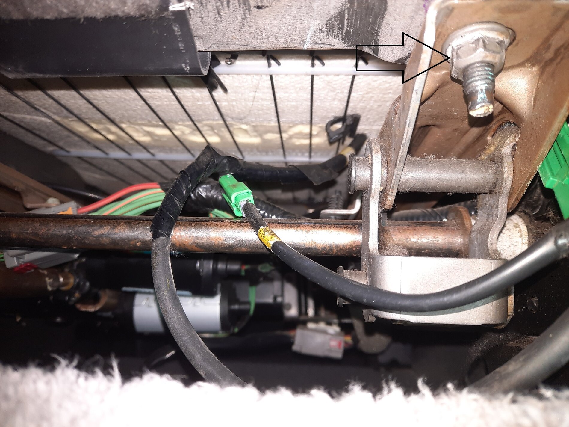

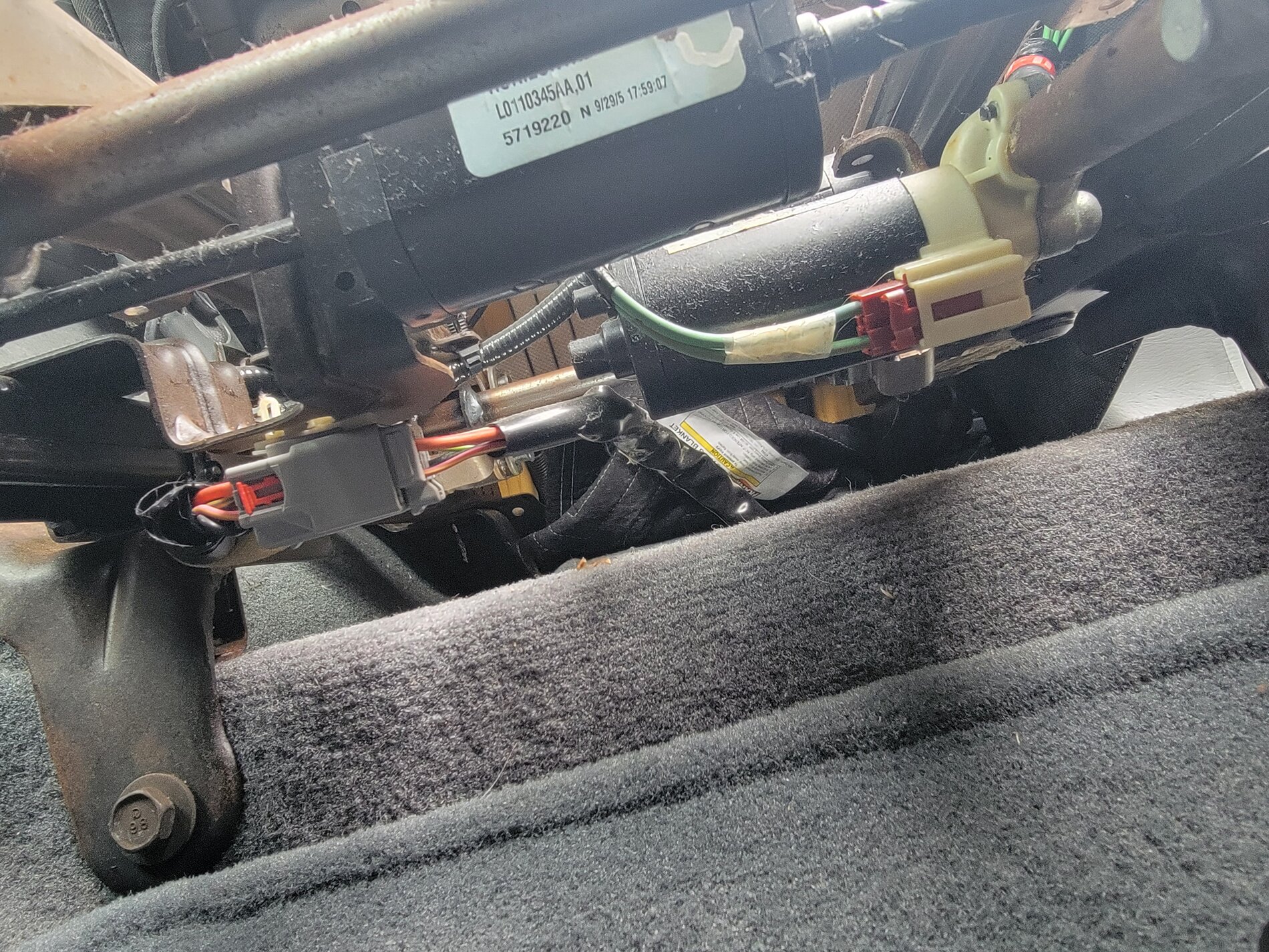

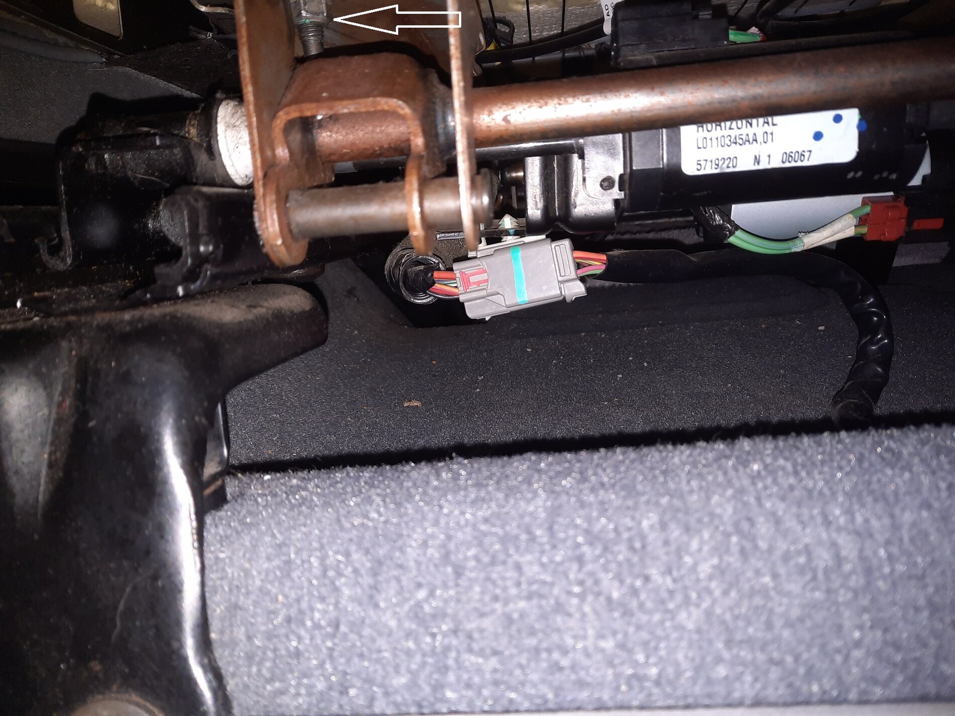

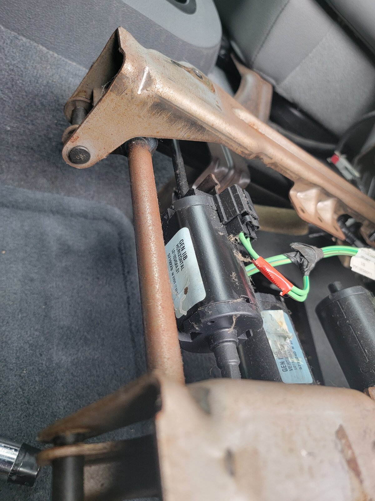

Super easy. 4 bolts/nuts and it comes right out. Let me go get some pics
4 bolts. 2 in back
Back passenger
And 2 in front
Driver seat, passenger side nut:
And driver seat, driver side nut
Thanks so much! Gives me a starting point! I may reach out if I hit snag!
The back ones are super easy. The front ones are harder to get to - I had to raise the seat up to get in there.

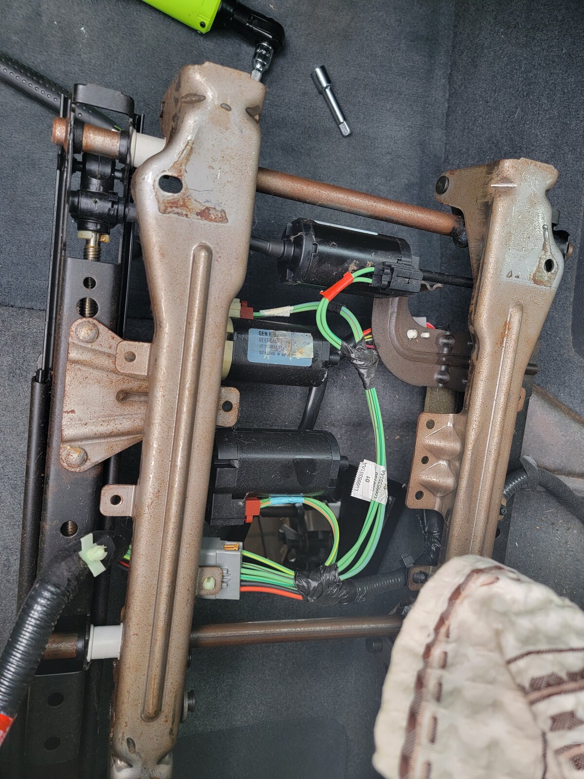

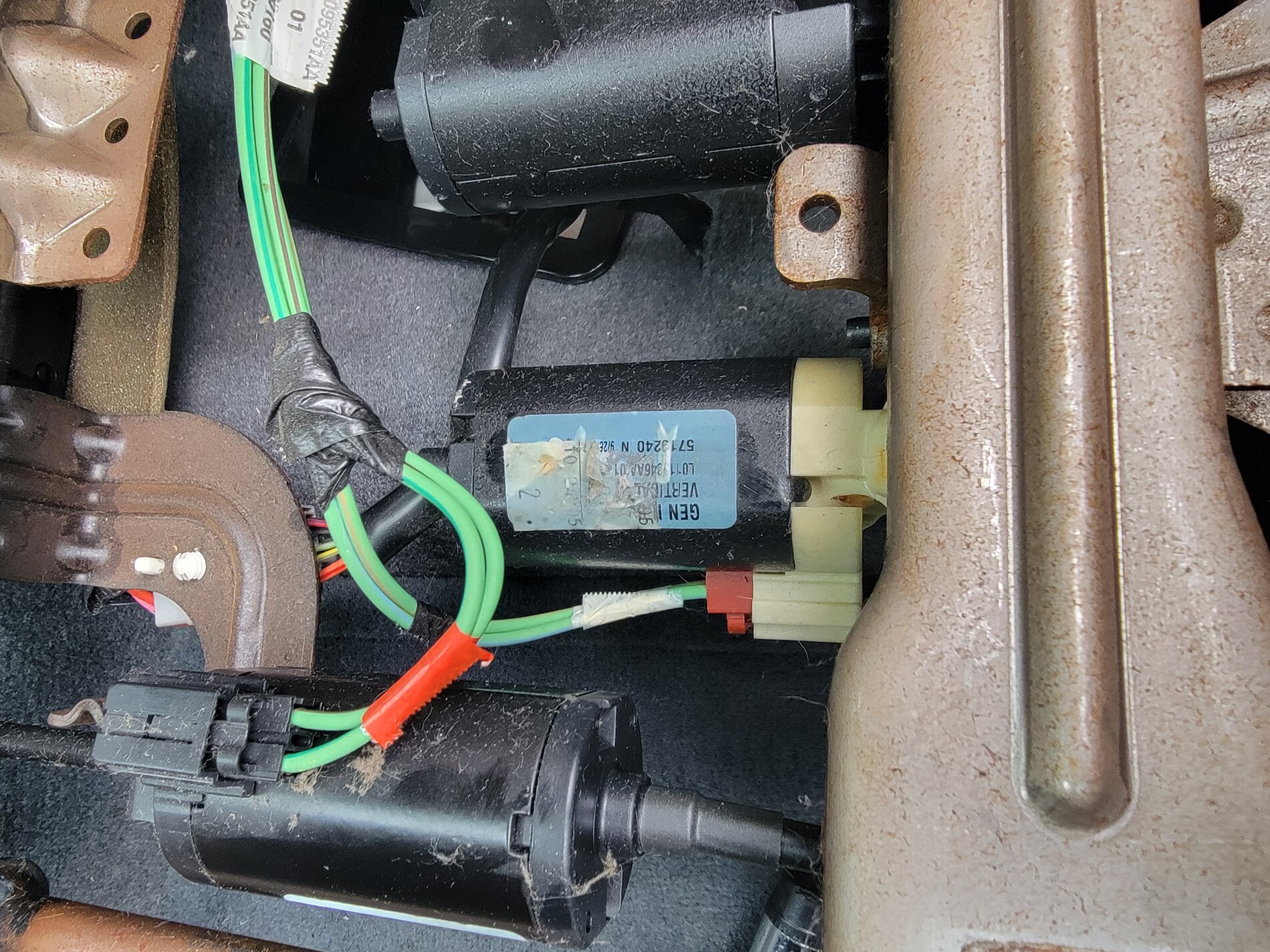

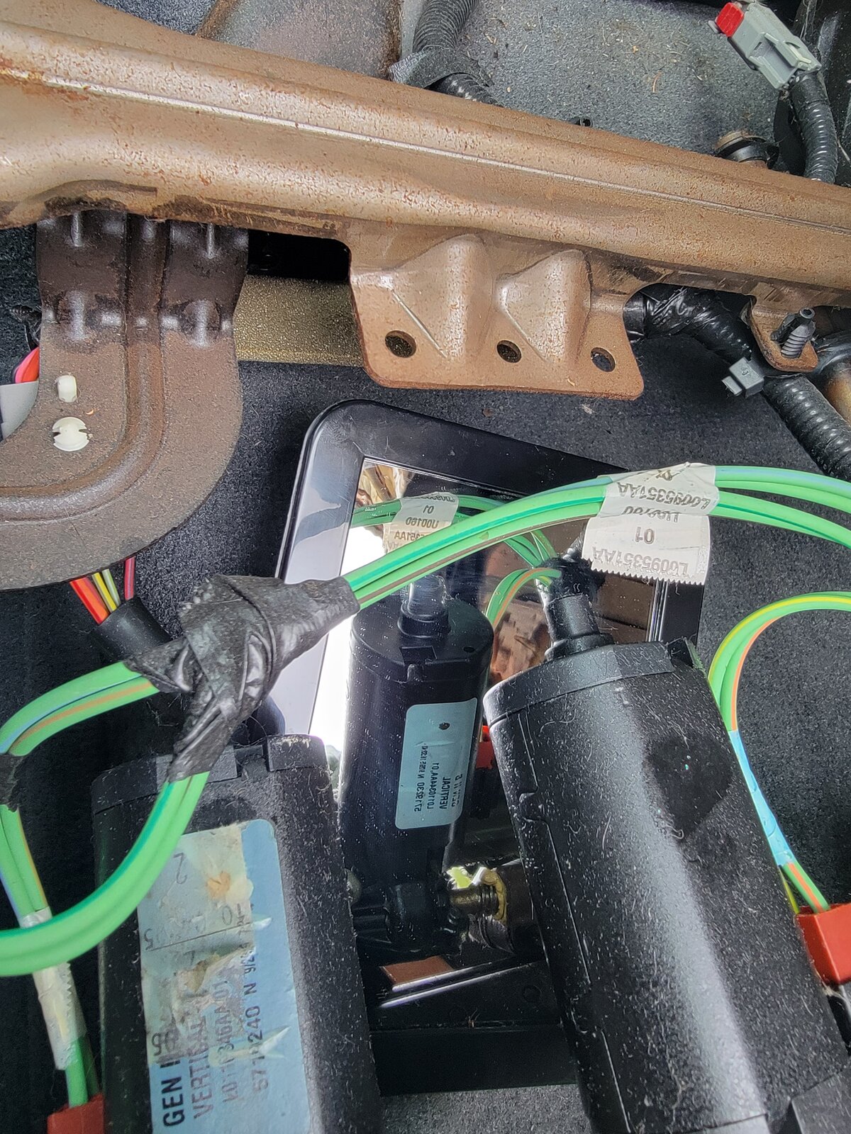

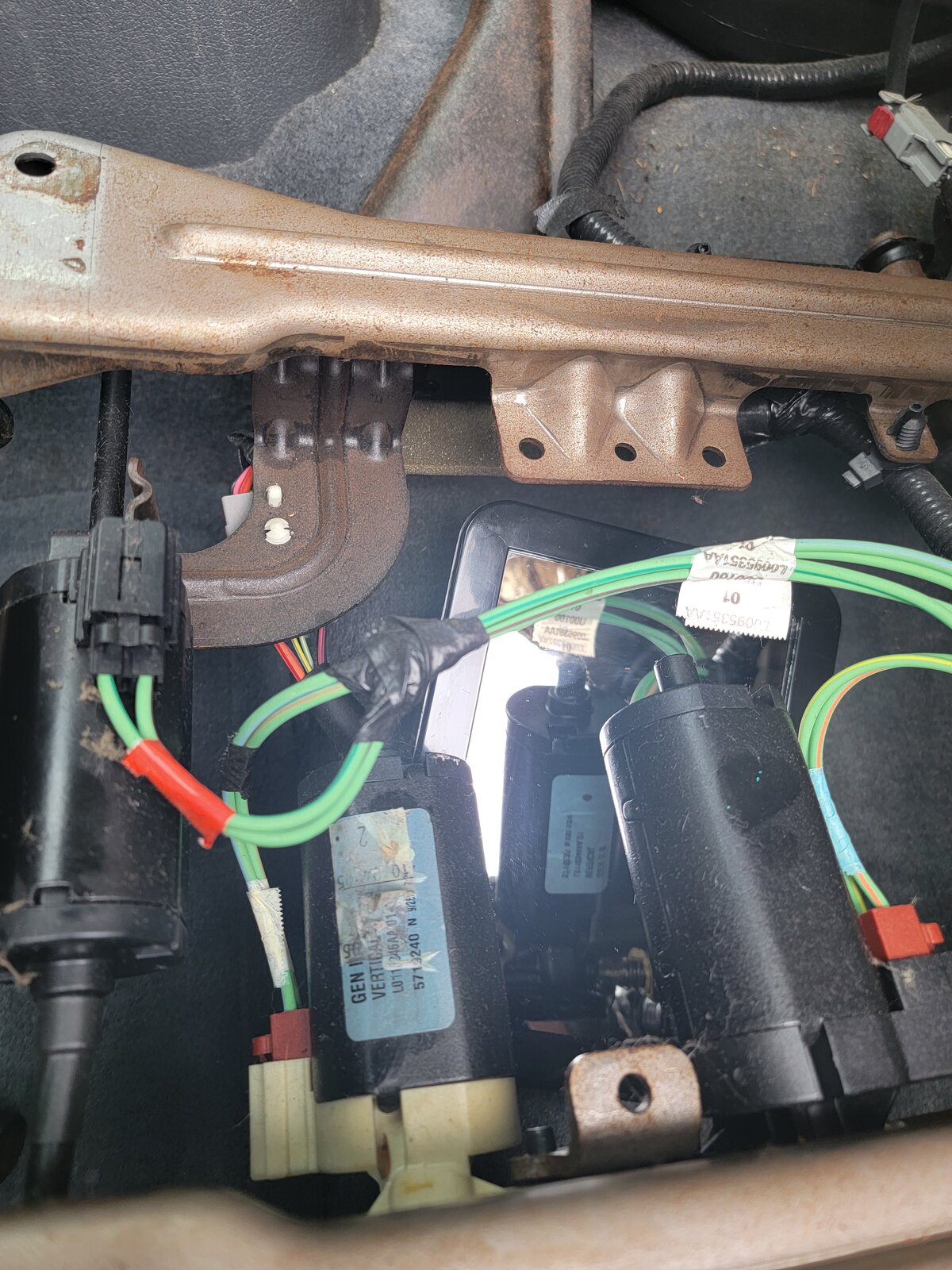

I'm not sure if the video posted but I finally got everything exposed under my drivers seat. The issue was originally the seat went all the way forward and wouldn't go back. ( where the track is now). The other motors were running but not moving anything. On the forward/ back motor you can see it engaging briefly and moving the seat forward a short distance and back the same amount. If the gears were stripped, wouldn't the motor just freewheel? And why aren't the other motors moving anything? I can't believe all 3 motors are bad. I don't want to start throwing parts at it. Any additional help is appreciated!
Depends, its a worm drive system so a small area can fail and it'll move until it encounters a gap then stop. I had 2 fail on my 04, no rhyme or reason, worked one day then not the next. Geno's kits work very well and are not to difficult to install.
Thanks! Genos kit consists of the motor, which comes with new gears?
I didn't see a video, but to answer your question, yes, the Geno's unit comes "complete" - just remove the pins from the old one (1-3 of them) and replace it with the new one. Hardest part is getting the roll pins out of the old unit.
