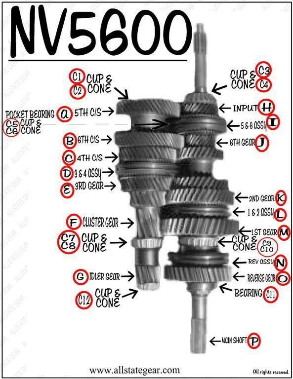

I do the same thing with my NV5600, they are tough. Here is a picture of one, I will try and explain why they are so strong. Note where 6th gear is, it is up front next to the input shaft, very little room for torque related torsion. If I am running freeway speeds I stay in 6th if I can maintain 65 mph. With 400hp/950tq that's most of the time. On big hills or 2 lane slow roads I stay in 5th. Note the 3 counter shaft bearings and the 2 rear main shaft bearings, most trannys only have 1 on each end total.
The reason the NV4500 5th gear runs hot and or fails is because it only uses the one bearing per shaft end, and of all things, 5th is out side the main case. 5th is on the opposite end of the input shaft so the torque travels the full length of the shafts and case. Then to top it off, 5th gear is outboard of the rear bearing, it has a cantilever affect, huge no no.
I love my NV5600:D
