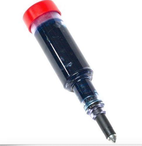

I use something like this for chainsaw bearings Oregon, Husqvarna, Stihl all carry these can reload with all grease has right tip and fits in and you just push. Can buy on ebay, hardware, chainsaw supply, easy for the job. When new are pretty dry, after about three or for pushes on back. Easy solution, not messy, works great.

Yeah. Thanks Too Tall. I succeeded in getting it to come out the other side twice. (2 previous years). Broke 2 injection needles this year and don't know if i got enough grease in. I think i was just careless i the heat and humidity. Will try again. I wondered if the chainsaw grease tool has enough pressure to make it come out the other side. And i was looking for an easier tool.
The chainsaw grease works great will come out other side. It develops sufficient pressure to fill joint when new it took 7 pumps subsequent changes 4 pumps wipe off excess done.
OREGON26365 CHAINSAW CHAIN BAR GREASE
Hope this helps metal tip fits right in available at Ebay, Hardware stores, Refills for grease or use your own no mess goes right in joint. put in joint and push pumps grease right in.
