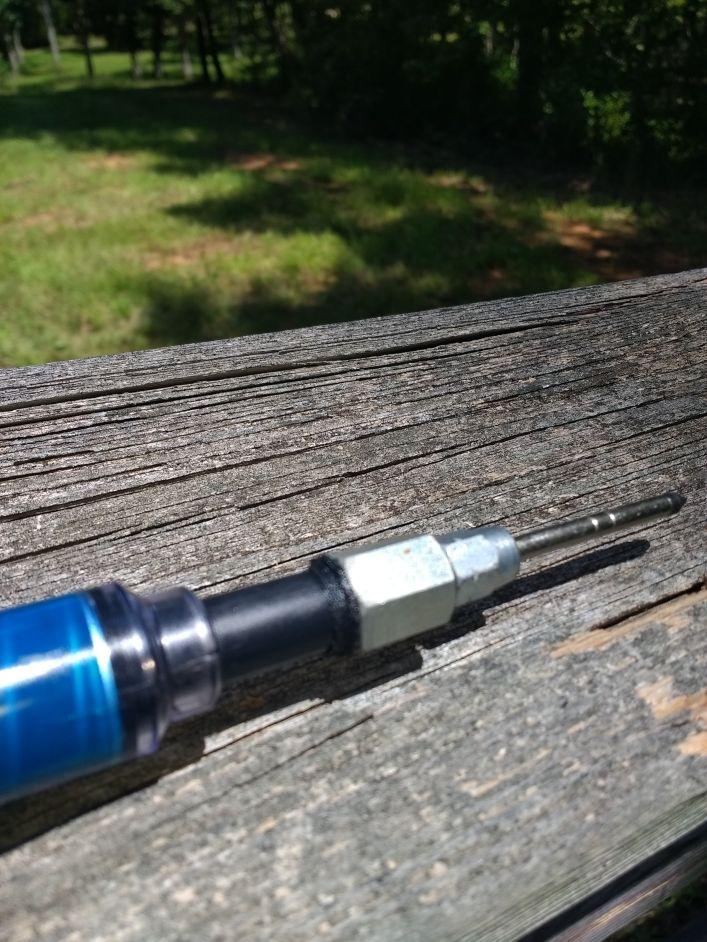

Here is the tool I used along with the small handheld grease gun.

I combined the two for a handy tool that will reach , and is small enough to carry along in my on board maintenance box.
remove the tip from the Oregon tool , use a propane torch to heat the threaded end of the adapter enough to melt the plastic end of the tool.
screw them together quickly before it cools . you will have a leak free , permanent joint.

Nice, same basic idea as mine (see previous video post) I like having everything rigid. The small grease gun is a great idea. With a hose it was pretty tough without an extra hand.
I use a gun that is operated with one hand ( pistol type) that leaves one hand free to use the tip so the flex hose & a 6” needle works well for me

Did you try just the push greaser tool?
I did try it , but found it to be a bit awkward. so I added the extension.
it works well enough that I rotate the joint to the top and can feel the pocket for the tip , and do it blind.
I get better leverage.
Also if the grease is cold it is tough, just warm it up first. I use a light bulb on the joint for 20 min and keep the grease gun inside, makes things flow much better.

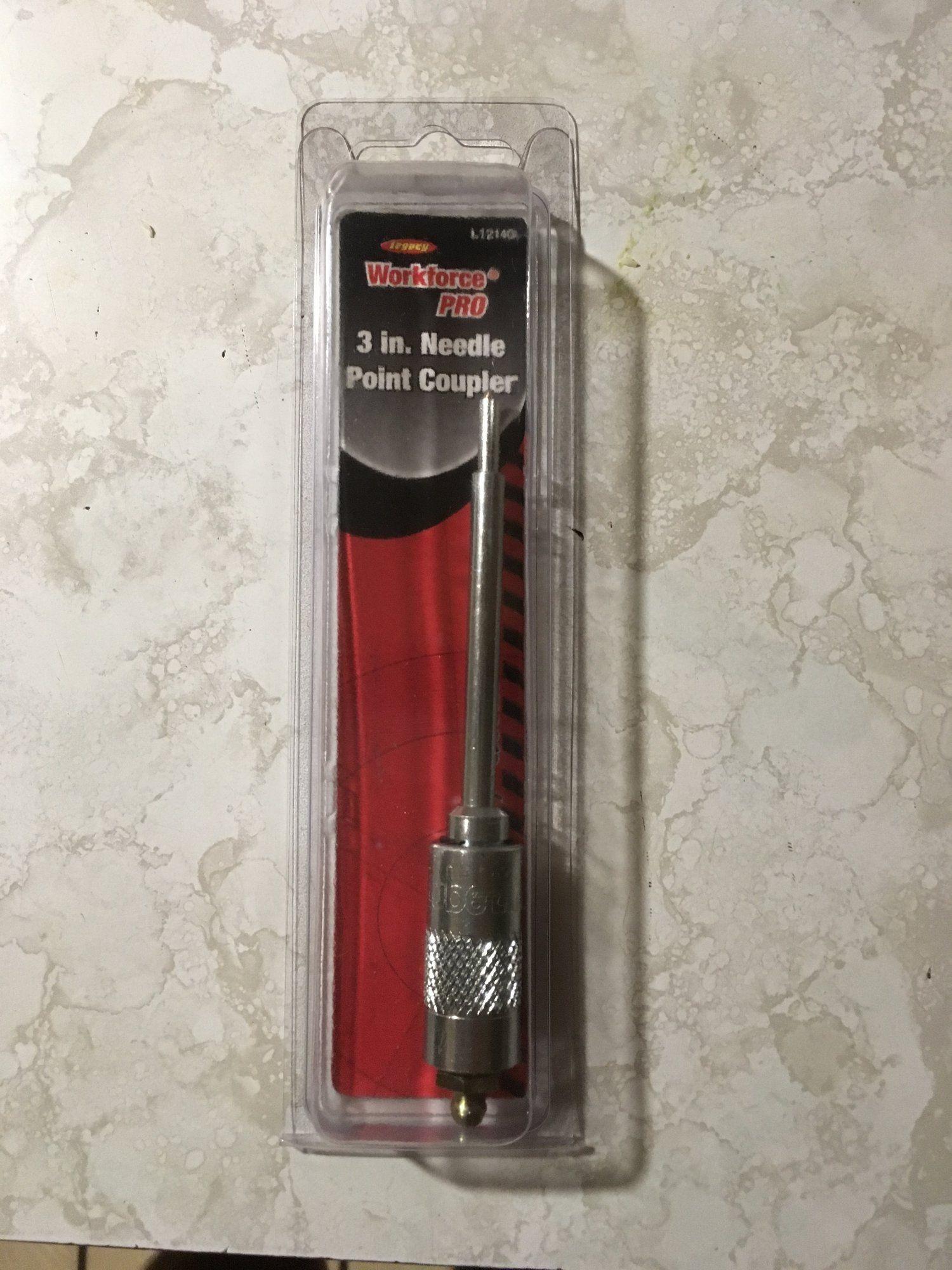

After reading this thread, I used the same Lincoln 5803 needle from O'Reilly and a standard short hose grease gun like the ones some of the guys in this thread have shown. I cleaned the lube point with a Q-Tip which worked better than anything else I tried - also read about that idea somewhere on here or another forum. The setup worked like a charm.
