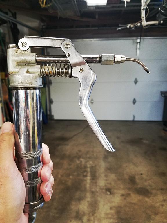

This is the gun and needle that I use. I bent the needle as shown and it just fits in past the trans cross member and wiring harness.
On my 2006 Mega Cab, i use a long Lincoln 5803 type needle (see post 67) on a regular grease gun and go right up through the hole in my crossmember after i line up the Cardan joint with the hole (straight down).....easy peasy. Just wondering if anyone else has tried it this way

Newsa, are you using the Lincoln type needle??.....cant see how you can break them off or damage the Cardan joint with it.
(Lincoln Lubrication 5803 Grease Needle Nozzle on Amazon)
I am using the Lincoln 5803 needle.Its actually more like a tapered tip that just fits in the tiny "saucer like" injection site of the Cardan joint. After i discovered that i could grease it through the hole in my crossmember,its been too easy .

Great thread - after removing the skid plate, I used a Lincoln 5803 needle nozzle on a mini grease gun. No problem with access and 5- 7 pumps pushed gease out the center hole. I used the LUCAS X-TRA heavy duty grease in lieu of the LUCUS RED since that is all I had. I know it was suggested that the RED be used but does it make a difference?????

A needle point adapter is not the right tool. You should have a tapered point adapter that seats in the button grease fitting. I made this one years ago. There are similar commercial ones available.

BTW poking at the little ball and spring check valve with a needle adapter gives you a chance of damaging the check valve in the button style grease fitting.

I agree totally. My little ball is long gone. I had that tapered style, it didn't work well for me.
