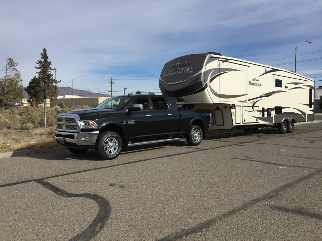

new truck trailer combo.. hope 3.42s aren't too low….

View attachment 94145 new truck trailer combo.. hope 3.42s aren't too low….
28-29K combined towing with the 3:42's with my 11 Dually. ONLY negative was getting the load rolling. I would not hesitate owning a Dually again with 3:42's "IF" it had the Aisin with the lower starting gears. I would limit my combined to around 28K above that 4:10's. I would not even consider the 3:73's.
At 60 mph 3:42's in 5th are running about 1,750rpm and same with 4:10's in 6th. So SNOKING for example said his 3500 SRW with 3:42's stays in 5th when in TH no different than my Dually in 6th.

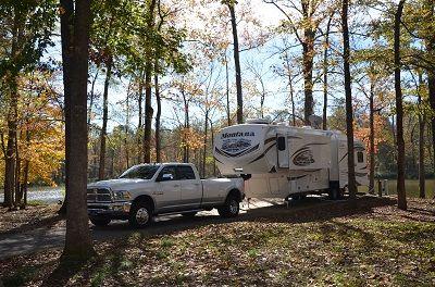

dfb: Nice set up you have there. Have you ever checked out the MontanaOwners.com website? Lots of great info there!
Yes!, thanks for asking… We bought the 2015 3610… LOVE it so far… Reason for the question is that I had an 04.5 Cummins Dually. I loved the way it pulled the 5ver. However, hated driving it solo… At 60mph I was at 1950 on the tach… New truck is like 1250 at 60….I had to get rid of the manual. Osteo in knees and just had open back surgery for spinal stenosis related to the Arthritis…
RV is at 12200 out of the factory.. Plus the rest of the stuff. Food, clothes, tools, satellite dish etc… GVWR of 5ver is 16k lbs….. 5ver is 39 feet…. Montana 3610 legacy…… How does your shorted do? I was going to with a super glide but opted for the anderson ultimate…….

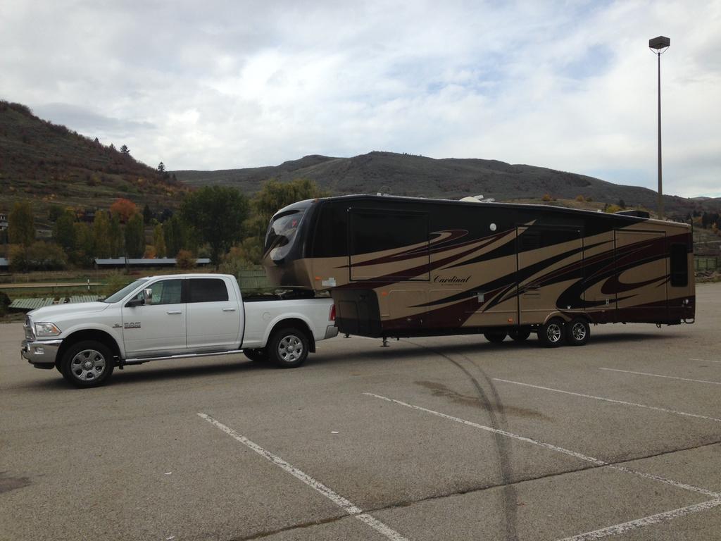

cardinals are very nice btw..
Thank You for the information….. I did opt for the Aisin.. Truck takes off strong…. but they have kind of a dead spot in pedal at first...
My GCVWR is 23890 lbs. With 3:42's, she's no hot rod off the line, but I'm happy with it. Not to say I wouldn't be happier with an Aisin and 4:10's, but I'm happy.
Les, have you weighed your rear axle? New Cardinals are noted gor heavy pin weights.
I am at 6750-6950 depending on holding tanks. And slightly over trucks 11,700 GVWR.
