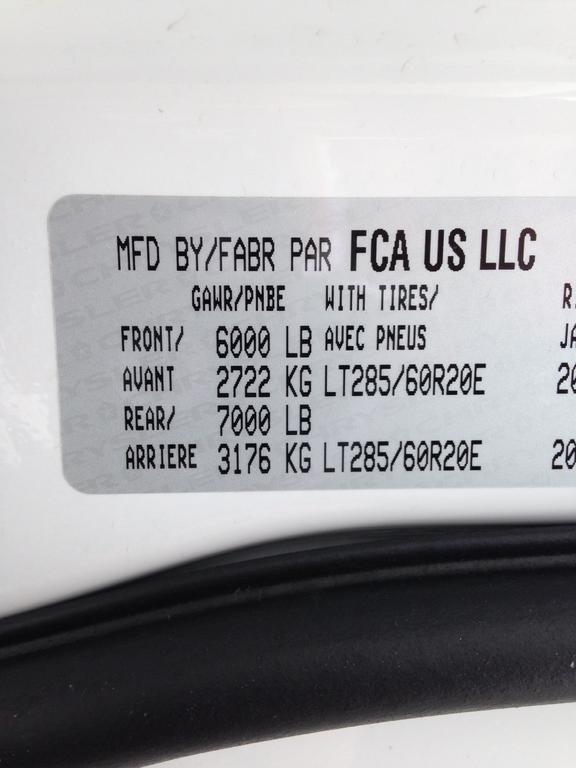

The rear axle rating on the 3500 is 7,000 lbs.
I assumed you had the stock "E" tires. If that was the case you can see how easily the RV axles can be overloaded.
I would still weigh EACH RV axle.
Here is my door sticker. 7000 lbs @ 80 psi.
