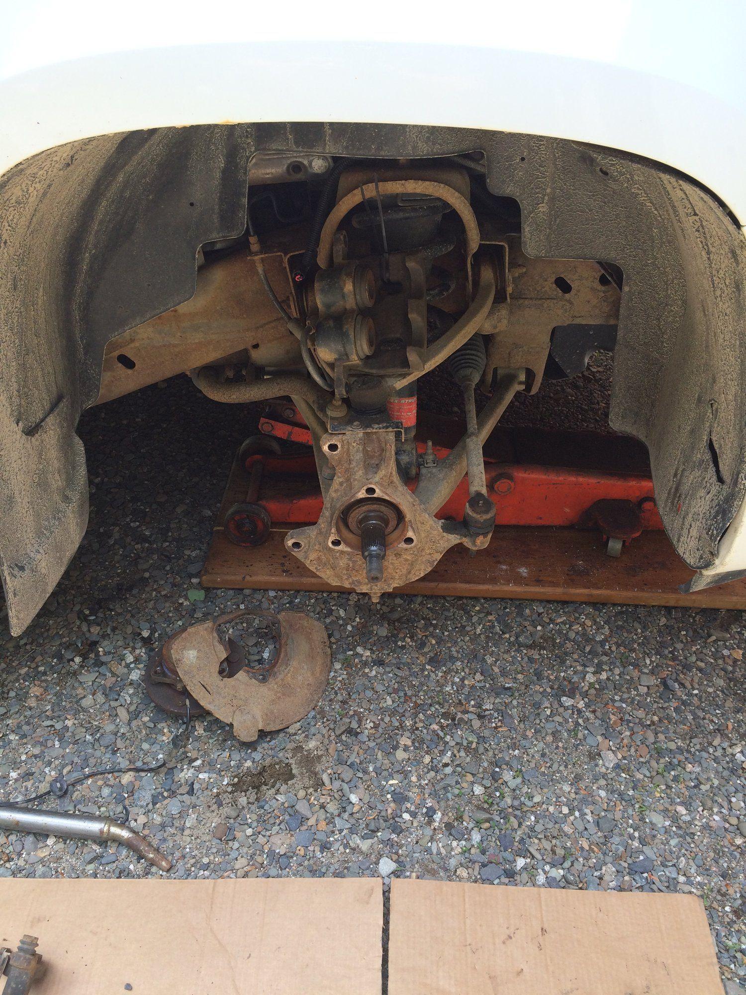

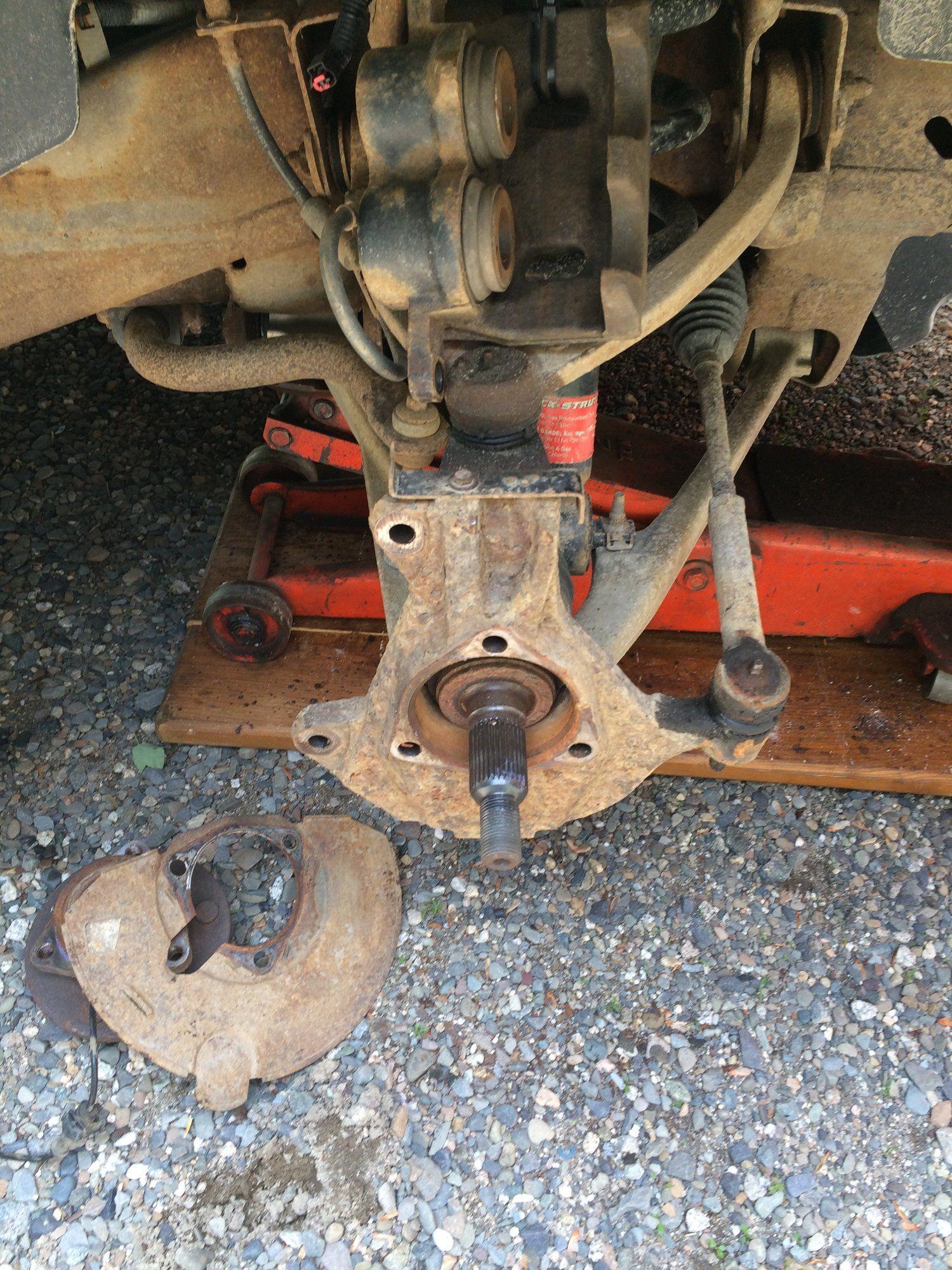

Tore into Yukon today, hoping to get it back together in time so I can evaluate the truck.

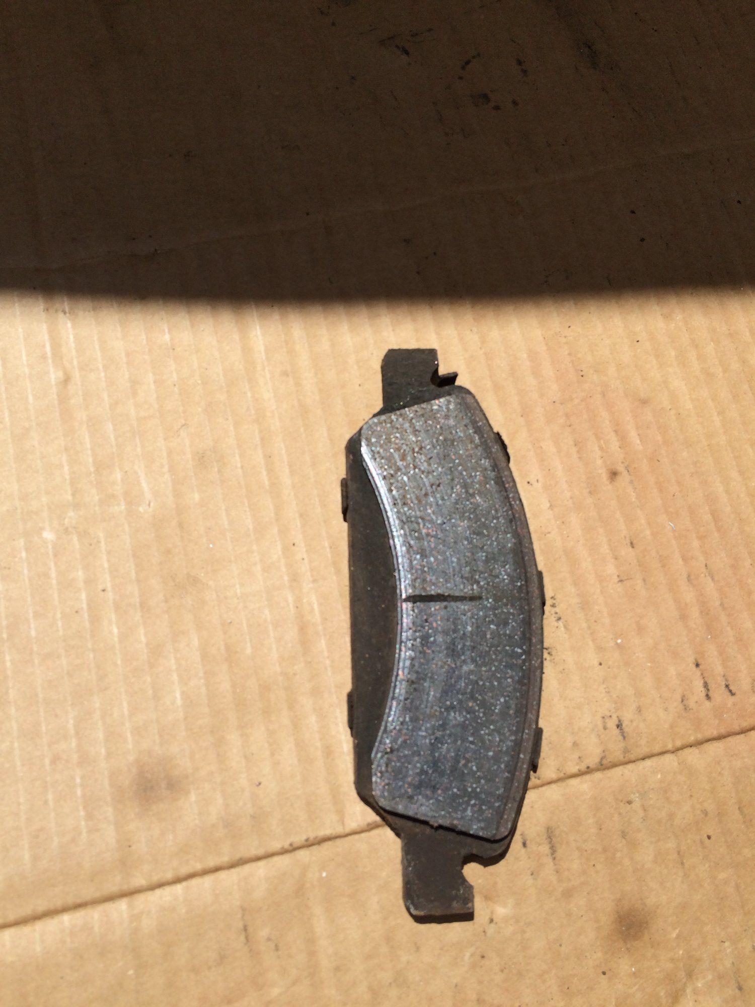

Brake pads shot so off to town I go.
C/V nut was so tight that my 1/2" air gun would not touch it. Had to put my 3/4" drive ratchet on it and stand on the handle with both feet. Then bounce a little. Torque is supposed to be in the 177 ft lb range BUT that was not the case....

Ok, after changing both front wheel bearings the Yukon is 100%.
Found sticking caliper slides on the truck, replaces them which helped a ton, but there is still something amiss. Truck is here in Jonesport with me so will take it apart again after we get home.

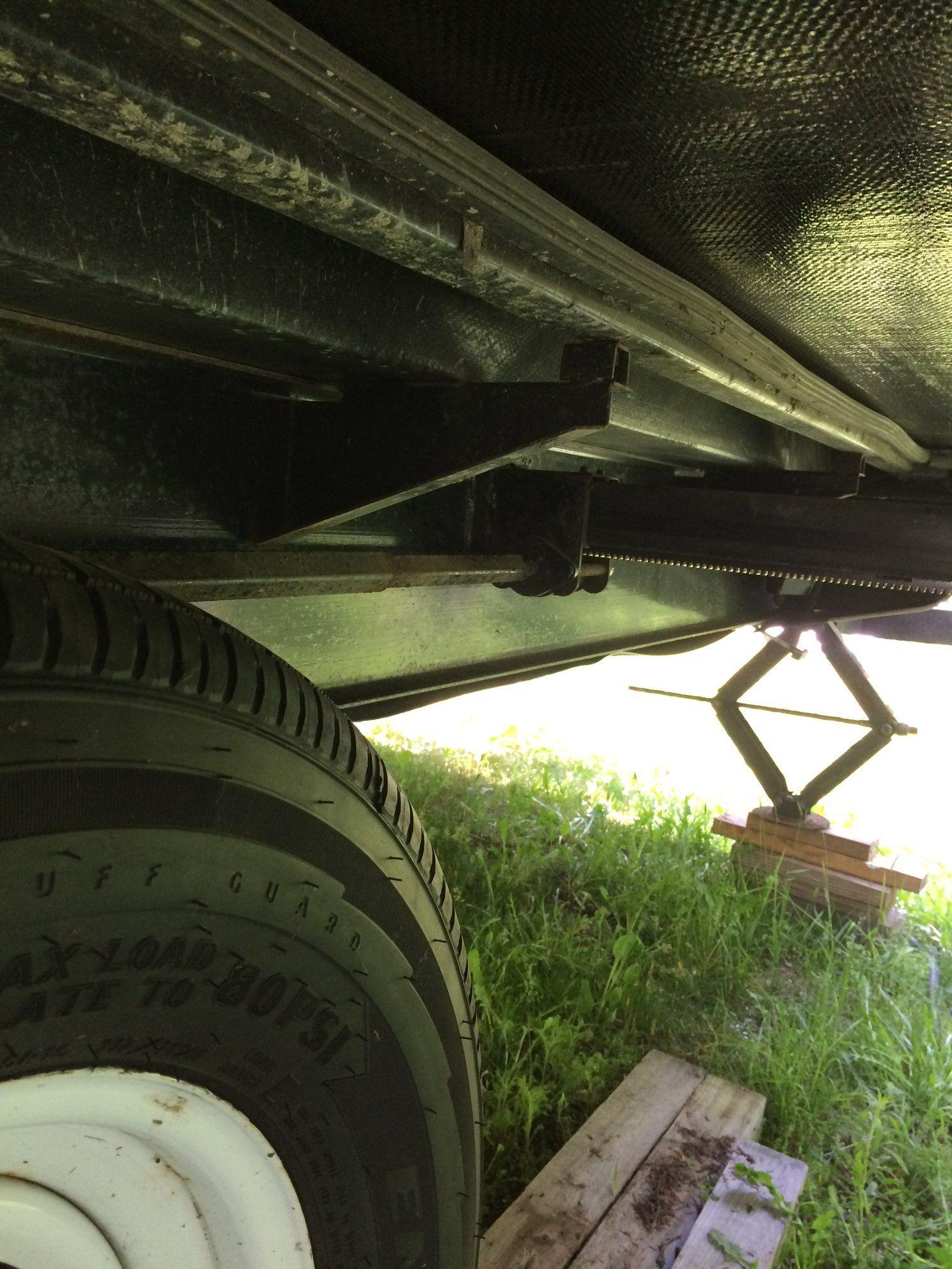

Going under the fifth wheel shortly to remove the belly panels. Then see what could have happened to the electric slide.

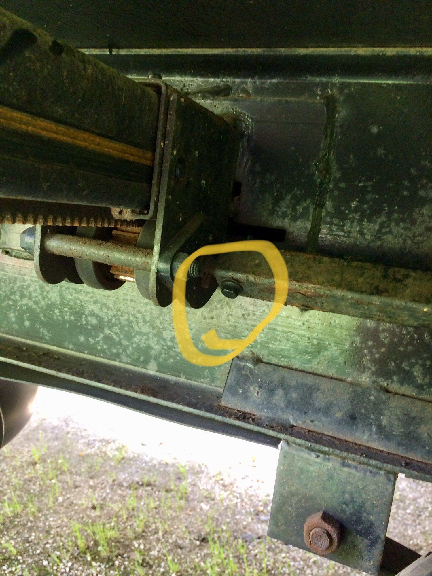

Found the problem (I believe), I don’t have to drop the belly. Will get pictures when I go back under there.

You didn't expect that to come apart easily after all of the salt it has been exposed to over the years did you? :)
Oh God no. But that right one had been replaced at some point and they over torqued that nut like a lot!!
The left one which was original came right off with the air wrench...
You mean the tighten until you grit your teeth method. My father was always good for that. Torque specs.....we don't need no torque specs.
Mike, are you an official Lippert slide repairman yet???
I don’t know about the official part but it’s working again. The bolt that goes into the drive tube for the slave rack was GONE!!
I don’t know where it went, it’s not on the ground or I just haven’t found it yet. Raccoons are pretty clever here, maybe they unthreaded the darn thing.
Local hardware Store had a great selection of Grade 8 stuff so picked up four bolts and locking nuts so I’d have some spare on board...
