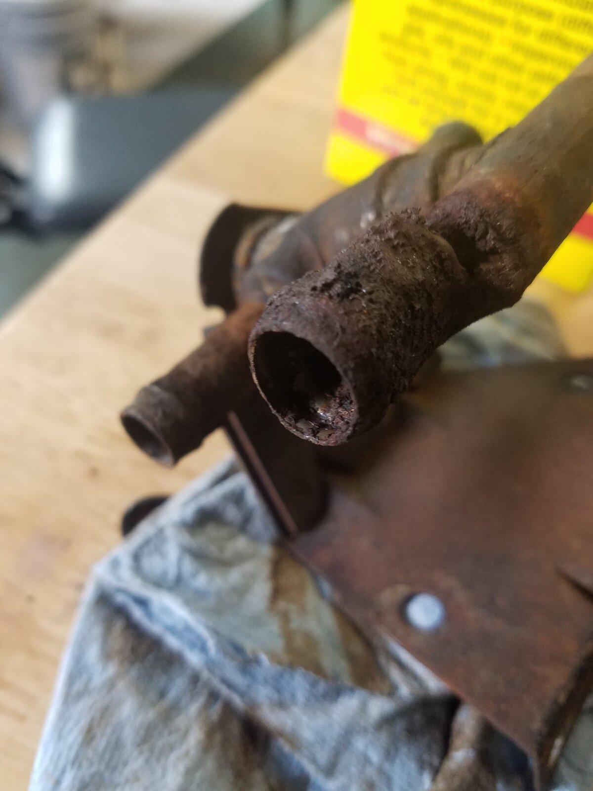

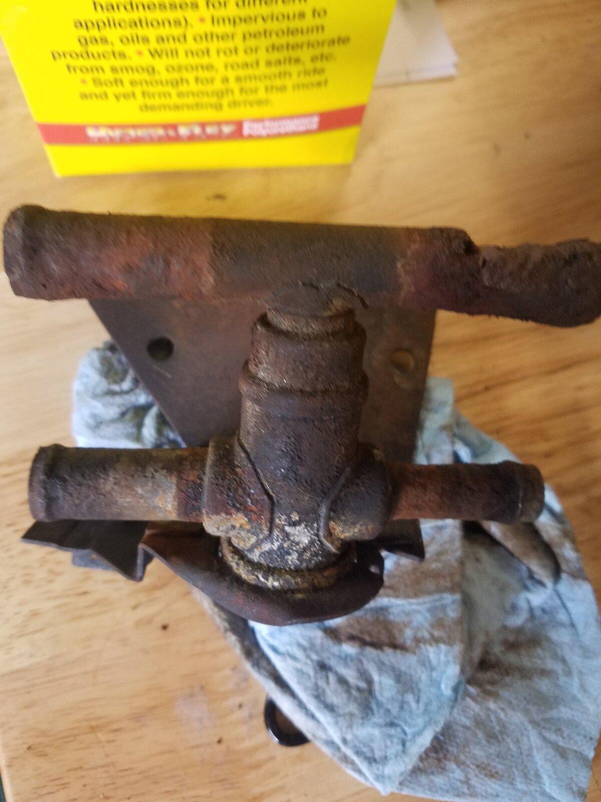

My new heater valve came in Saturday so did an R&R today. There was black crud in there, ball seal shot, and heater core was mostly clogged. I flushed out the core separately today, will flush the entire cooling system tomorrow, R&R the thermostat and coolant.

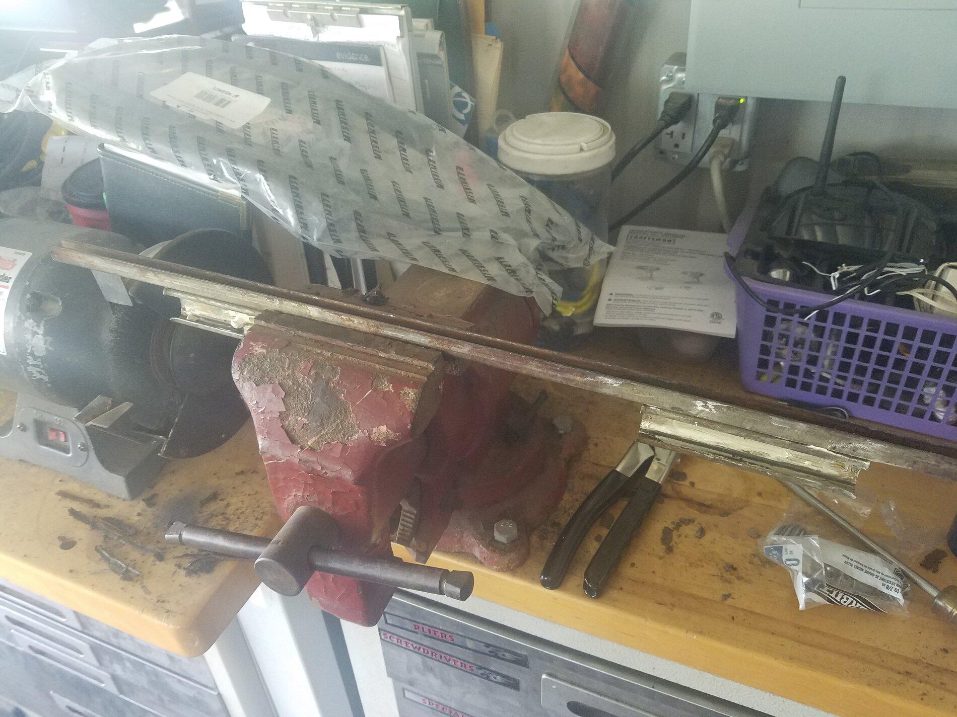

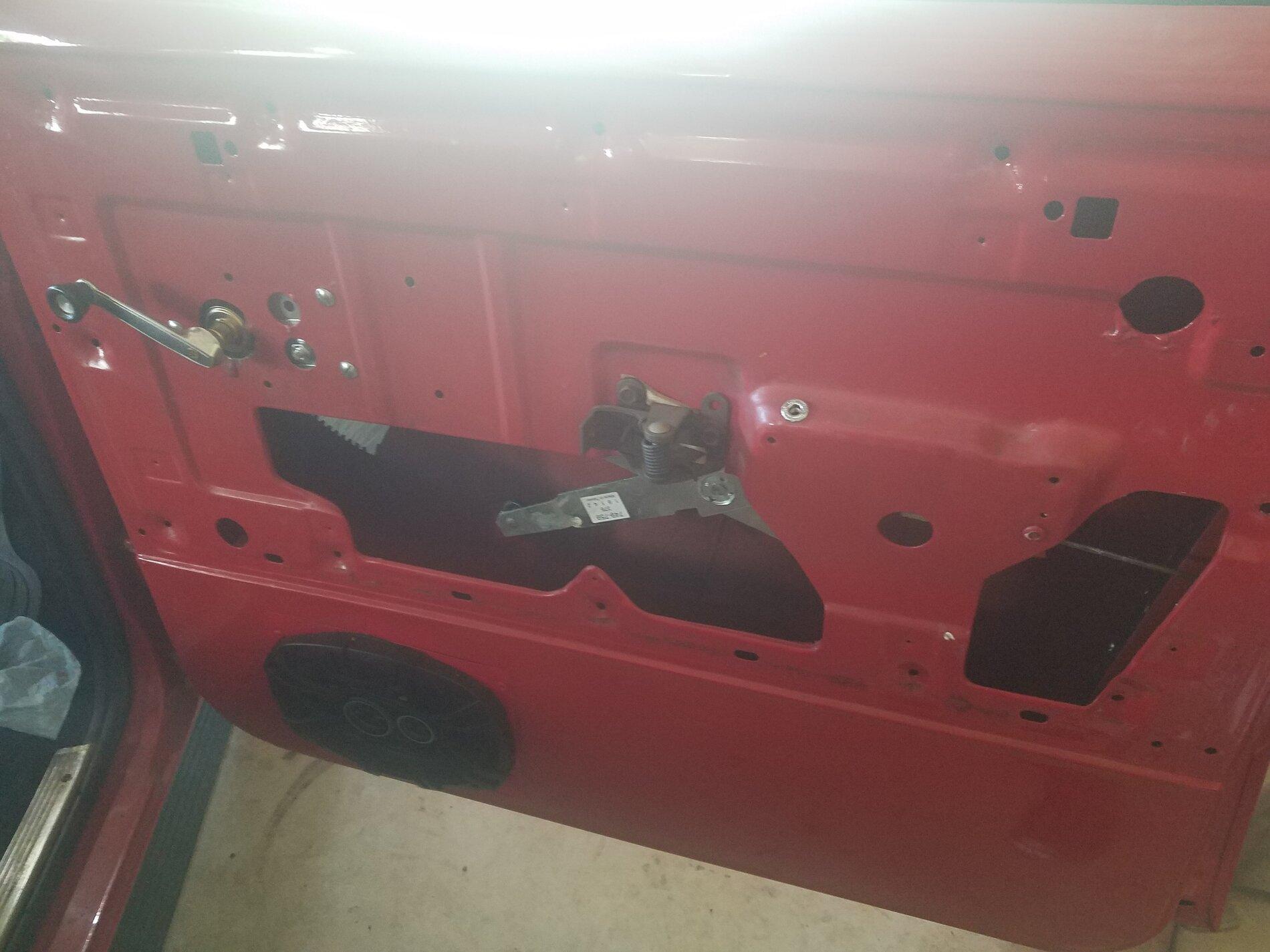

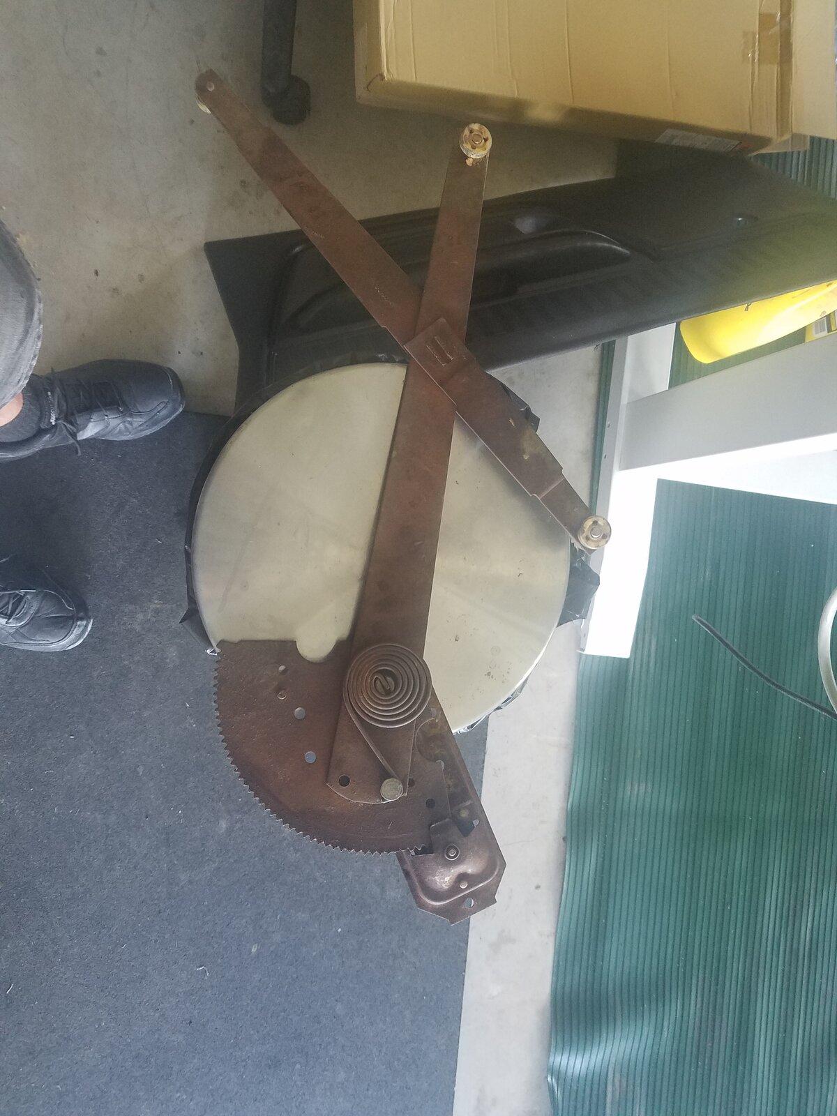

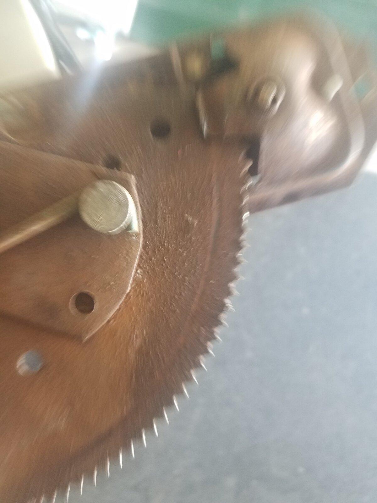

Replaced the right (pax) rollup window hardware today and the doggone window came out of the window glass lift channel and wouldn't go back into it. Seemed it was either bonded or glued into the channel. Decided to clean the channel out and ordered window adhesive to fill in, let partially set, and attach window into it to see if this works. Here's pics
old broken hardware
Broken teeth close up
the glass channel
And the truck door with new hardware
Amazon delivering glue tomorrow, so I'll get her installed and let her set a few days to completely cure.
