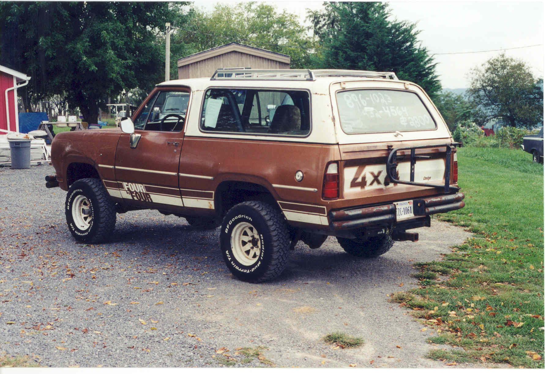

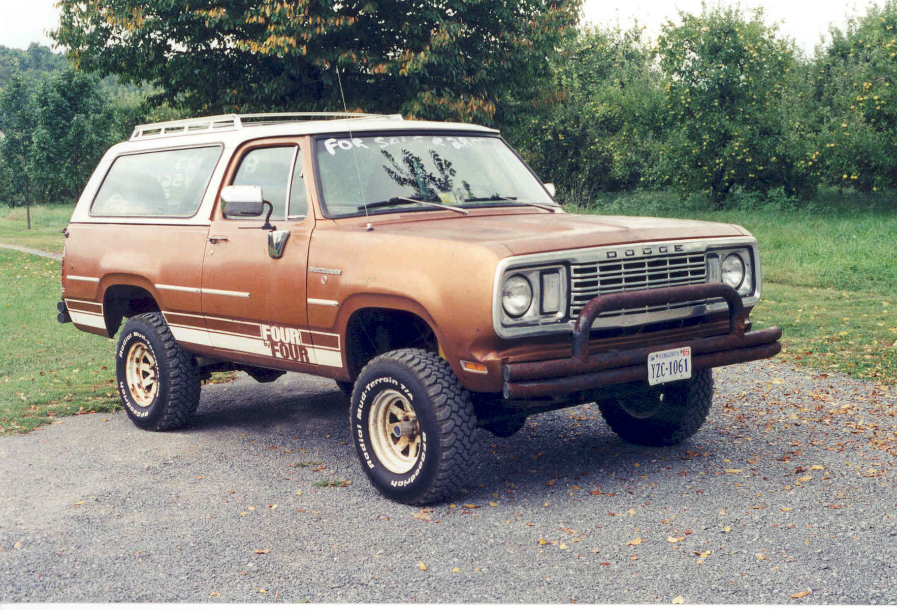

Here is my Ramcharger that I had. It is a 77. Started life as a 316 - progressed to 360, then 440.
This is how it was when I sold it when I got the 96 Dodge Diesel PU.View attachment 129785 View attachment 129786
You ever heard of anyone installing a hi-flow intake, 4bl carb, headers, and dual exhaust out the sides in front of rear tires and with tall, skinny mud tire 4spd and a 318? A friend, who worked in the site motor pool had one in Iceland... the only thing I ever saw be bad at was climbing steep... just a lot of weight. You had to get decent fuel mileage in Iceland because you use a lot of fuel four wheeling, have to get back plus some reserve for unforeseen events. Anyhoo, that 318 had a 650 (I think) 4bl that got fair fuel mileage up there. Iceland in 1980, only sold 82 octane fuel (gasoline), so had to do a lot of tuning on a V8 to get it to run OK. I'm told you can add a little aviation fuel to car gas to raise the octane, but I can neither confirm or deny that fact.
Anyhoo, thanks for the photo... really scratching that itch for a Ramcharger....
