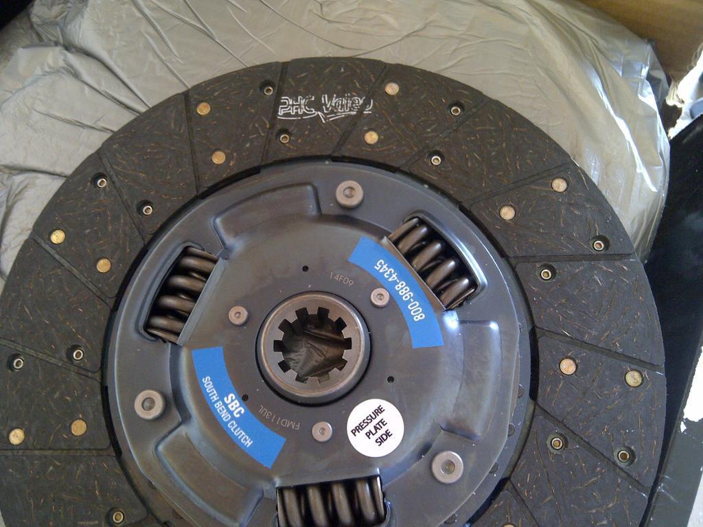

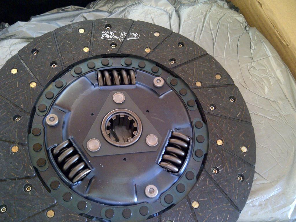

Called and talked to Peter at SBC. Sure is a great vendor and supplier of clutch parts to deal with! He sent me another disc to try and hopefully I can get it installed Monday before I leave for Casper Wy. this next Thursday. 1200 mile one way and towing my 5th wheel. What is weird that with the clutch in it now (1947HD) I hear neutral gear noise at idle when cold and when the trans is hot, it is quiet. The disc he sent me looks a bit different. I will report back if I can get it changed. The operation and smoothness of the 1947HD is sure nice. Even smooth in reverse!
Going to WYO see the solar eclipse? Different color or other difference? My 1st was red and second was unpainted with a blue sticker. (SBC cut me a break on the 2nd clutch as it wasn't their fault it got ruined.) Around 25K on mine and yes it's smooth. The smooth back in to a parking spot on the test drive with the OEM clutch sold me on the truck. It's still that smooth with the 1947HD. Reverse with the 5er gets bunny hoppy . Better after a driveshaft rebuild with a new non-shot center bearing, but, IMO even an auto would hop with this trailer. 4Low would be nice to have. 1st on take off is smooth at near max GCWR.
Yes, going to see the eclipse and a friend that moved away from Commiefornia. He had had it with the politics in this state. The replacement disc looks just like the one they sent you from the hub perspective. The lining doesn't say Valeo and seems to have a lot of copper stranding in it. Did you notice any less rattle with the disc you pictured from the original disc?

When I asked Peter about the Valeo linings on the clutch disc, he said he either builds up the hubs or has them built to his specs and they pick the lining from Valeo or others depending on the clutch. Apparently then SBC does the final assembly (riveting)
I really don't recall esp. as I was chasing the clutch pedal vibration and engine knock. I do remember being concerned about the overall noise (nothing specific) and disappointed the trans rebuild didn't quiet it down. Shifts a lot better now. Had the clutch noise you describe for a lot of miles so I am curious as to what you find out if anything. Perhaps mine is ignoble quiet over yours.
NO MORE RATTLE! SBC sent me a new clutch disc. Unfortunately I needed it in a hurry because I was leaving on my trip. UPS Second day air = $130.00!
The NEW replacement clutch disc had the DAIKIN Clutch company logo and MADE IN JAPAN on the clutch hub. http://www.trademarkia.com/dk-daikin-clutch-76501780.html
The other clutch hub with VALEO lining has no manufacturer name on the metal part.
So my installer pulled my trans again ($500 again) and while the disc, flywheel and P Plate looked pristine with only 600 miles on it, I told the installer to install the replacement DAIKIN disc.
Not a single rattle! I called Peter at SBC and he will take the other no name disc apart and check the springs and look for the issue.
