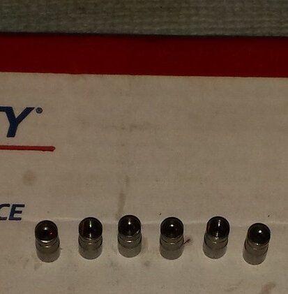

These little restrictors (7) are in every 6.7 Rail from 2007.5 to 2018 they play a huge part and I mean HUGE part in why these years have DP problems.... The intake play's another part and OEM TQ plays another...The 2007.5 -18 Rail just sucks. 2019 Cummins change and went back to a cast piece (rail) without the restrictors change the entire intake and eliminated most of Dead pedal issue's.
The question one must ask, If The DP could have been resolved with programing Cummins / Ram would have done that years ago. It required design and Hardware changes and that cost $$$$
When I filled out the info on safecar, the questions were structured in a way that assumes there was an accident. If there weren't any accidents directly related to the issue being reported, I wonder if they ignore it?
Todd, what do they claim is the purpose of a restrictor/orifice in a pressurized rail? Pretty odd.
They (Bosch) claim its to reduce the in pipe hammering (Hydraulic Shock) that the CP3 Produces to increase injector life.
Also remember your Pressure sensor does NOT measure the pressure ,it measures the vibrations created by this shock and translate to PSI and coverts this to Volts, the voltage is sent to the ECM, the ECM controls everything and use inputs form several sensors to make adjustments to fuel Injection events
Those rail Caps/Plugs that Grocery seller promoted create rail Spikes above 40,000.00+PSI Your rail sensor is NOT calibrated to even measure spikes.
