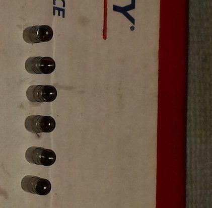

There are seven of these in every 6.7 Rail, 1 for the CP3 to Rail and 6 more form Rail to cross tubes. You simply cannot remove the DP or lag to equal 5.9 status without removing them
