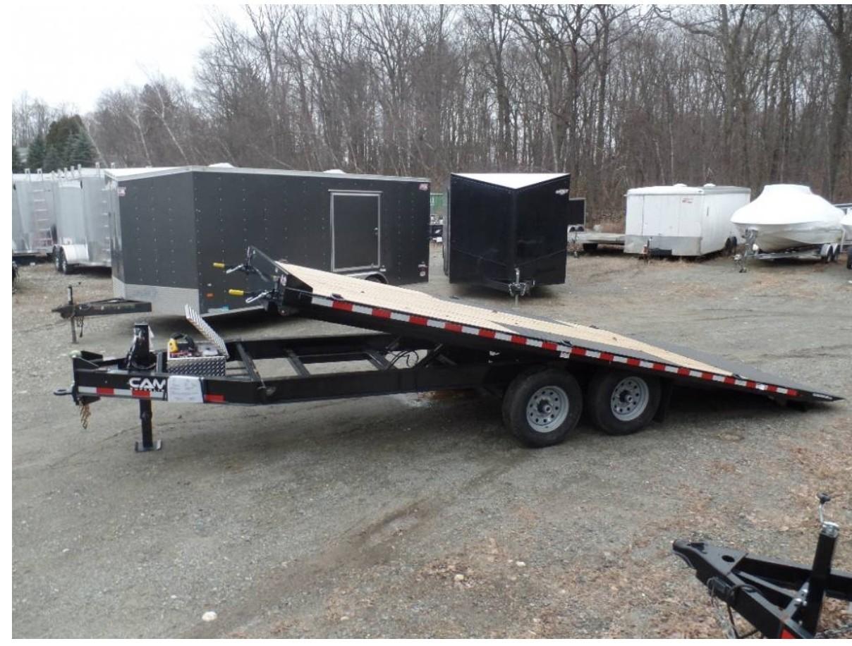

Agree BigPappa, on that you could have issue if the bed tilts before the load is all the way on the tilt and that starts to move. I did think of that, thanks for the advice on the 6" deal will try that.
If in doubt, stop at the front of the tilt and latch it, then drive on the main deck.

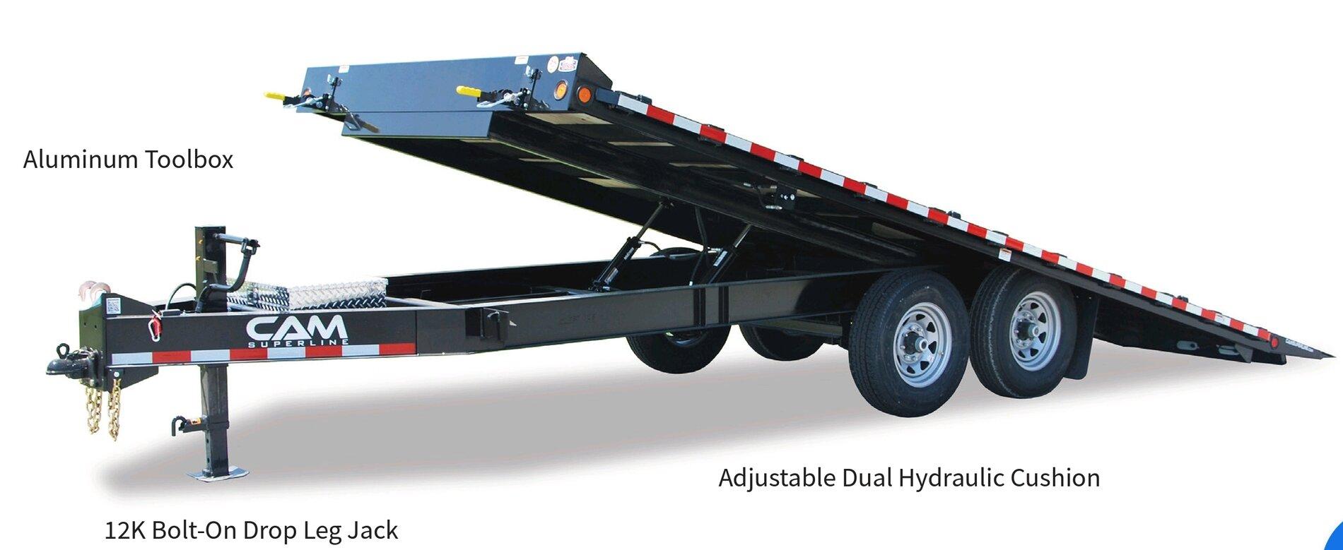

My tilt doesn't have the damping system and I wish it did. 15 years ago only the high end stuff had these systems, I don't remember any actually having power hydraulic but maybe I just don't remember.
Pulling vehicles on and off aren't such a problem but some equipment can be tricky to pull up without really slamming down. Especially older stuff with half wore out clutches, as in everything I own :)

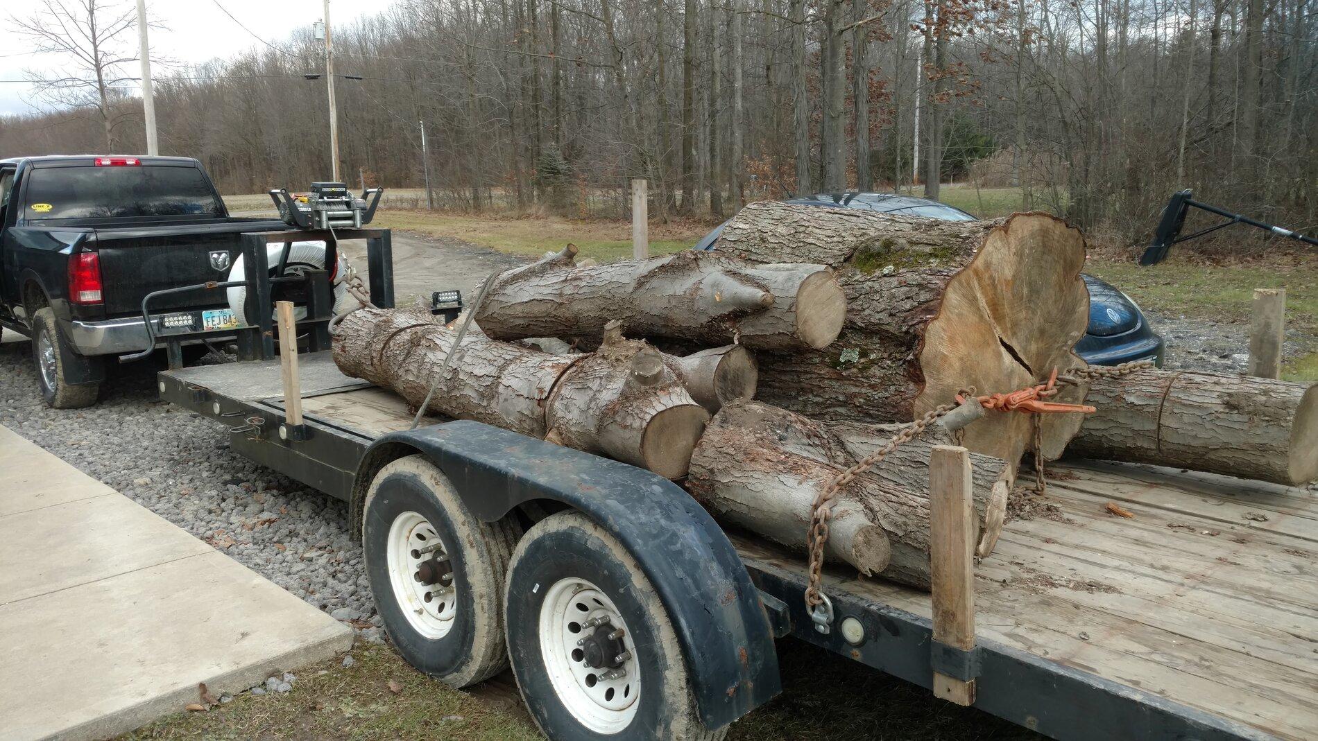

The damping system would be great for this. Also for dragging logs onto my trailer like I do for firewood. With my set up I have to drag each log up just shy of the tipping point then go after the next. When I've got all the logs that I'm going to load I have to rehook to each log, usually the largest, and start dragging them up one by one until they are loading the trailer proper. I would think the damping system you could close the valve, drag the logs up where you need them, slowly crack the valve to drop the deck throw your chains on and be done.
Some monsters there. Lots of work to process that size stuff. But keeps the family warm for sure.
