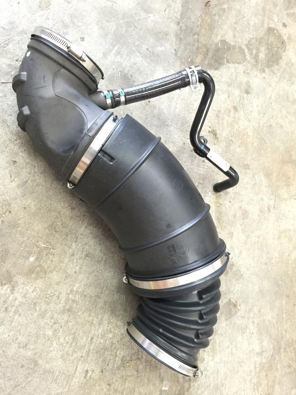

I decide to not remove the steel tube and used water pump pliers to remove the spring clamp and lower hose from the bottom end of the steel tube. Next time I will most likely install a screw clamp in its place.

Removal of the steel tube is really easy and the pipe comes off in one pc. But hey everyone needs to be different. :roll eyes:
