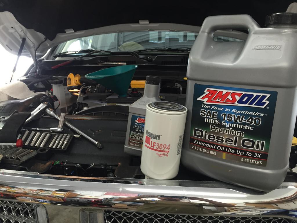

Understand you may have some LF3894 filters from a prior purchase and are using them up. Will you shift to Fleetguard Stratapore 16035 when the time comes?
I don't know since I use big pliers at the top of the filter to remove it. The 16035 has the bottom filter flutes and the 3894 does not. They are the exact same filter and the same price at Genos right now. so I will buy the less expensive one when I run out the the 3894's.
My nylon web strap wrench works well after the first gorilla installed filter finally breaks loose.
SNOKING
Thanks Cummins12V98 for the feedback and good to know. I had seen both on Genos but didn't realize they have the same innards. The indications on Geno's is the 3894's are for an older application.
