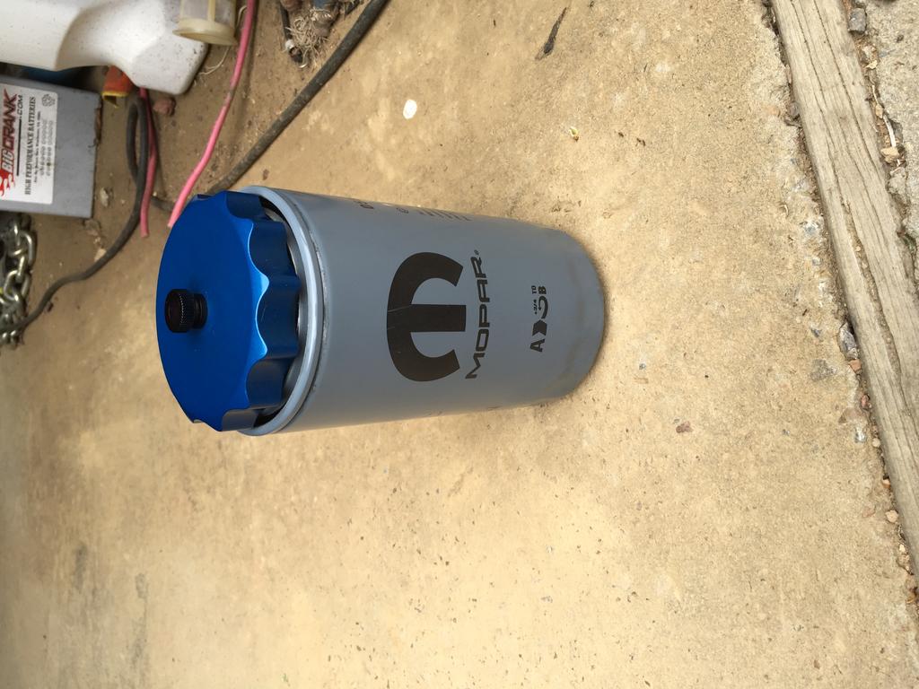

man, you guys with the fender well oil filter change have it a bit nicer. My Ram will NOT fit a filter thru the fender access unless I can get the filter at least an Inch smaller in diameter. it ain't happening. Not a real big deal since going thru the top is still pretty easy. plus I don't have to worry about having the filter partly empty when I go to install it. whatever works for you, do it.

I just changed mine for the first time...what a PITA that was #@$%! For a while there I wasn't sure if I was going to be able to get the oil filter off. I miss my ol' 2nd gen 5.9 in that regard. Oil changes were a breeze

I am curious did you follow the method I described?
Pretty much the same. I did mine from above and took off the intake. The intake gave me some trouble also but got it off close to where you did. By far my biggest slow down was the filter...you have thought they put red lock tite on that thing at the factory.
