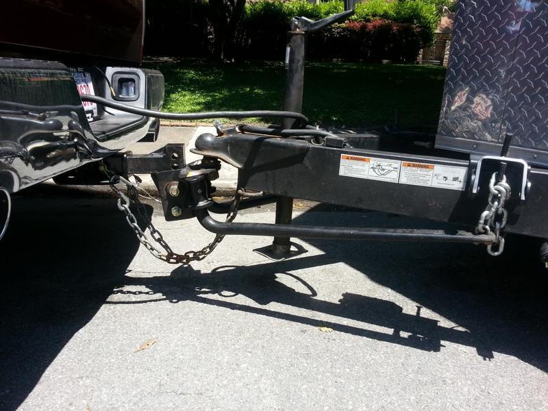

Laramie Crew Cab, 2WD, 1290 capacity per door sticker. 24' enclosed trailer, ~7200lbs. Tongue weight ~800lbs. Conventional spring suspension assisted by Airlift 1000 airbags (rear).

Rear end sag.
Height from fender to wheel, inches.
Unloaded, Rear 12 5/8, Front 10 11/16
Trailer hitched up, Rear 9 5/16, Front 11 9/16
Put 40psi in airbags, trailer still on Rear 11 1/2, Front 10 5/8
Took trailer off, 40psi, Rear 12 7/8, Front 10 3/4
Trailer back on, hitch "tilted" forward 2", weight distro bars on, Rear 11 5/8, Front 10 7/8

I'm working on moving the hitch ball 2" closer to the reciever. This shortens the lever arm the trailer has to move the truck around. This is significant both for truck F/R weighting also for sway. Moving the ball 2" closer means moving the hitch 2" deeper into the hitch receiver. This requires drilling a 5/8" hole in the solid steel hitch for the hitch receiver pin. I spent a bunch of time on this today but all I did was learn that Harbor Freight drill bits are only fine until you come up against solid steel. I got about halfway thru before my drill bit was useless so I'll have to buy some better drill bits and work on that later in the week.
Lessons learned
-800lbs drops rear end 3+ inches and raises front almost an inch. That's a lot.
-40psi airbags changed droop significantly. Rear goes up almost 2". Front down about an inch.
-With no trailer, 40psi airbags don't change ride height much.
-Moving the hitch forward (towards truck) 2" and putting on weight distro bars pretty darn tight changed ride height by only ~1/8". Therefore weight distro bars don't effectively counter rear sag. Note tho that weight distro bars shift do more weight when the rig porpoises so they still fight that pretty well.

Looking at your pictures your hitch setup is wrong. You need to tilt the head back more, the bars shouldn't be against the trailer frame like that. The bars need to be under the frame rails. Just my 2 cents.

And looking at your hitch set up, the ball needs to be angled back toward the trailer. There should be an adjustment bolt or shims on the back side of the head between the bar mounts (just below the ball).

I hadn't looked at the pictures. The post above is correct. The head needs to be flat, to tilted slightly rearward so you can properly tension the bars. I like to have about 6 links between the bar and the bracket.

You don't want to be that extreme of course but you should be able to get 1.5 to 2 inches of the rear sag back and the lift on the front should settle back so the headlights aren't looking for owls.
I just looked at the photos, wow that hitch head needs adjusted. The ball needs to be aft about 2", so that the bars point down when sitting static and not pointing up.
Looked at your other pictures and the weight distribution set-up is all wrong. The spring bars are not doing anything. Tilt the head down. The bars should have enough tension for a slight arc and you probably wouldn't have needed the air bags.
Lol, a lotta hate on the weight distro bars. I spent a fair amount of Sunday morning fooling with the hitch. The pic was taken at an intermediate step, as I experimented with how to get the ball as close to the truck as possible. The intent was to move the ball up 1" and also to reduce the lever arm that the trailer has to move the truck up/down and left/right. Having never tilted the hitch before, I didn't spot at the time is what has caught your eye, tilting the ball also tilts the WD bars. Ultimately I decided that I could go another hole down on the hitch, and tilt the ball back enough that it didn't mess up the WD bars. I ran out of time tho 'cause I'd promised #1 son that I'd take him to the rifle range.
Tonight I'll drop and straighten the hitch, and also complete the drilling the 5/8" hole that will allow me to put the hitch 2" deeper into the receiver. In between running the kids to and from the soccer field, that is.
I wouldn't be too concerned about moving the hitch head forward to reduce the lever arm. When you get some tension on the bars it will all work for you. As Crispyboy said, you should see a little arch to them.

On the old F-250 I didn't care much about the distance between the ball and the truck's rear axles, but that truck was a lot heavier then this Ram 1500. Also, I figure that shortening the ball-axle distance isn't just about sway, but the shorter lever arm will also have an effect on truck front vs. rear axle rear weight dist. I figure anything I can do to better distribute the weight on this 1/2ton truck is worth considering.
Years ago I towed a 5000lb trailer each month with a BMW X5, a truck with a fairly short wheelbase. One of the things that made the X5 a surprisingly competent lightduty tow vehicle was the short distance between ball and rear axle.
I run an 18" shank on my WDH, with the proper setup on the bars it's not any difference than the 12" shank would be. Be careful bringing the trailer further foreword with the tailgate, the reason I run the extended length is so I can drop the tailgate all the time, regardless of trailer angle.
The little bit you gain from moving the ball foreword is probably causing more issues than it's helping.
