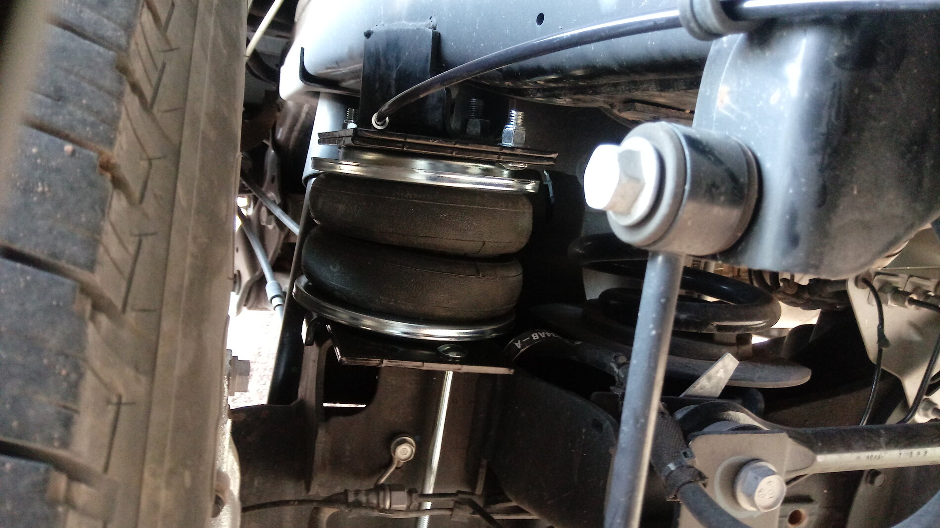

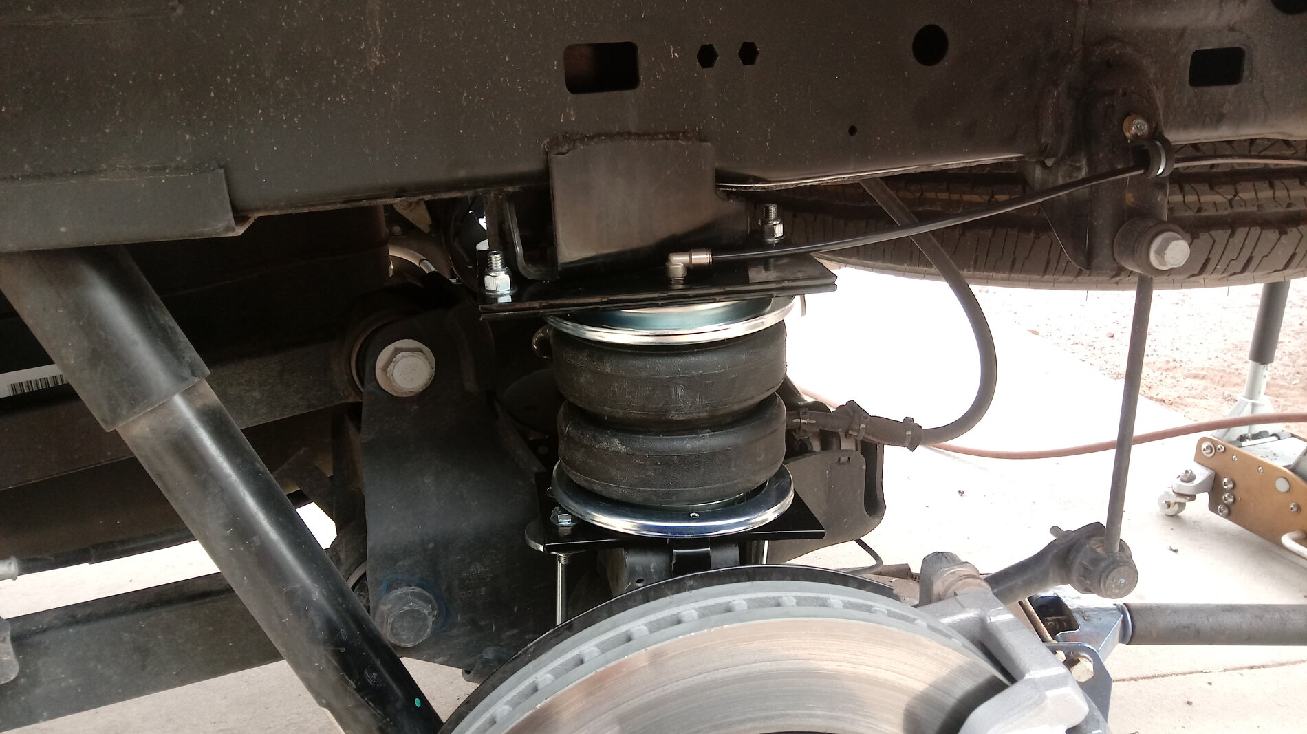

My '21 ram is a 2500, so the coil spring suspension is inboard the frame, not recommended to haul a camper. Because of the inboard suspension, the frame is extra wide so that really helps. However, if you add air bags (I did) under/outboard the frame, I think it would haul a camper just fine. A plus is, the shocks are also wide spaced, close to the tire and both mounted to the front, I like that. It also has the rear sway bar and track bar. The rear is rock solid.
A sway bar is for sure needed on the rear, with a top heavy load. Pretty sure a camper special option will always have one. My Ford dually doesn't have one. With a heavy gooseneck pin weight, it is not needed. But, if you haul even 6k of pallets of wood pellets, it will scare you to death.
Note the wide shock spacing, frame and air bags. Really close to the tire.
