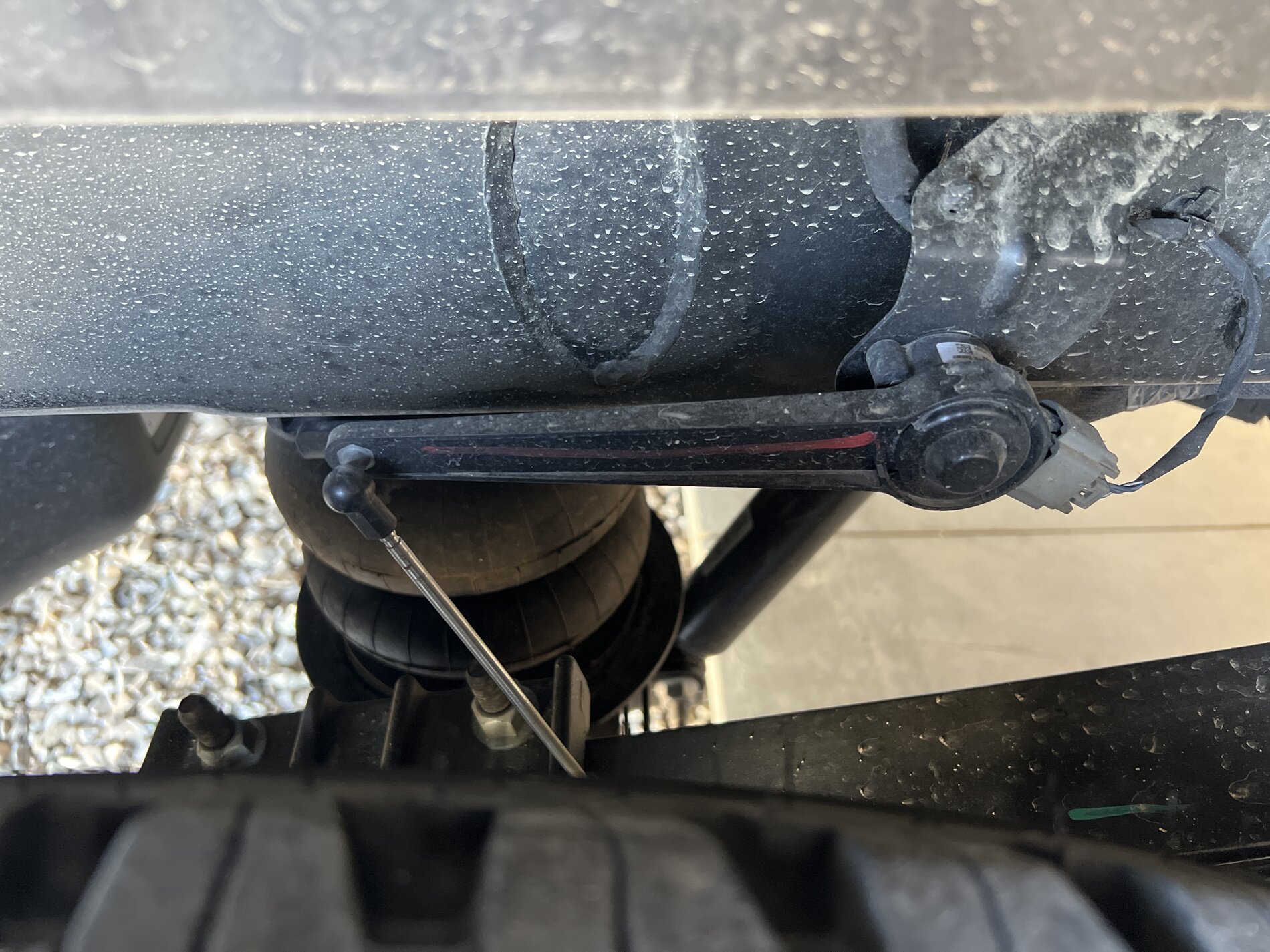

So I’m a bit confused how auto level works . Must have a pro portioning arm or valve that senses the weight and pumps up the air bags. And let’s air off when empty. The first time I ever loaded the camper last late fall and hauled it home from my builder after some work I unloaded it in the driveway I could hear the pump running or at least a noise when the weigh came off. This time after being on the truck for four months I didn’t hear anything loading it or unloading it last week .And the trailer load switch on the dash makes no sense to me at all . I supposedly makes the rear of the truck go up or down about a 1.5 for trailer loading. I don’t see this happening on mine when I hit the switch
In Anchorage your in and out of four wheel drive a lot . Sometimes the main roads are dry and clear. Side roads icey and snow packed etc. John’s right a automatic four wheel drive might be nice in these trucks. My wife’s Lexus just takes control of all that for her. Traffic lights become very icey from the moisture drip out of exhaust and the heat of the cars etc. you need to be in 4w high to take off then the road could be dry. Over and over.
Directly above the axle you see a ride height sensing arm on each side. The truck uses these for setting the proper pressure in the airbags.
In normal ride height you just ride on the two upper, thinner, leaves. This provides a great ride and the truck will add the appropriate air for this height.
When you had adequate payload alternate ride height becomes available. Ram claims ~500lbs but my ‘18 and ‘22 both need closer to 750lbs to enter alternate.
If you have sufficient payload and are parked on level ground press ALT TRAILER HEIGHT and weight. The dash should tell you “lowering” and once complete it should also intcate alternate trailer height. In this mode the suspension drops about 1”, or 1.5” at the trailer hitch” and engages the lower overloads. The lower overloads are massive and really provide great support for weight.

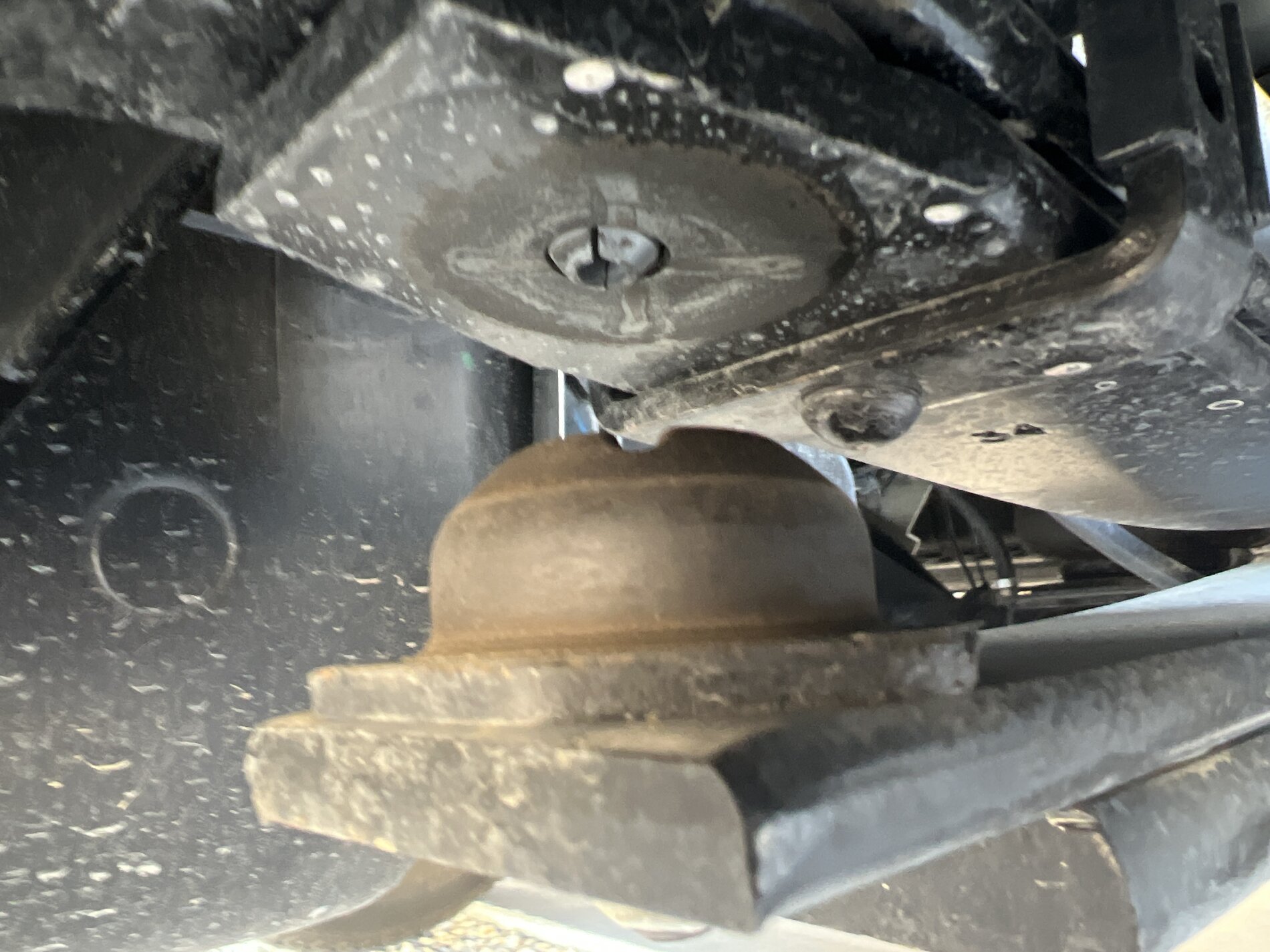

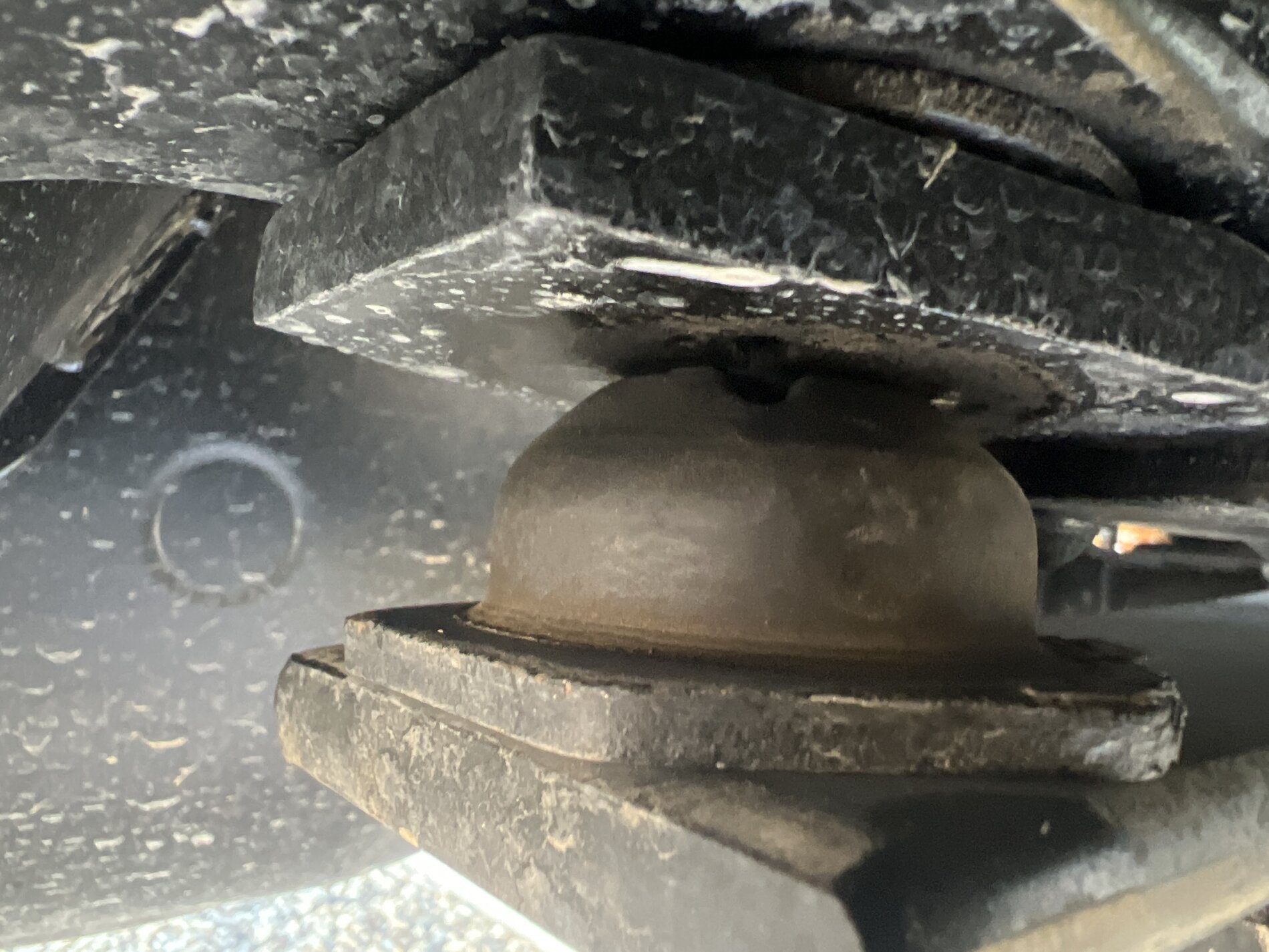

In norm
In ALT
I highly suggest trying ALT out with the camper before buying an anti-away bar.
