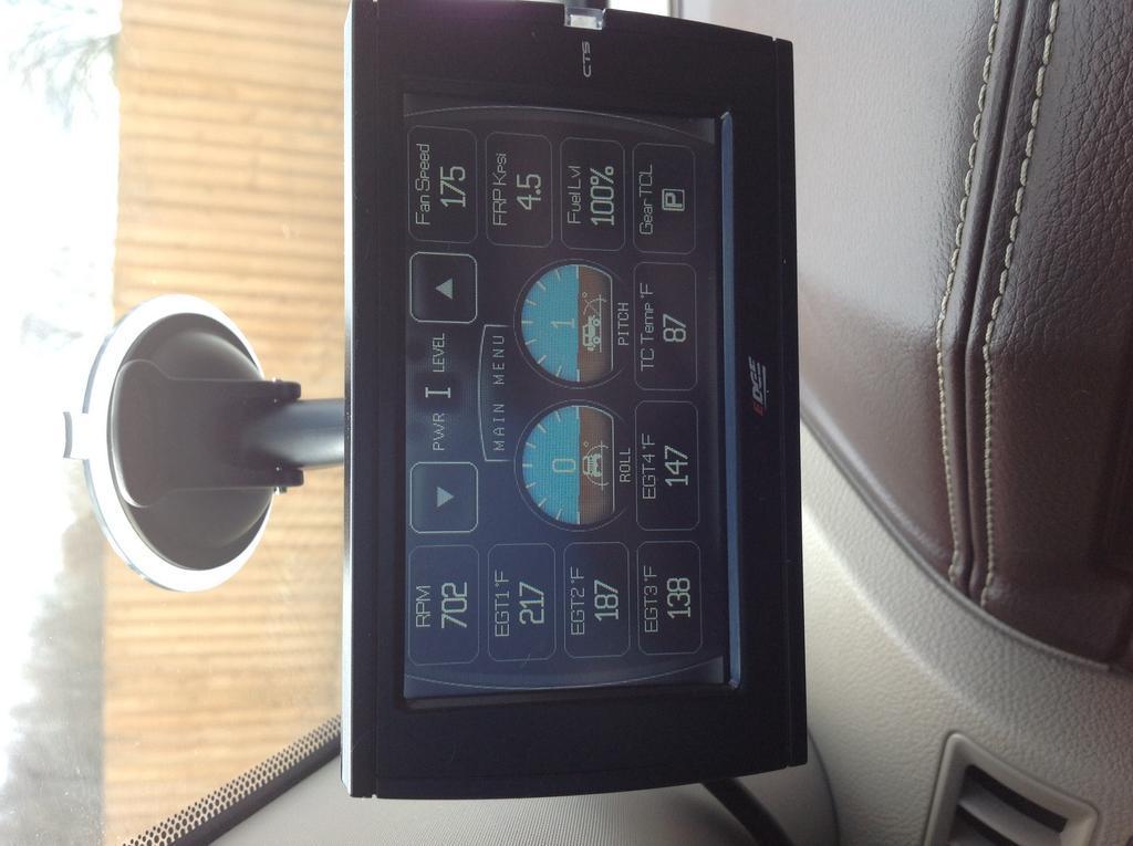

This is mine today. I've changed it up a few time just to see how I like different info. I did see a rise in all EGTs during a regen and try not to shut down during one. It usually goes up to about 1050-1100.
