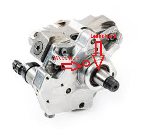

Another possibility the CP3 Shaft seals , the weep hole is to allow fuel to leak out threw this hole and the front casting has a channel to allow the fuel to leak out between the cover and the CP3 manifold. If your dipstick shows your making oil this is most likely the culprit , the weep hole or the channel gets plugged over time and the fuel go's right into the crank case. Most CP3 shaft seals start to leak at around 250-300K miles.
When they completely fail you can blow oil an fuel out the breather by the gallon, Check Google out for oil all over truck / trailer, Owners have drained 5 gallons of oil/fuel out.
If this happen to bluetec motors you will be putting oil into the intake... Not good....
