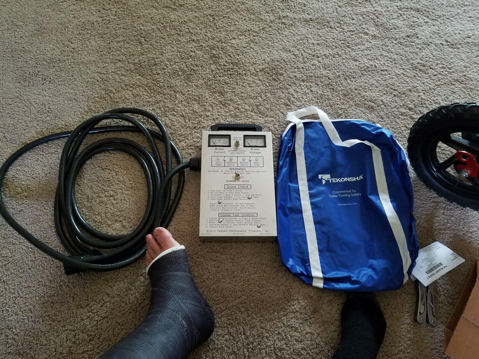

Back to the business at hand, I received my Tekonsha Trailer Monitor today.
I have two 7 pin trailer connectors on my truck, so I can actually read data with trailer connected. I dont believe I can read current in parallel. but I think I can read voltage. Been forever since Air Force electronics training, so some of you bigtime techs feel free to chime in to help good ole Ron out here.
We have quite an opportunity here to create more data to help the TDR community out with ITBCM issues and understanding.
I readily a await your sage advice
If this is like the other units I've repaired, it will contain brake magnets inside it. So, keep any credit cards, cassette, reel-to-reel, and 8-track tapes away from it.
Also if you have a pacemaker or defibrillator installed in your body make sure it is compatible with this device. (no joke).
If this is how it is made, I wouldn't connect it AND your trailer using the two plugs on the truck because you now essentially have 2 trailers connected to your truck.

Dan, thanks, see sharing info is paying off already. No electronics in my body, but also good to know. :)
All, Just for everyone's information, I have a 12 volt power supply that I created a trailer connector to test for trailer light and brake testing, I cary my trusty VOM in my door as I use it a lot on the road. I'm going to refine it and carry with me so I can test truck and trailers on the road. Every now and then I run across a fellow RVer who needs help and always happy to oblige. Most of the help I provide in campgrounds is help with the audio/video. Campgrounds are great fun places to meet folks. I digress.:D

Easy enough to see if it using magnets or a big high wattage low resistance resistor. If used and it acts magnetic, magnets but I also bet that because it has 3 axle setting, that's 6 magnets that thing would weigh a small ton. I've sorta found a wire wound resistor that can simulate the magnet load if I wanted to build a dummy load to plug into my tester.
That's where I made mine different, heck had no clue these existed. Mine plugs into TV and then trailer plugs into my box and I'm seeing "rig" voltage and amperage values. Next week I have a chance to try mine on "volunteers" and plan to capture data to help build handbook of recorded data.
If you're bored and wanna get back into Ohms law I think between their video and knowing that EACH magnet is about 3.5 Ohms wired in parallel you can start to calculate the total resistance of the trailer brake circuit and get the old Ohm's law wheel going and created predicted values.
And for those that didn't spend time in class like Ron no, it's not 4 X 3.5 ohms = 14 ohms you'll have to calculate for resistance in parallel.
And agreed, between getting truck controller produces XX and trailer values are XX controller settings are XX and PWM is XX this can be a seriously interesting I've gotta know kinda topic.

Thanks Brother! Destroyed my prosthetic ankle, they couldn't repair or replace it, so now I have a fused ankle. Still grateful to not lose my foot. Now I'm seeing where we can build sheet with truck data, trailer data, build the formulas, calculate what values should be seen against what is actually seen.
