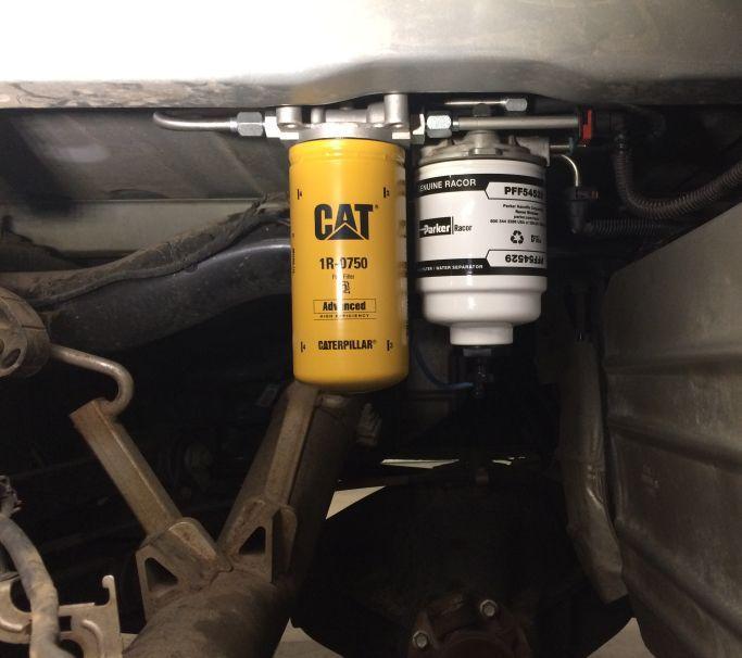

We just put these on some of our work trucks for cheaper changes, better filtration and easier changes. We have run them for years, but have been slowly getting newer trucks to replace the older ones. Good solid setup and filter changes are around $60-70 dollars since you don't have to change the front one up front but every 2-3 years. We have had great luck over the years going 20,000 mile intervals on the Cat filters too. No injector issues in years since running the Cat filters on all of our trucks (14 of them). This picture shows the Racor filter, but we run the Baldwin which is easier to get at the local parts house
Stole picture from there website..

Get them on line for about 90 to 100 for both remember they last for 15000 not 3 or 7 . Taking off the front cap is a real pain. I made sure I torqued it to spec last time I changed the filter and it was still a bear . Last time the dealer did I had to use an impact gun to get it off. The socket you can buy from Genos is a good investment.

I am new to diesels and just purchased a 4th gen 2500.
I understand that the front filter will not be touched and because the CAT filter is better, the front will not need replacement as frequent.
I also understand that this adds the CAT filter as an additional filter near the rear OEM filter.
What happens to the rear OEM filter? I see mention of either a Racor or Baldwin filter. Is the rear OEM replaced altogether with either the Racor or Baldwin?
Racor makes the filter for Ram. Baldwin also makes that filter. It's just 2 other sources for the filter/ water separator. That filter stays with the addition of the Cat setup.

It says right in the first paragraph that "IF you buy the recommended brand of filters you now get better filtration than the 12's and earlier, but the issue now is the cost of the recommended brand of filters to keep you protected". From my research, you can get down to 3 micron if you install the Fleetguard (oem manufacturer) for the front canister, but both filters aren't cheap compared to this setup. These CAT filters are $14-15 and better filtration.
