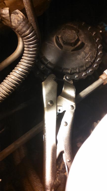

As the starter of this thread, I'm sure everyone will be happy to know I did get the cover off. My thoughts on the great socket debate is the 29mm and the 1 1/8 fit a bit loose but should work fine if the cover is not stuck. I do think a 28mm or 1 1/16 might be the perfect fit. In any case what really did the trick and surprisingly did not damage the cap was a chain vise grip. I cinched it around near the top and pulled. With no slippage, it loosened enough to where my 29mm took it right off. Thanks again for all the replies. It is amazing the amount of useful and entertaining information posted on this forum! :-laf
