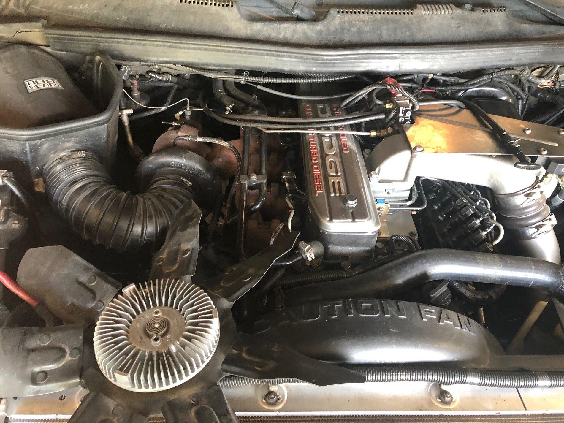

Within an hour of coming home with the borrowed tools from O'Reilly, the fan clutch was off. I used their 36mm wrench with a large box wrench of my own to serve as a cheater bar. I was a bit nervous that the essentially 1/4" bolts holding the pulley might sheer off with the torque of the long wrench but they held. The holder I had made worked well to hold the pulley while I loosened the 36mm nut. The new water pump is in and I'm ready to install the new clutch. I saw a YouTube video that suggested removing the shroud to improve access. It was a squeeze but taking that off did give me more working room.

SUCCESS!

Great info here. Replaced fan clutch yesterday. Once I locked the pulley in place by hooking a tie down strap in one of the pulley holes it was cinch. Friction from the Drive belt was not enough hold it in place. Had to find a tie down strap that had the hook protruding out. Used the Lisle tool mentioned above. And Like others had mentioned here on my 2011 it came off counter clockwise.

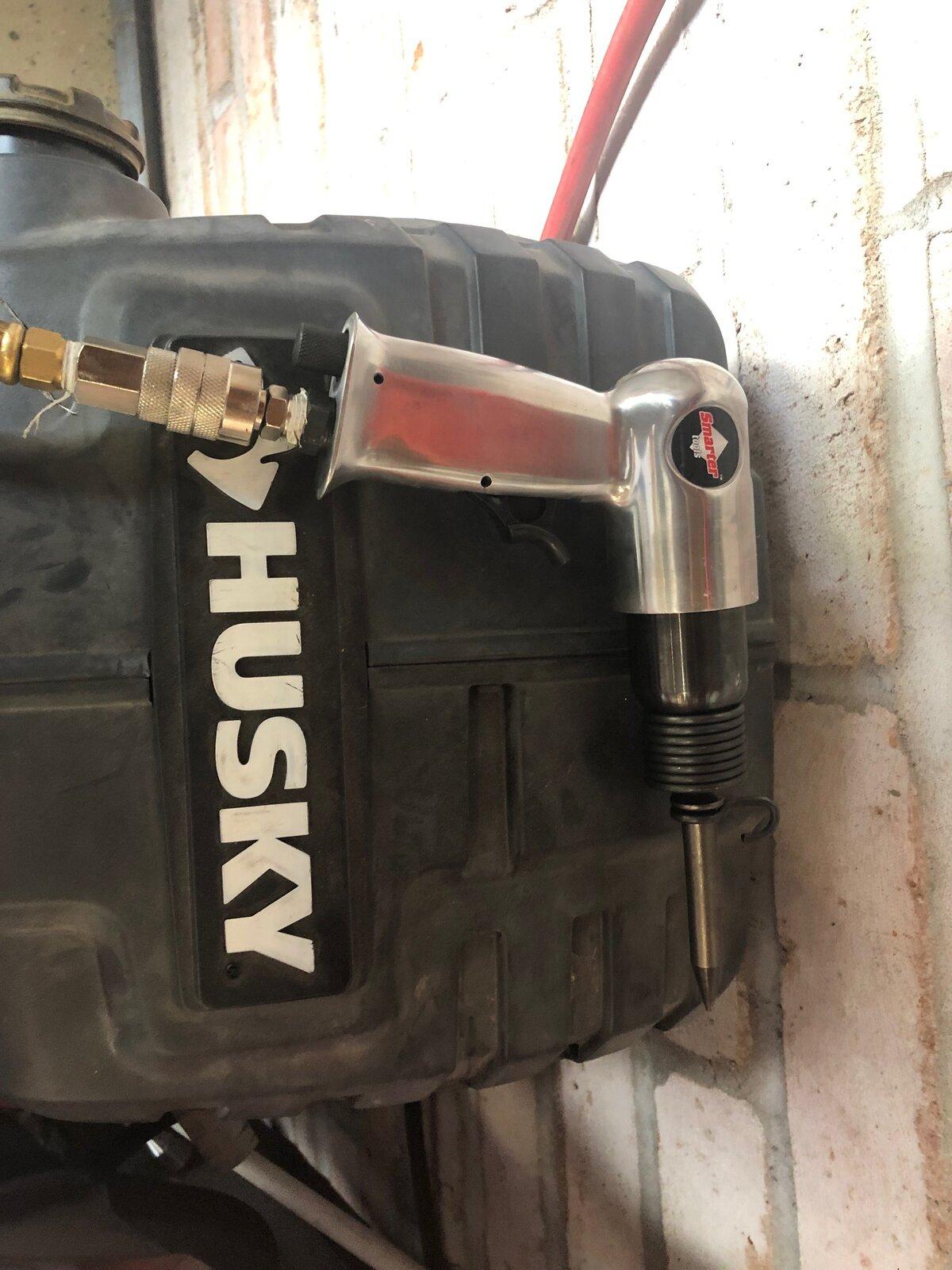

Received the wrench set from Geno's late yesterday. It would be nice if the handles were longer, rather than only . The wrench that goes on the pulley nuts does not want to stay in position either. Not impressed.
Air hammer may be next.

It is little tricky. Air hammer loosened it.
