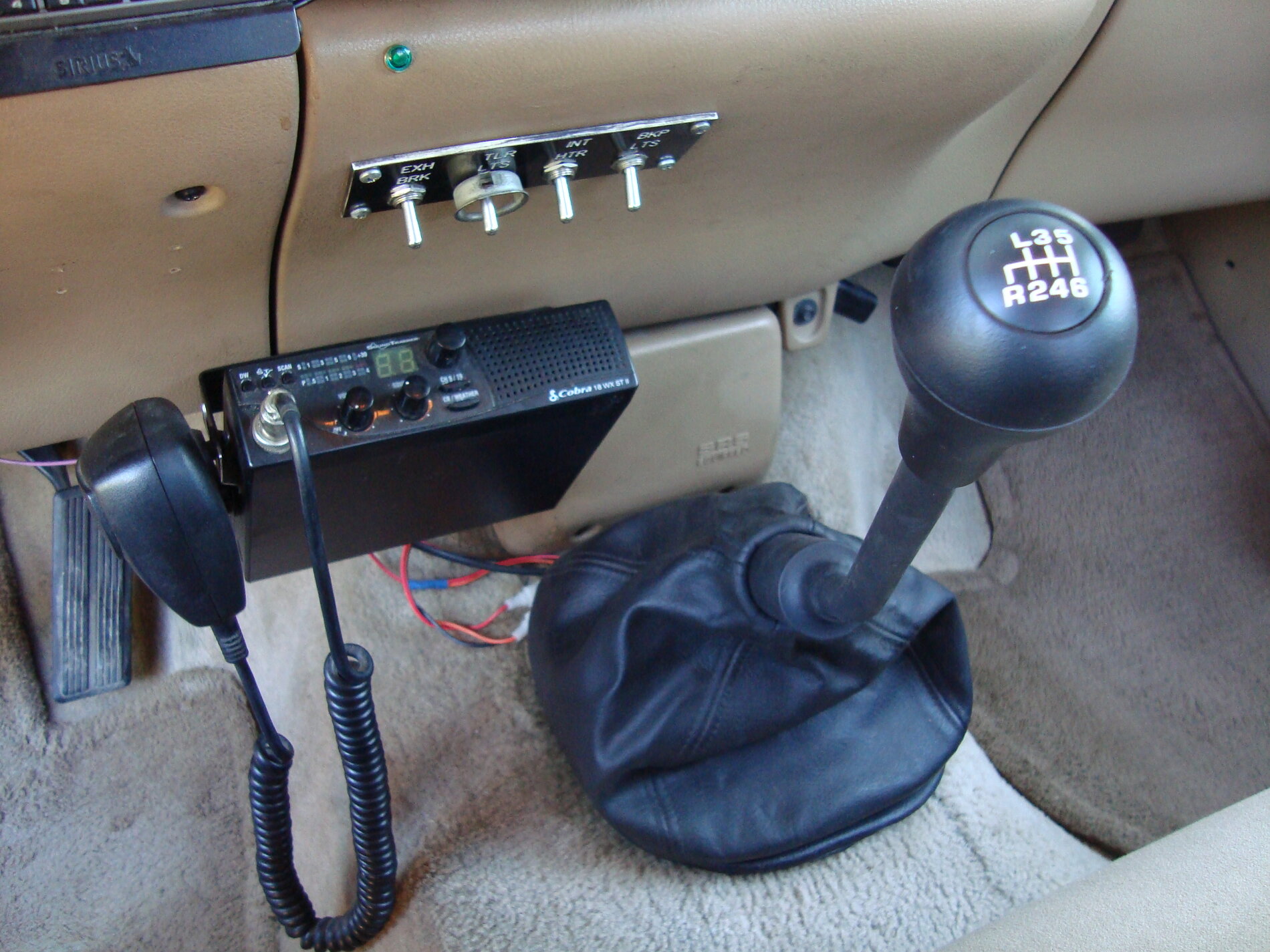

I have a toggle switch panel for my exhaust brake, trailer lights and aux backup lights. A momentary push button wasn't considered.

The momentary switch doesn't have to be push button. I guarantee the manufacturer of you toggle switches offers a momentary toggle switch, too.
I know, but those are a matched set, and not the easiest to switch out.
