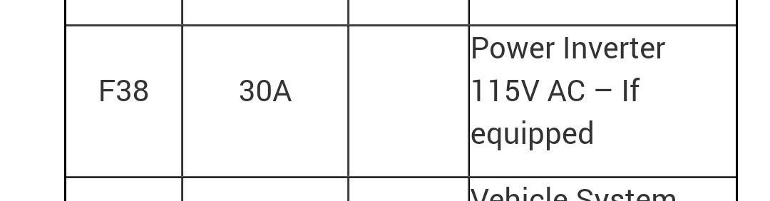

The Power Distribution Center (PDC) is located in the engine compartment near the battery. This center contains cartridge fuses and mini fuses. A description of each fuse and component may be stamped on the inside cover, otherwise the cavity number of each fuse is stamped on the inside cover that corresponds to the following chart.

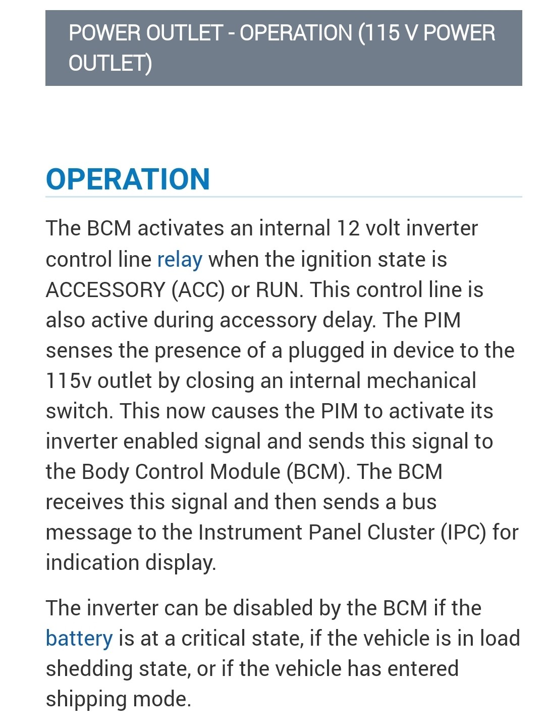

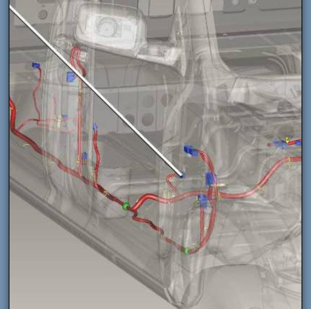

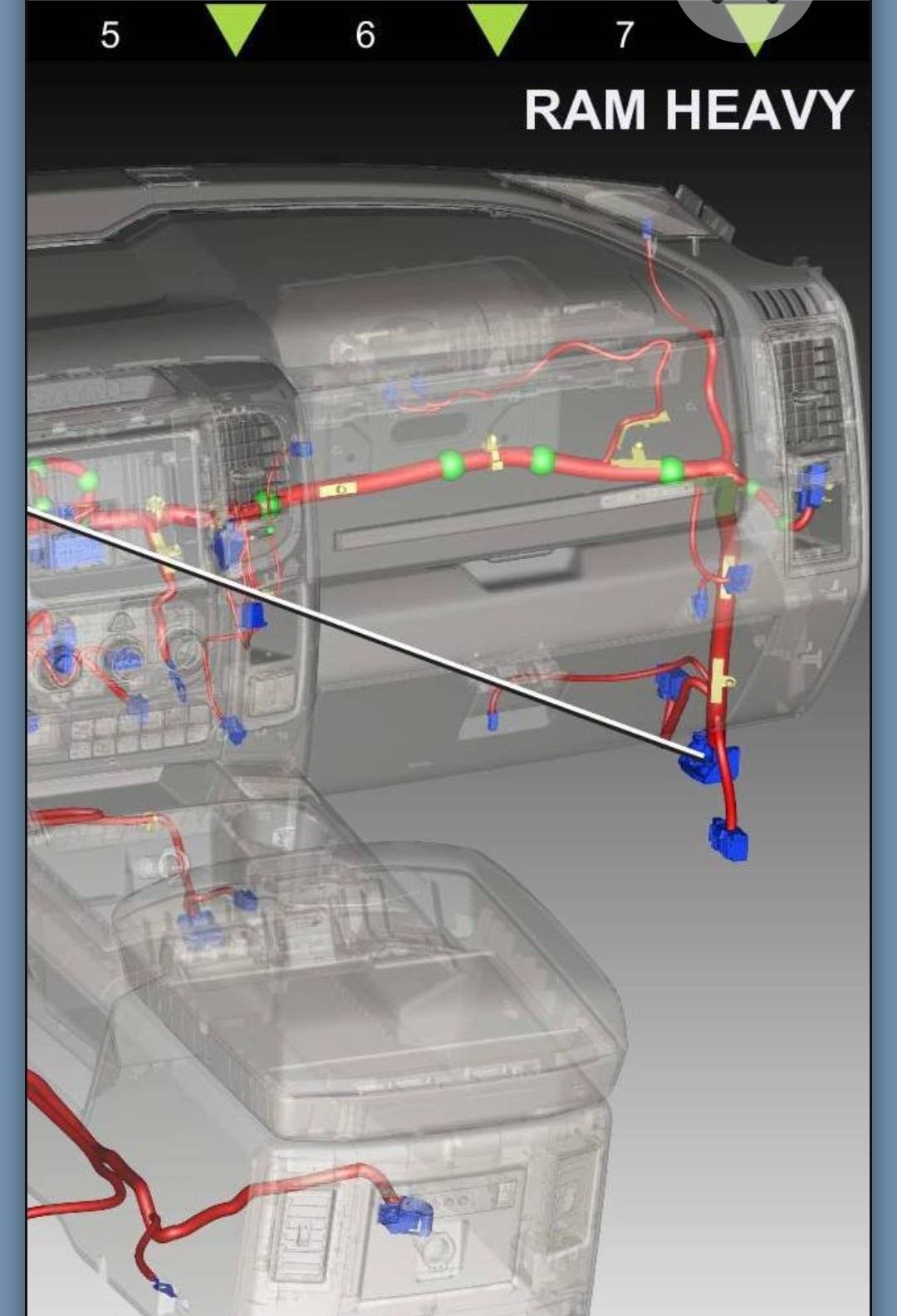

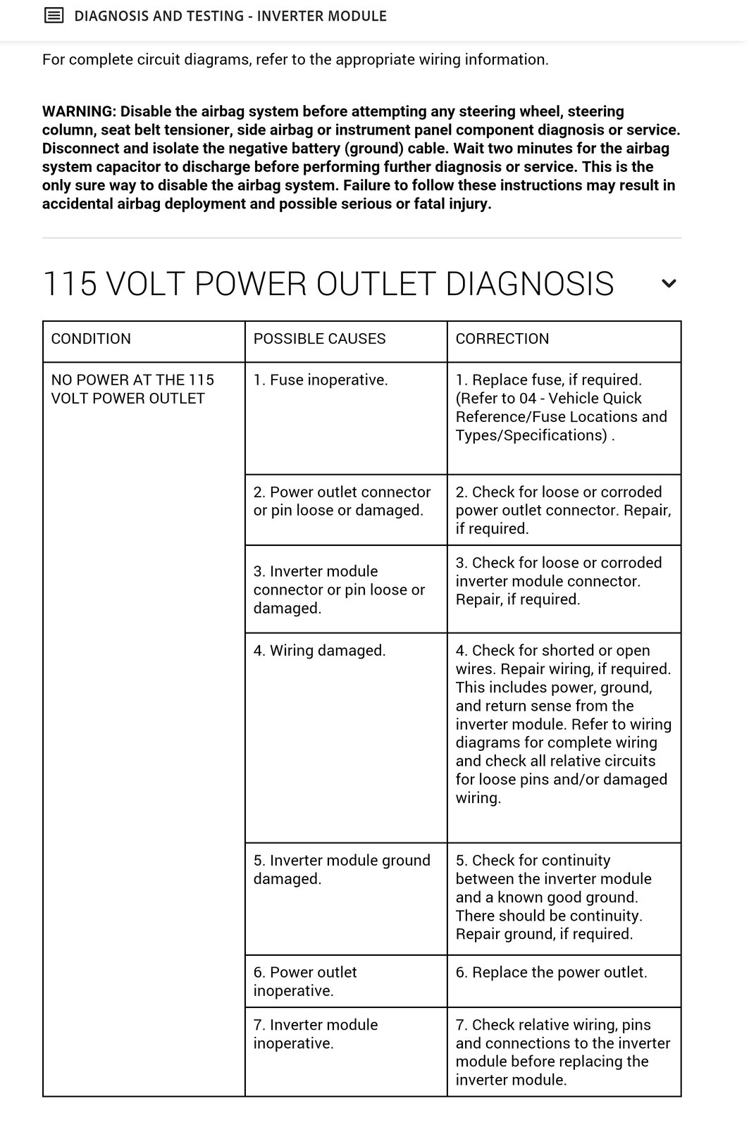

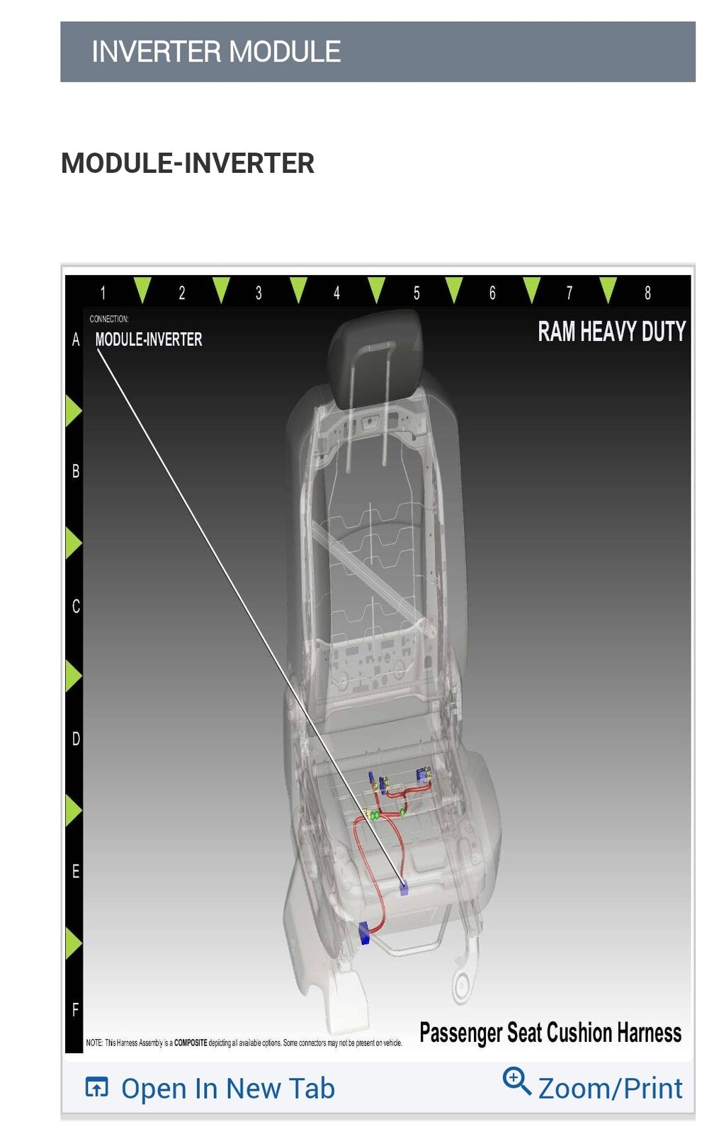

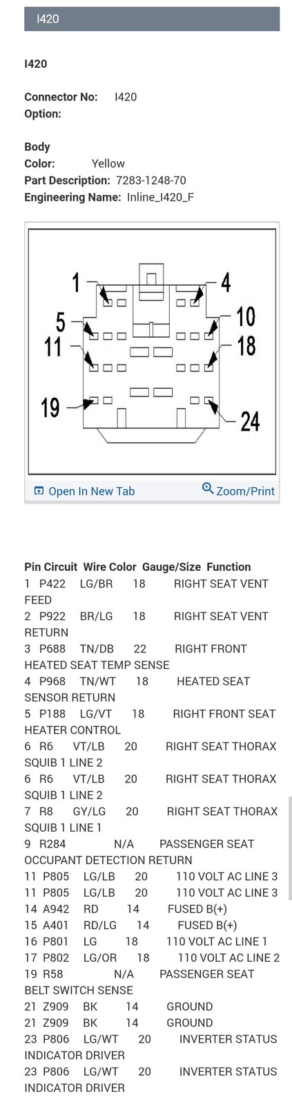

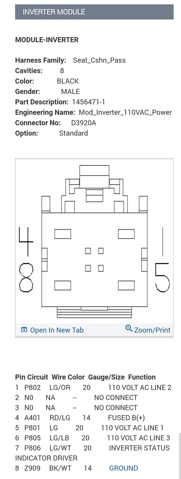

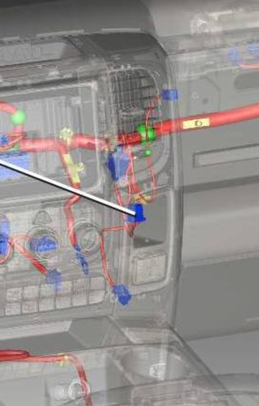

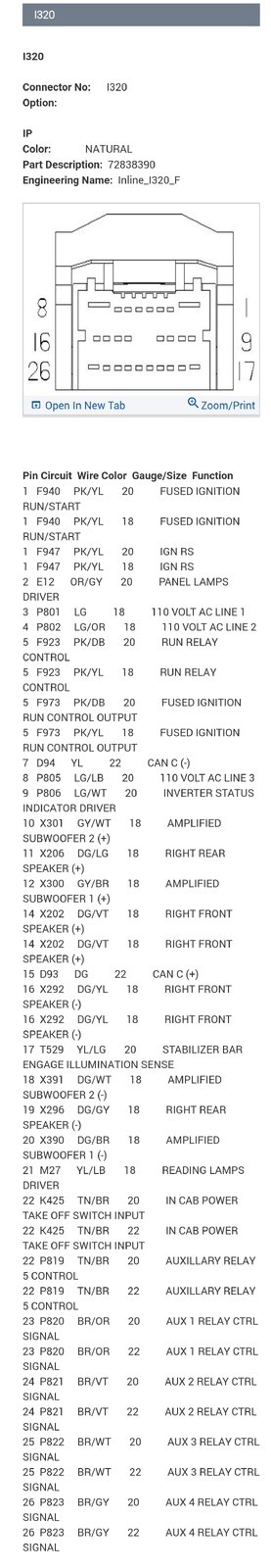

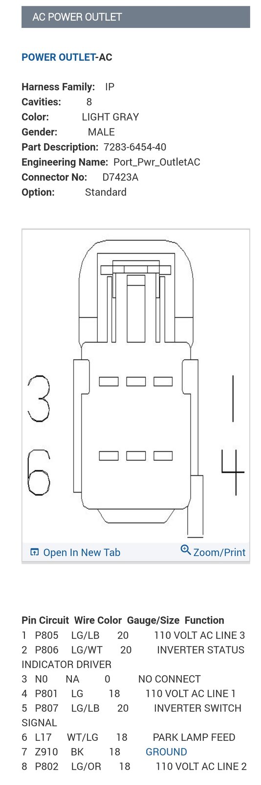

No more pdf uploads it appears, here are some screenshots.
