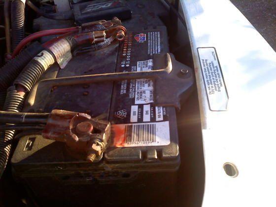

Looks like an intelligent solution Mike, and much better looking than mine would have been, as pressed for time as you were.
My solution was to get dual terminal batteries and wire up the starter to the top post and accessories to the side terminal. I did use an oversize lug on the starter cable so I could add in the starter switch wire with it, on my '96.
On the slug solder terminals, I did have the cross cable on a '06 overheat and detach from the drivers side. So now I still use the solder slugs then crimp them.
we went with crimp connectors and these hummvee battery terminals with double wall adhesive shrink.

For under hood soldering clamp the lug in vice grips and heat it up until the solder is melted in it like a pot of hot metal. Then shove the cable in and wait until you see the solder bond to it.
As for crimping I use my 20 ton shop press and a punch to create a crimp that holds really well.
That is how I did the underhood as well, I took the battery out and used the tray as a workstation.
You will see mentions above in regards to the solder letting go under high heat. That has not happened to me, none of my connections are crimped.
Putting a crimp in after won't hurt, but I did not do it on these.
I am suspecting that a certain solder is required so that is why I went with the Phillips Sta-Dry Solder Slug. They are color coded depending on what gauge wire you are dealing with. In my application I went with the orange ones (Part Number 7-265) which is for 2/0 cable. If your cable is a size smaller it does not matter as any excess solder will simply run out, just push the cable in slowly.

Mike, I'm curious if it's the solder..... I've seen some of these let loose, although I can't say what solder was used to put them in, so... . But those ends were on larger 8. 3, LTA10s, and 855s. But then, knowing the individuals who were operating the machines, who knows how much they were cranked on before the solder gave way... . :cool:
Personally, I use the crimps, as it's hard to solder cables in a lot of the places I have to work, I'm sure you understand. Anway, I've not had any problems using copper terminals on copper wire. I have seen some Aluminum ends on copper wire cause issues due to corrosion.....
