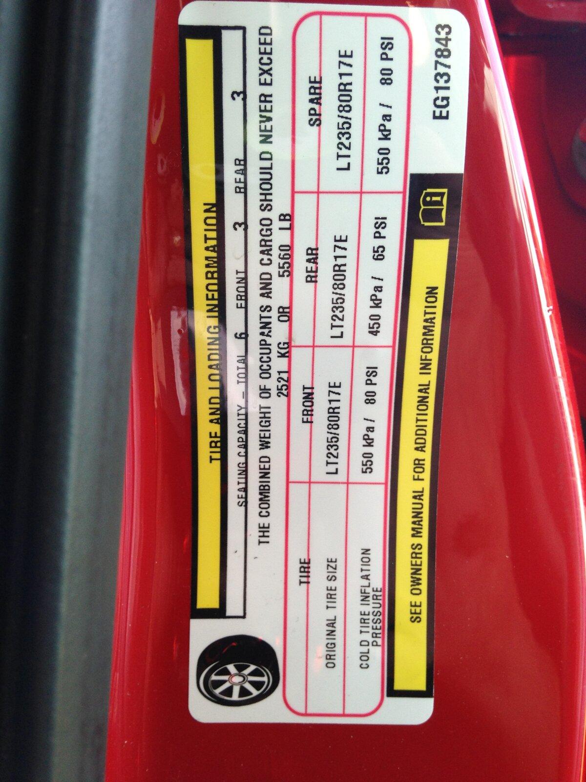

The brochure weight for your truck is 7507.
If you take the GVWR and subtract the payload on your door jam sticker you will get what your exact truck weighs.
I didn't know that. Sticker says 2259, so 7741 w/o driver. My '01, right after I got it, was 7k with me in it. So, 15,120 - 6500 lbs dump trailer, has me at about 8620 with me in it. 10k minus 8620 gives me a 1380 lb payload:eek: No wonder the flimsy sucker is already level, with an empty dump attached:D

FWIW, my 20 3500 CCLB weighed in at 8860 with a full tank and me in it.. so looks to be right around 8600 wet weight. As reference my 04 with the fiberglass cap on it weight 8250. Another interesting figure, Axle weight rating is 6k fr / 7k rear so 13 right... nope, door says 12300.
File photo from my 2014 RAM 3500:
