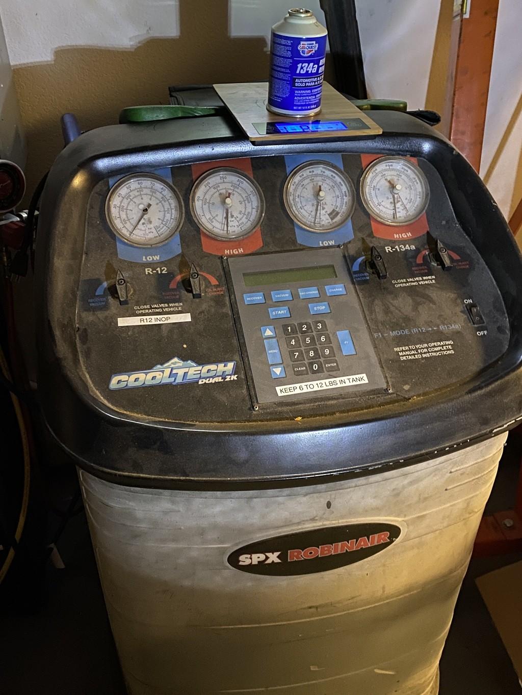

Is your system R134a or did they switch to the new flammable stuff? It would be "self-serv" but I would hook you up if you need to go to Phoenix. You blow by my place on the 87 going toward Phoenix.
