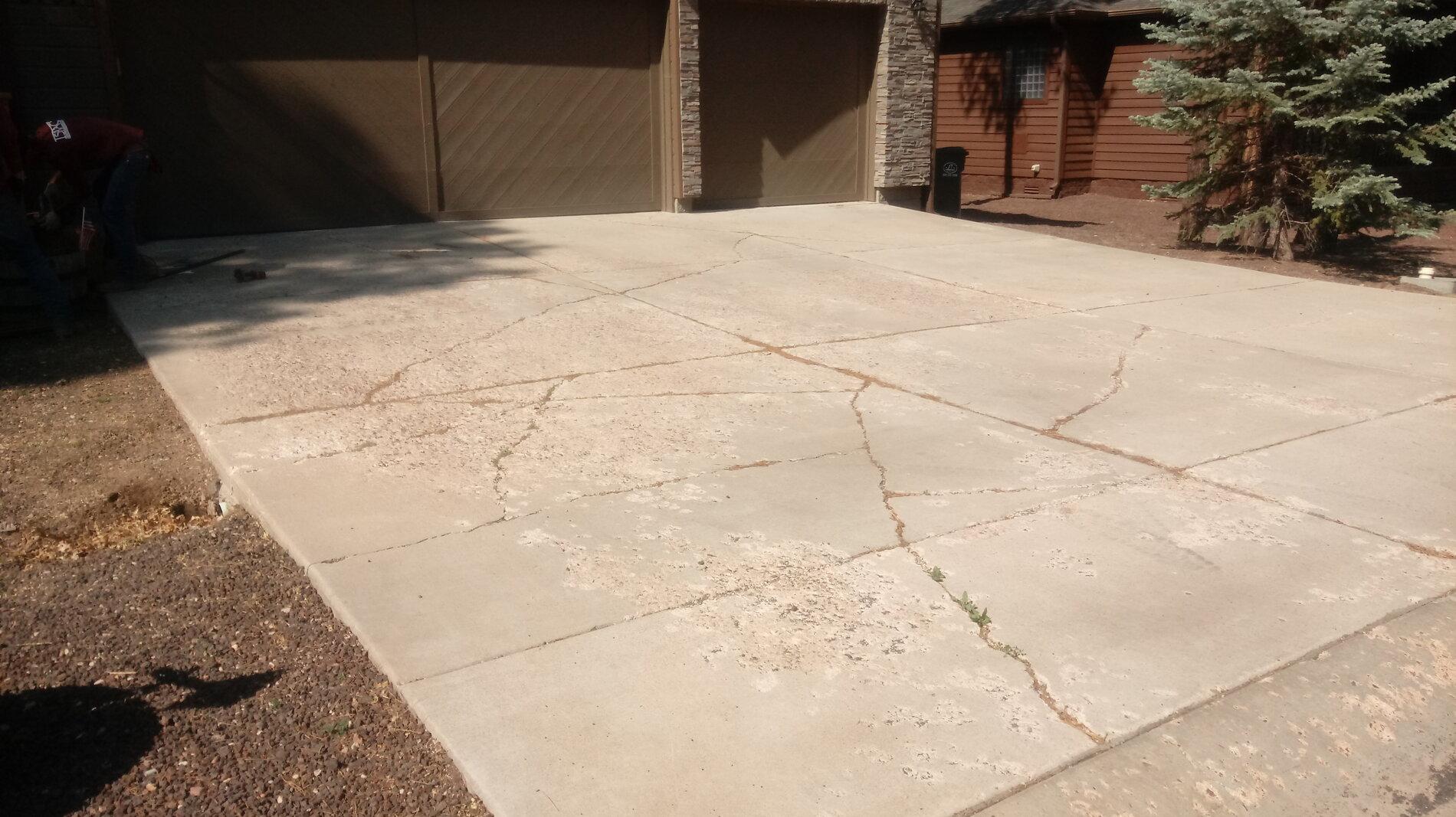

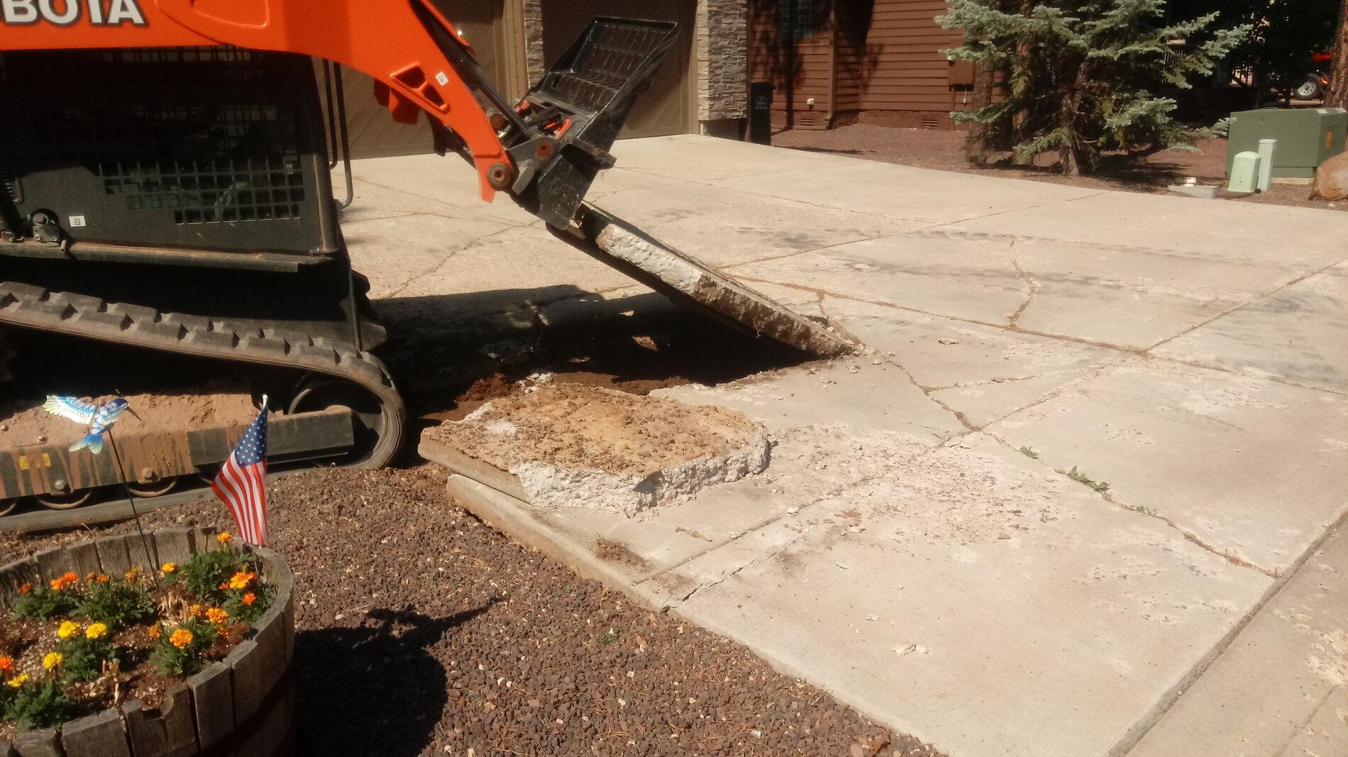

You are correct. I hauled 4 loads of demolition concrete yesterday and had time to mess with the a/c. At 197 operating temp, a/c off, fan on 3/4's, ambient 81 degrees the vents were 91. At 95 ambient, a/c on, 3/4's fan, 197 coolant temp, vents were 52. Both times I was cruising down the highway. The higher the fan speed the better it works.
What do these new trucks weigh? I think I read somewhere my 2500 is 7600 lbs empty but that must be without options. I was at 15,120 with my light dump. My '01 with the same trailer is at 14,300. I have less extra weight in the new v/s the '01.
Loads were 5, 5.2, 7 and 9 ton. The last load we didn't want to split it and make two, so I hauled it:eek: His crew hauled 3 loads with his small dump. Have I said I really like this new truck?:D
