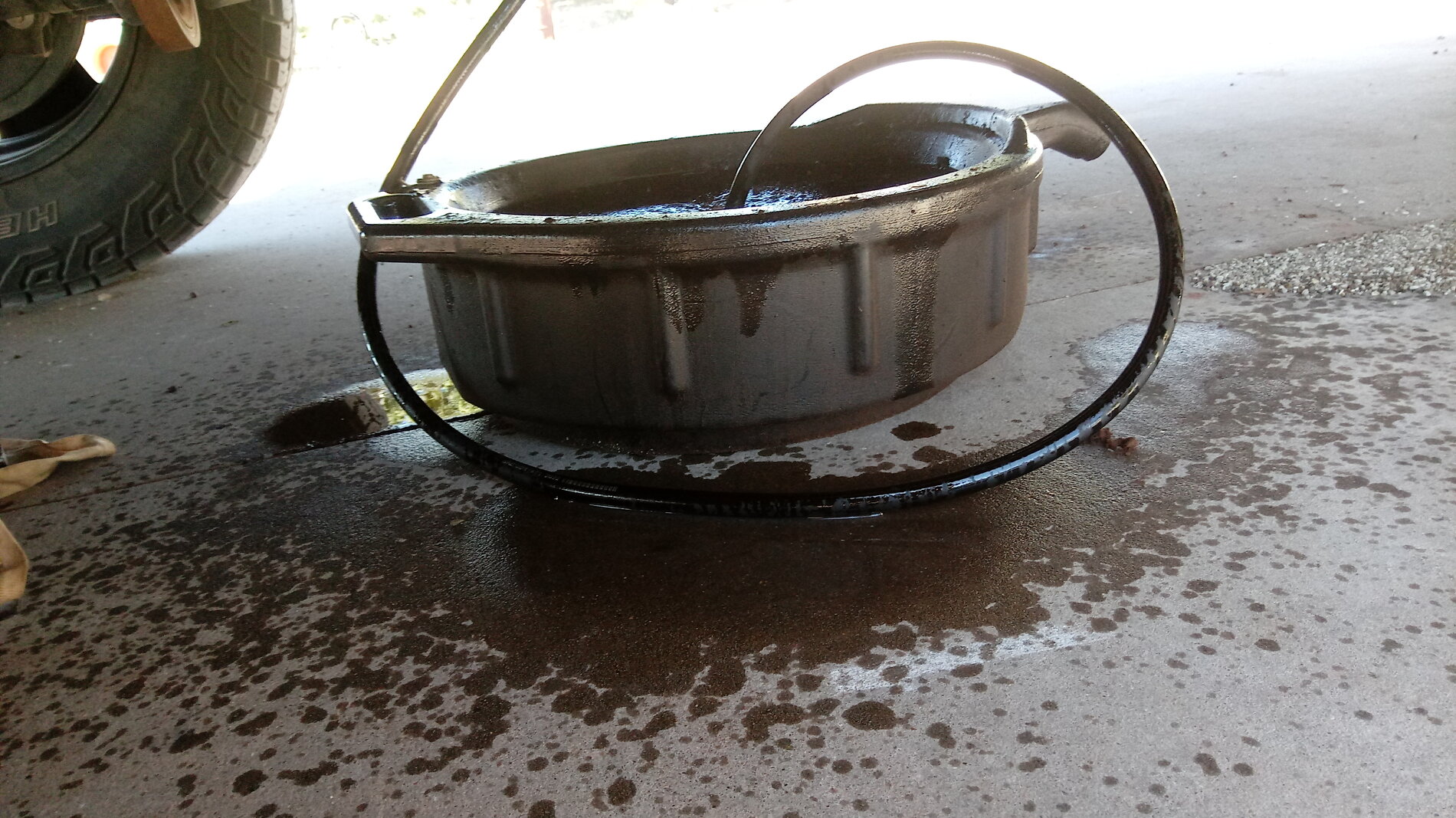

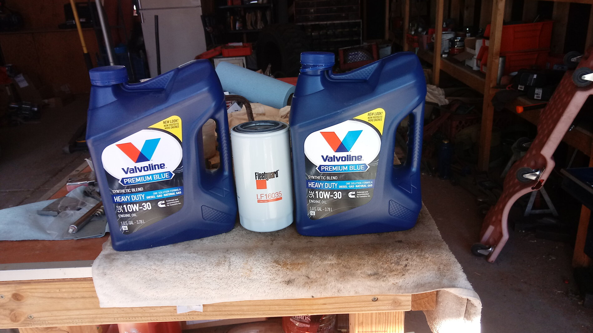

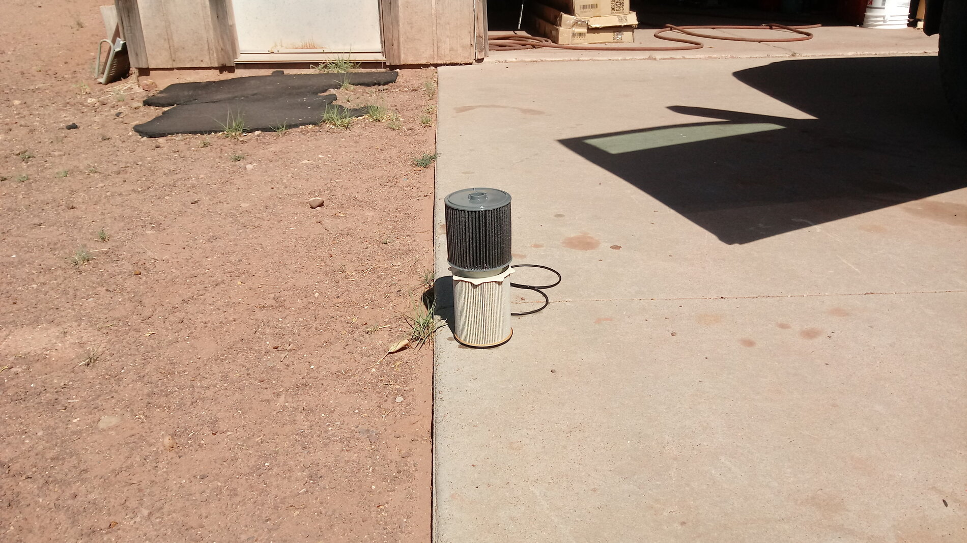

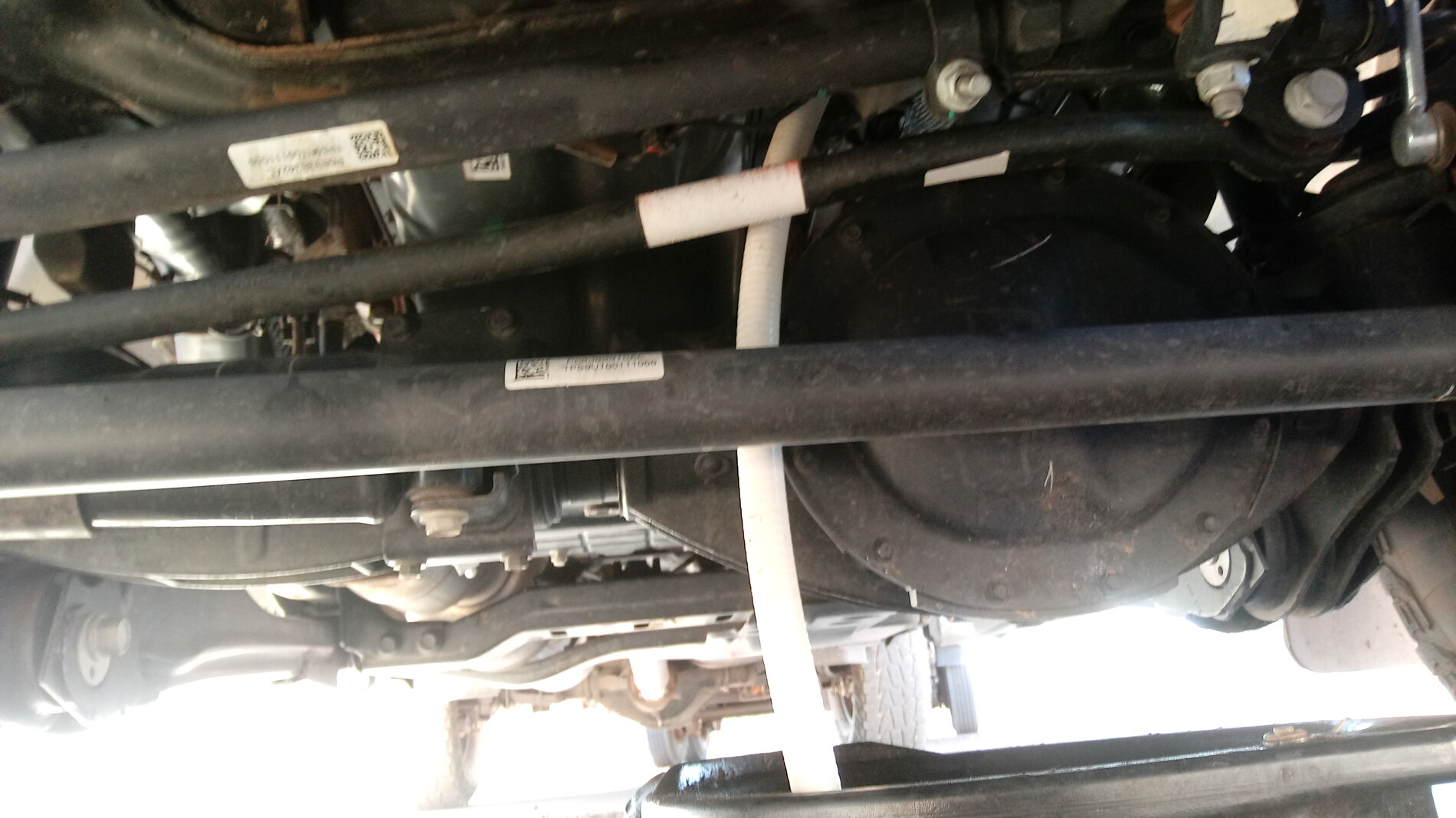

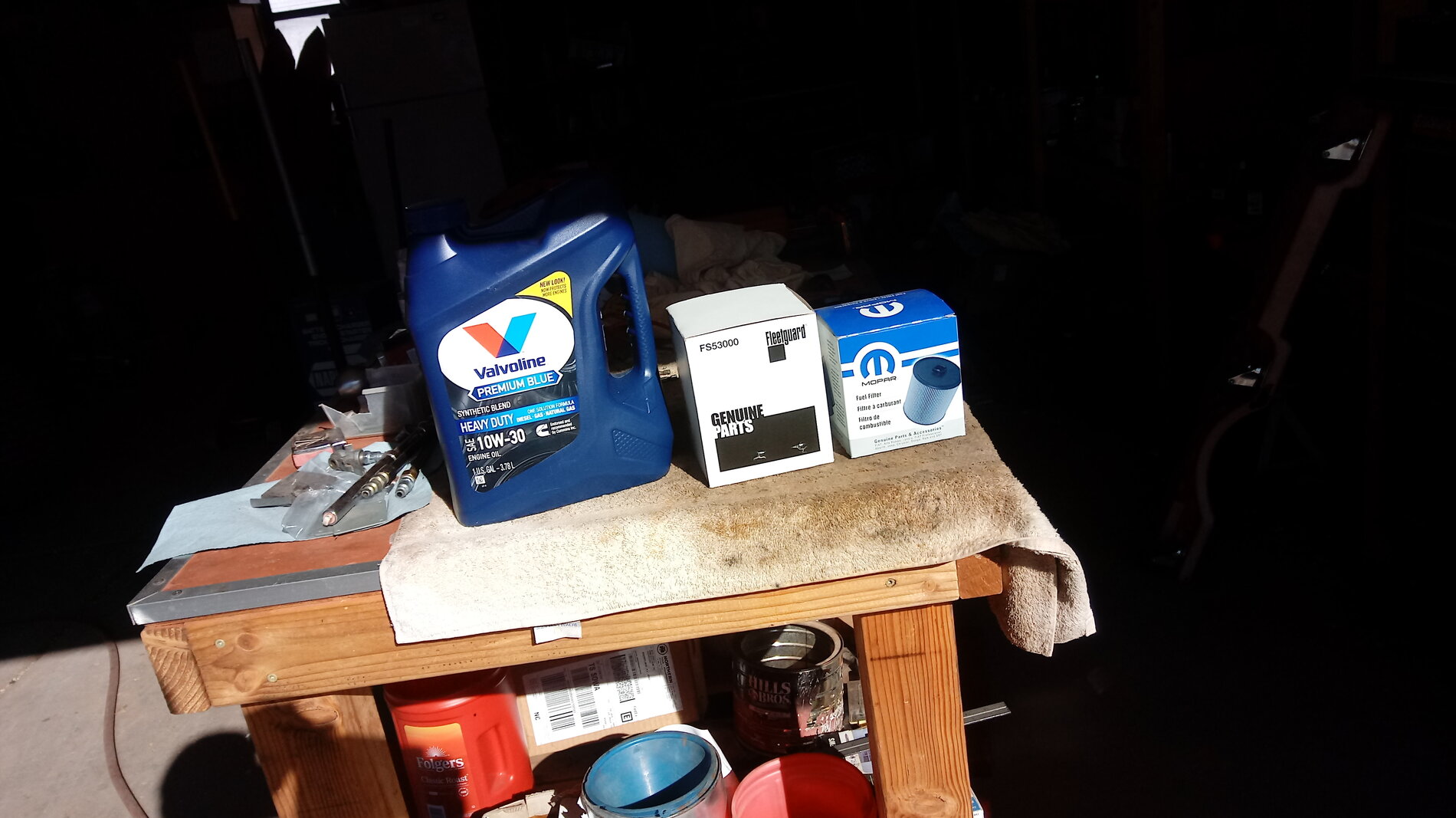

Perfect day today so I did my annual service, exactly one year but only 11754 miles. AH64ID's suggestion was a big help in doing the fuel filter sequence, about 95% better on the mess. The front is easy.
Just for fun I checked the oil temp display v/s my Infared, almost exact. I used the plug in the top of the filter head to aim at. I took it for a short drive and got it up to operating temp then let it idle at the shop. First go was 194 display 193 Infared, after a couple of minutes to stabilize, 185 display, 184 Infared. Interesting.
