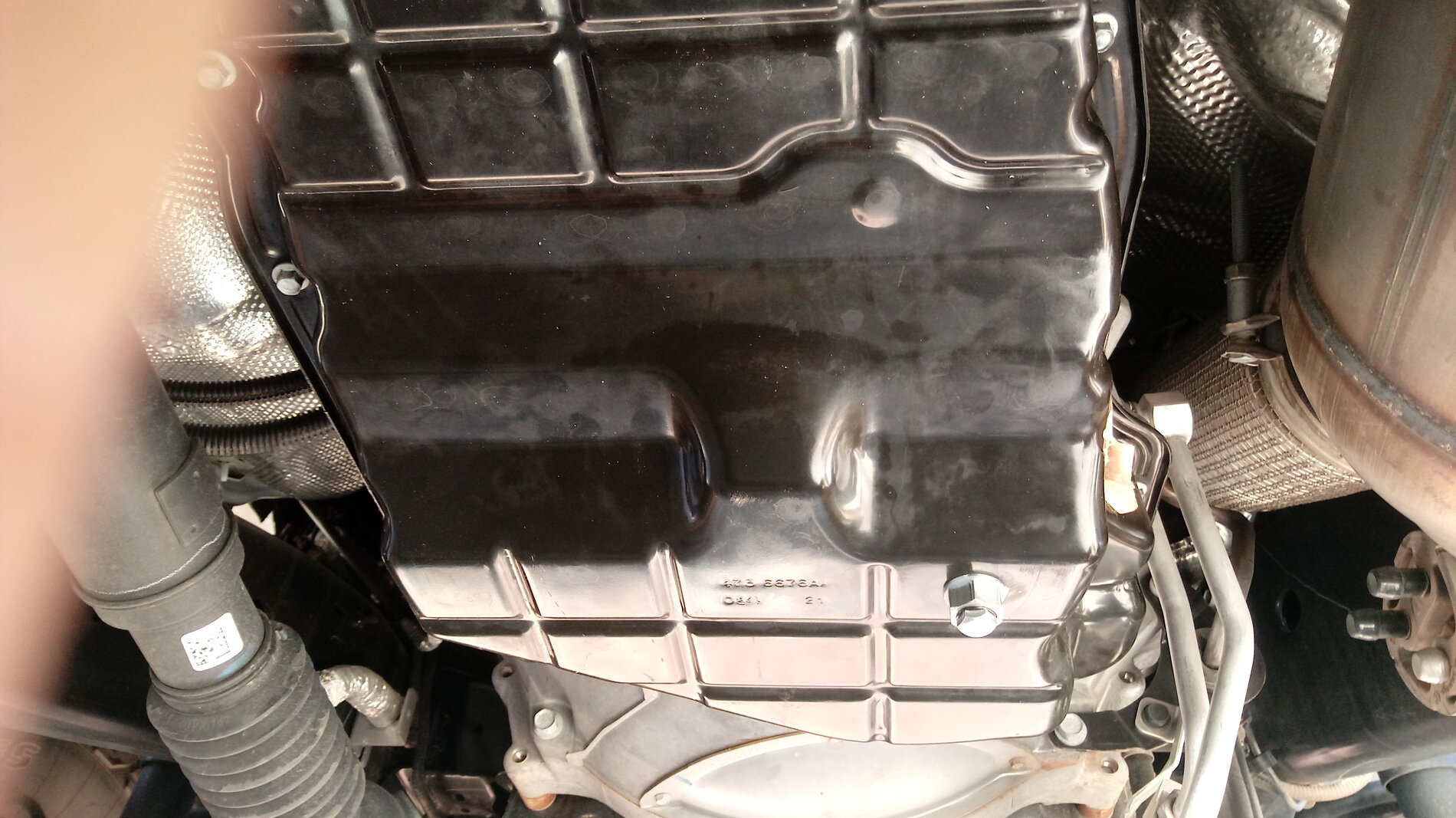

The problem I see with the screw is the thread count - it’s pretty coarse. Just screwing it into the pan doesn’t give much thread contact area. If you used an awl to make the hole, it would push metal up to give more contact area, but I’d be afraid of wearing the hole out with a couple of removals. Myself, I’d still TIG a plug into it, but that’s just me. Not everyone has a TIG welder…
Maybe I should just quit messing around and get one of these pans. Anyone use one, is the quality okay?
https://www.summitracing.com/parts/rnb-265-870
https://www.turbodieselregister.com/threads/rfe-68-service.270433/page-4#post-2677535
@NIsaacs, The hole was just big enough to screw the threads into the pan with a good gskt material on the bottom and no leaks or seeps! Guess it depends on the install. I would like a larger opening and might put in a bung one of these days.

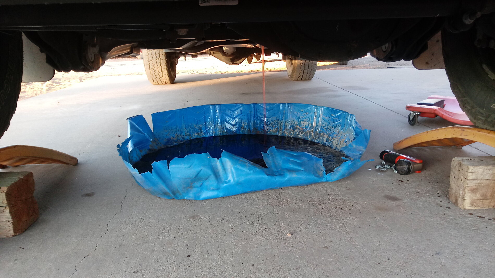

I bought a plastic mortar mixing pan at the local big box store. It is big enough to eliminate problems changing transmission fluids going everywhere.
I ran the MagHytec double deep on my 68RFE in my 11 HO DRW. A t least 50k on the AMZ/OIL when I removed the pan to trade truck. All I did was drain the pan and remove it. I did not pour out the fluid. Impressive for towing 29k combined for over 1/2 the miles.
I've had some B&M plug kits work fine, and others leak. Now, I use them with a Dorman rubber lined steel gasket. I bought this kit and used the one in the top center with the rubber ID. Works perfect.

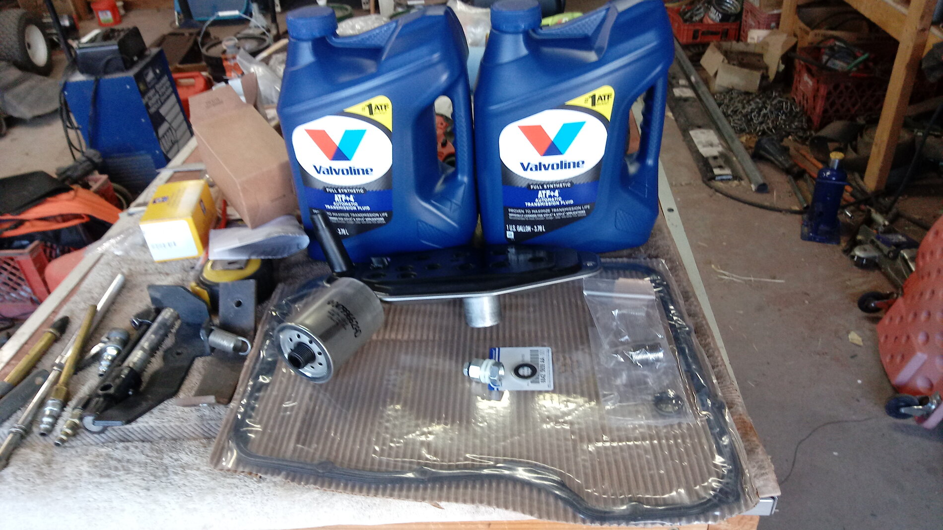

Thank you, I picked up one of those at Napa with the bung. I just changed the fluid, it was due in my opinion, (29k miles). The pan had a reusable gasket so I didn't need this one. I also did not install the steel nipple in the filter. It was super tight so I left the plastic one alone, also reused the pump/pan filter seal. I only got 8 qts of fluid so far, checked in neutral after a few times of drive/reverse. Halfway between cold and hot.

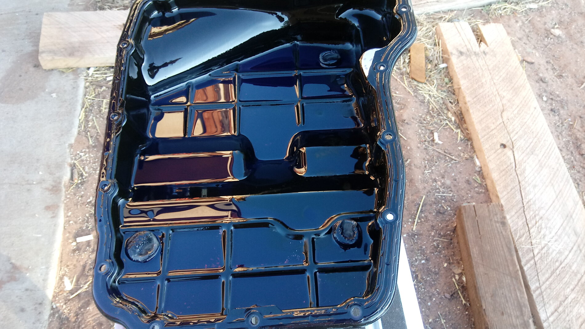

The fluid looked fine but the magnets had about an 1/8" of fuzz on all of them, with a small amount of shinny flecks in the pan.
