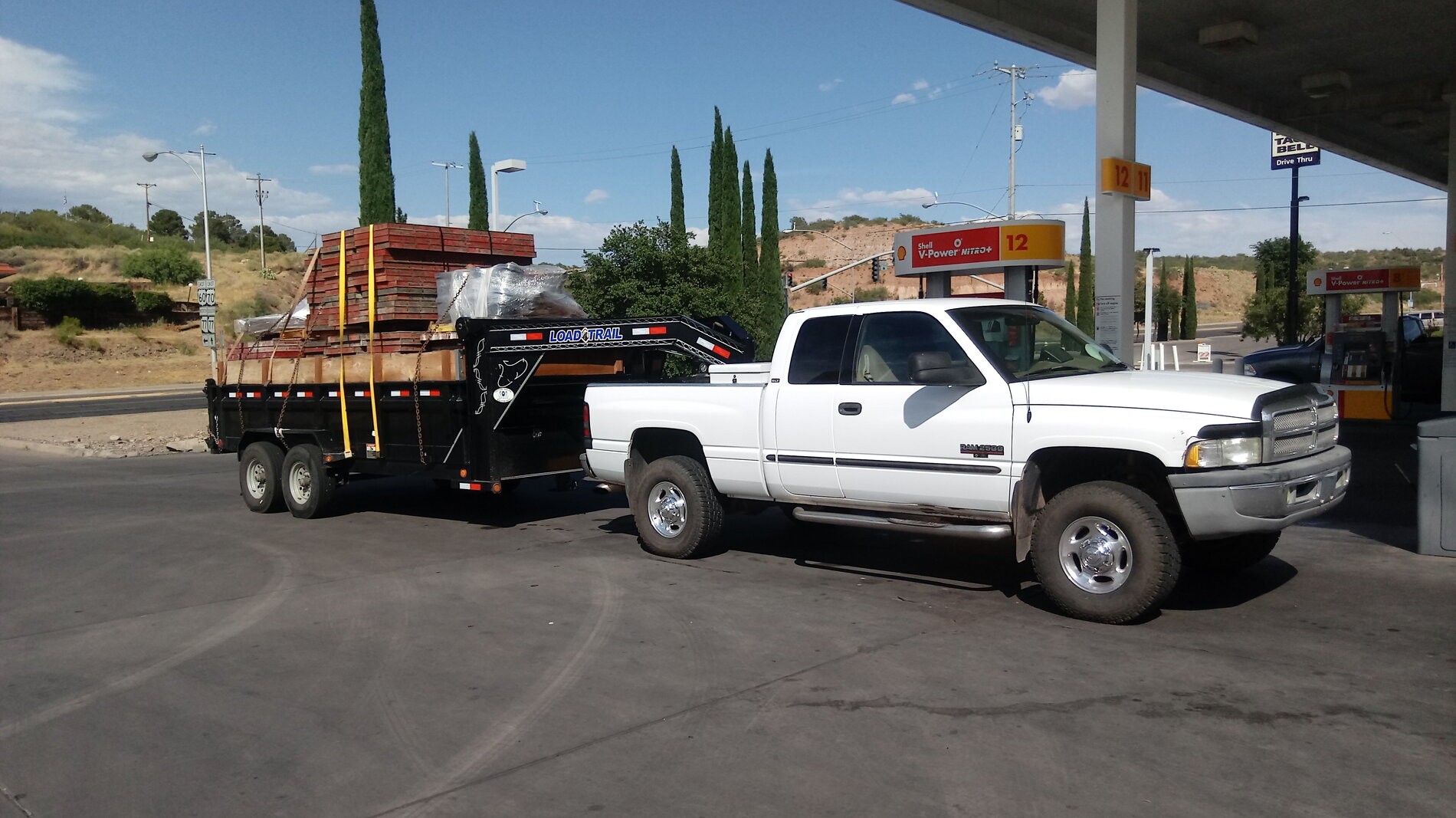

Note the picture above, I have one just like it. PJ 7x16x3 22k. The bed overhang is too much. When you dump it can hit the ground if the ground is soft, or the truck is on a higher plain. Just the weight shift rocks the bed on the suspension and unloads the pin, that brings in closer to the ground.

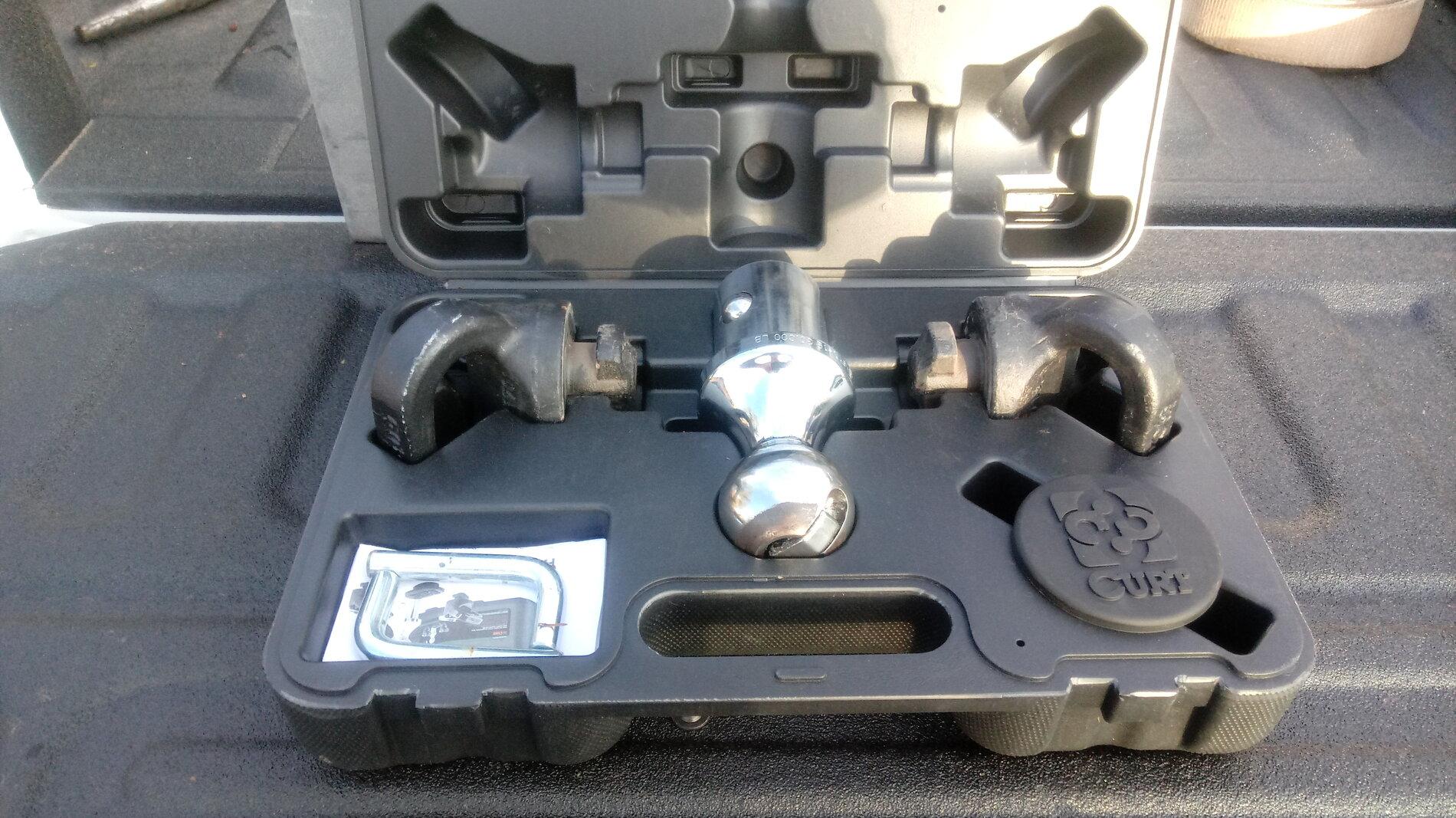

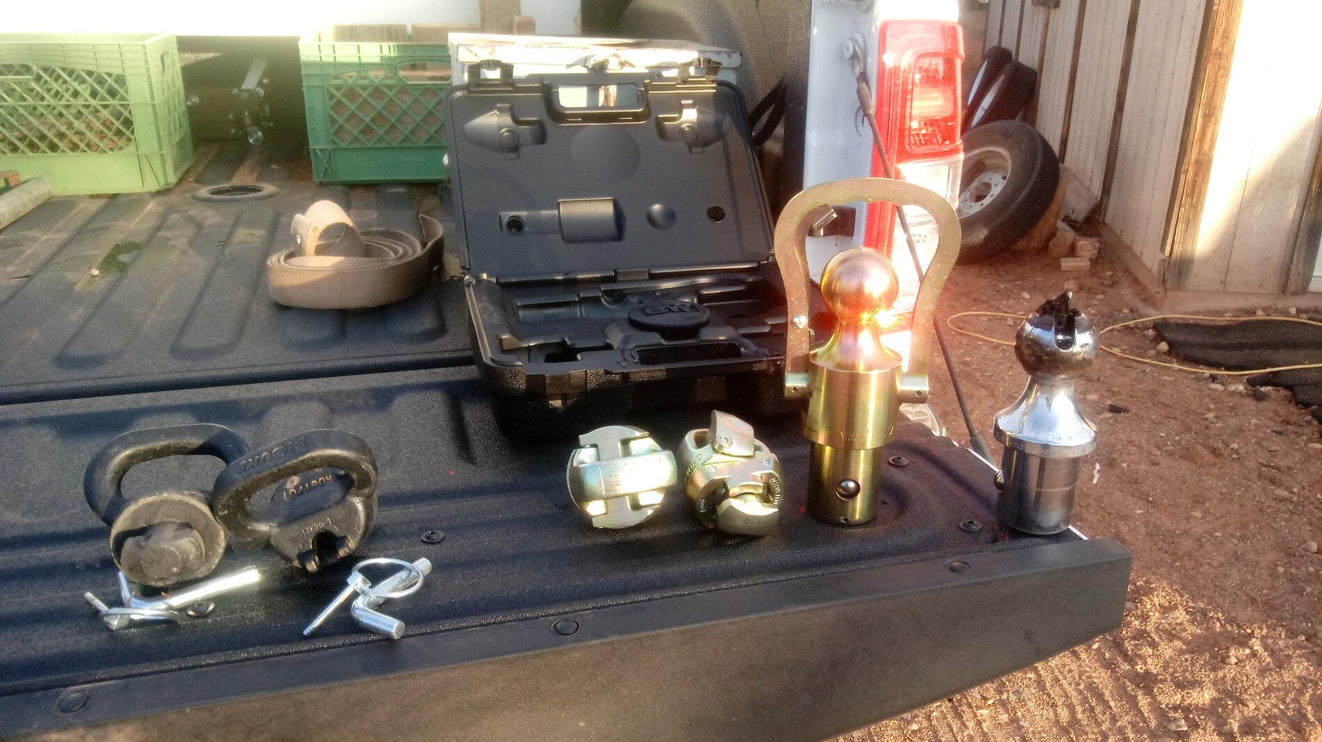

Could not stand it, didn't like the Curt at all. So I ordered a B&W ball kit. I also figured, with the extended shank, I could re-adjust my PJ hitch and make it work on the new truck. Yup, 7" of clearance at the tail gate v/s 5.5" with the Curt. Now, from the center of the trailer axles, to the front, at the gooseneck riser, I am 1/2" high. That works for me:)
The Curt is on C/L already:D

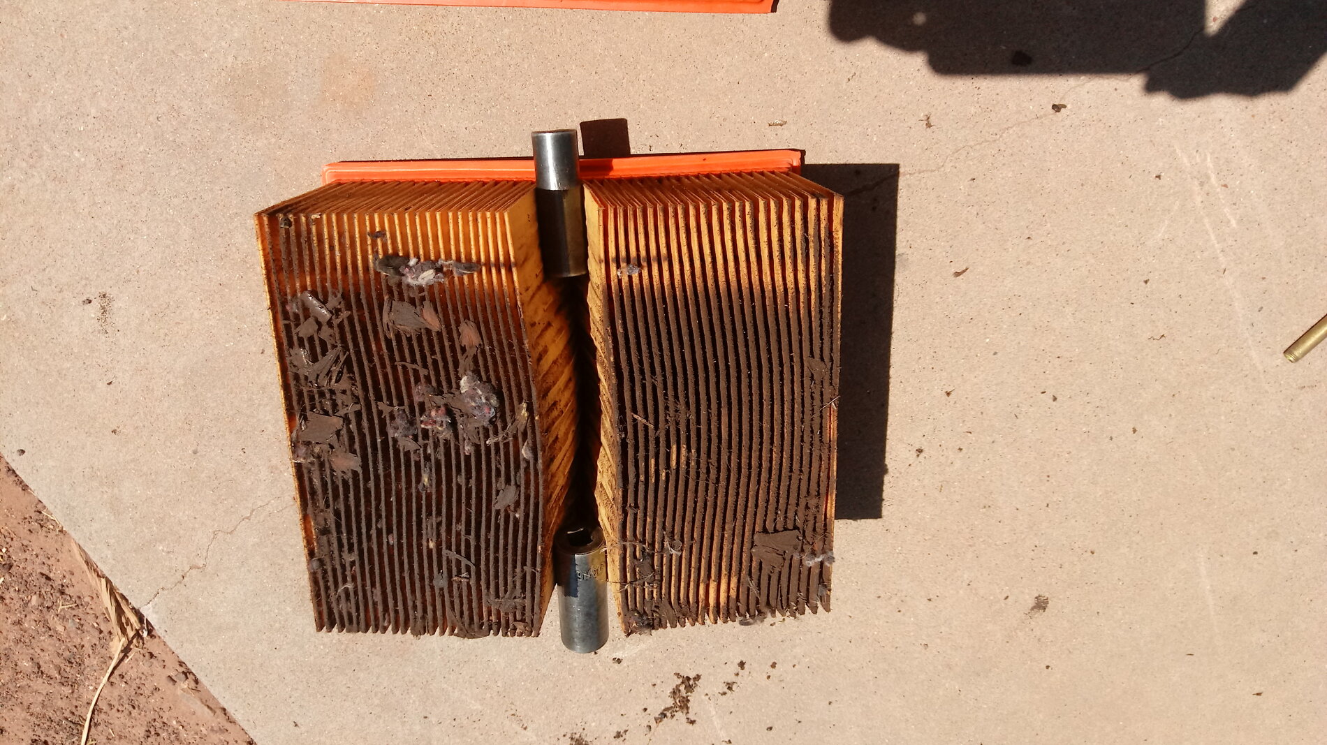

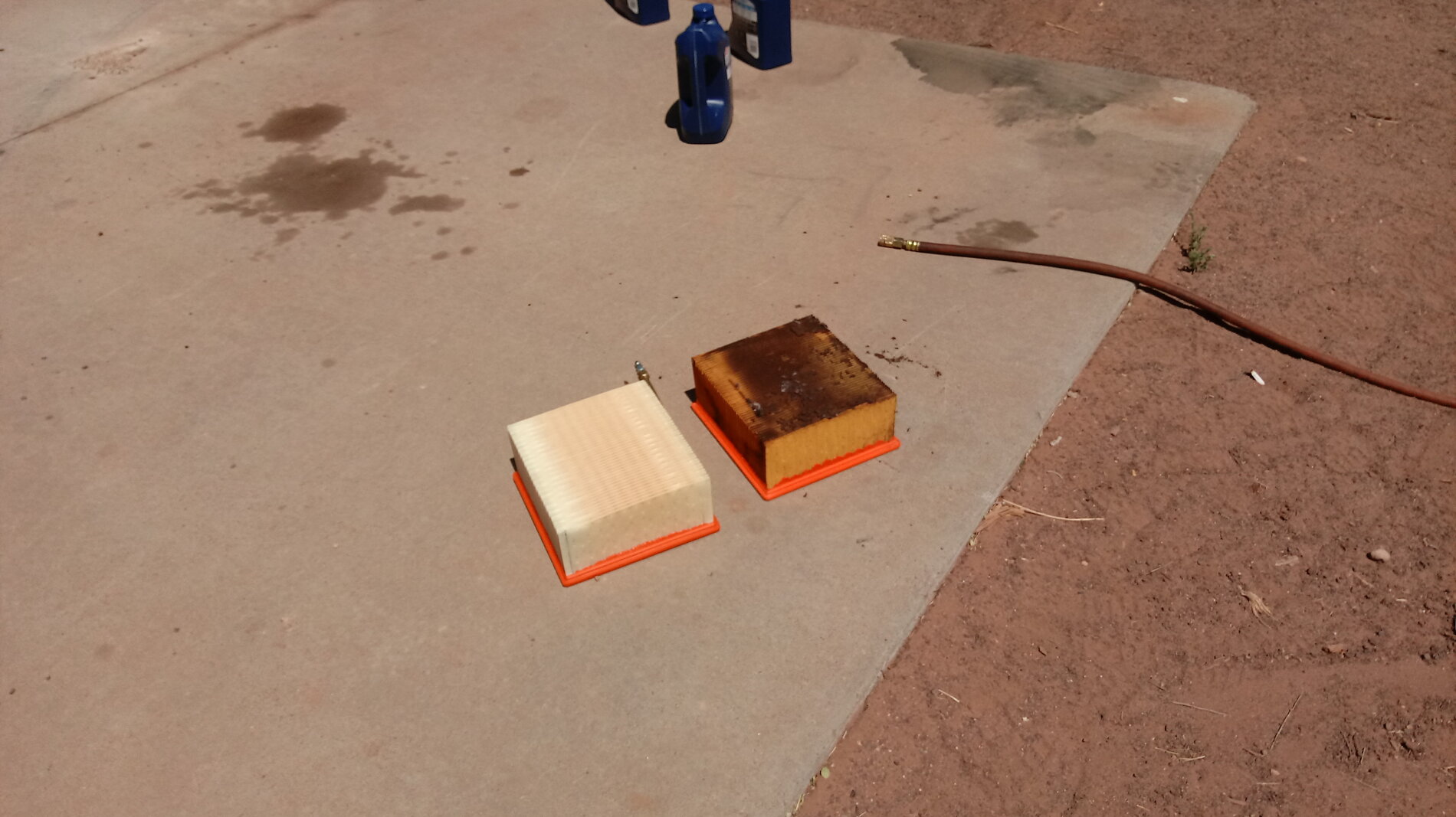

Air filter looks better than the '01 usually does, must have a better intake location, plus it is a lot bigger. The fender well on the '01 is not ideal.
Changed oil and air filter today, one year since my last change but only 11.5k miles. Almost two years on the air so it was due. Need to change fuel filters tomorrow. I need to change the cabin filter too.
