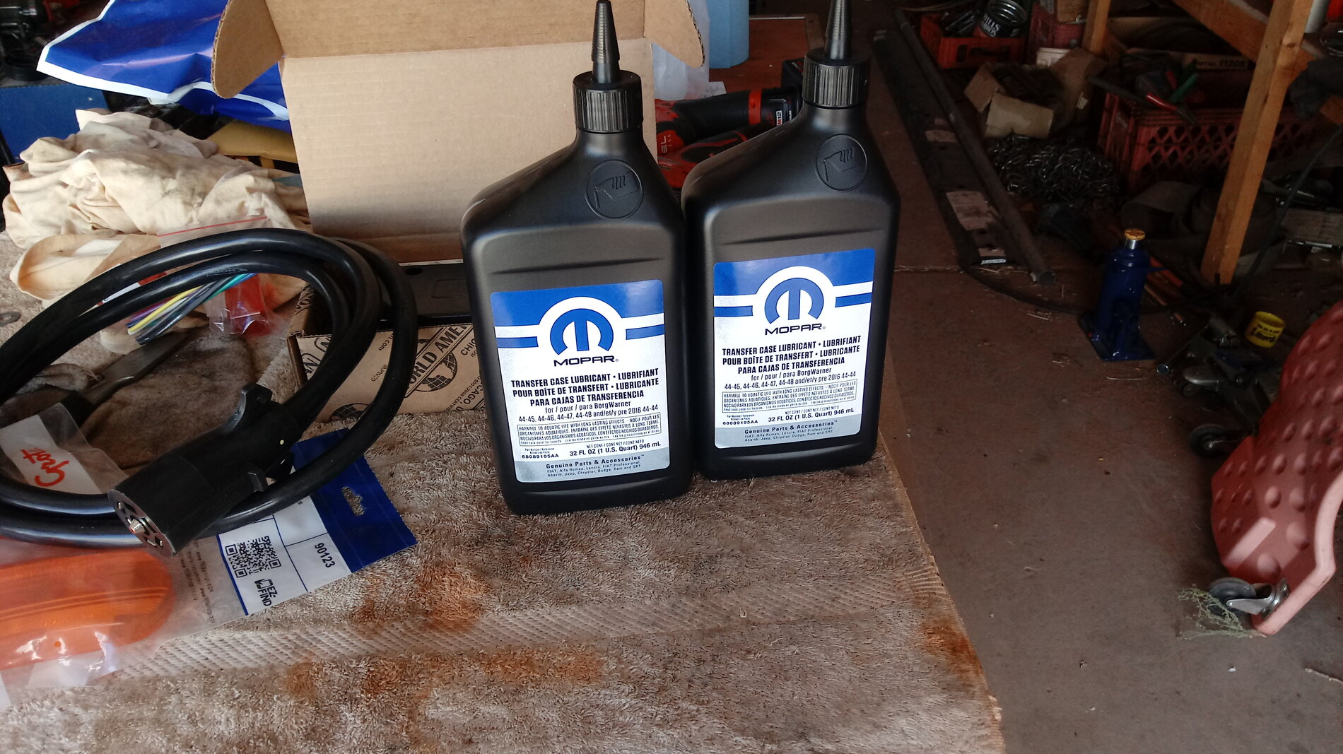

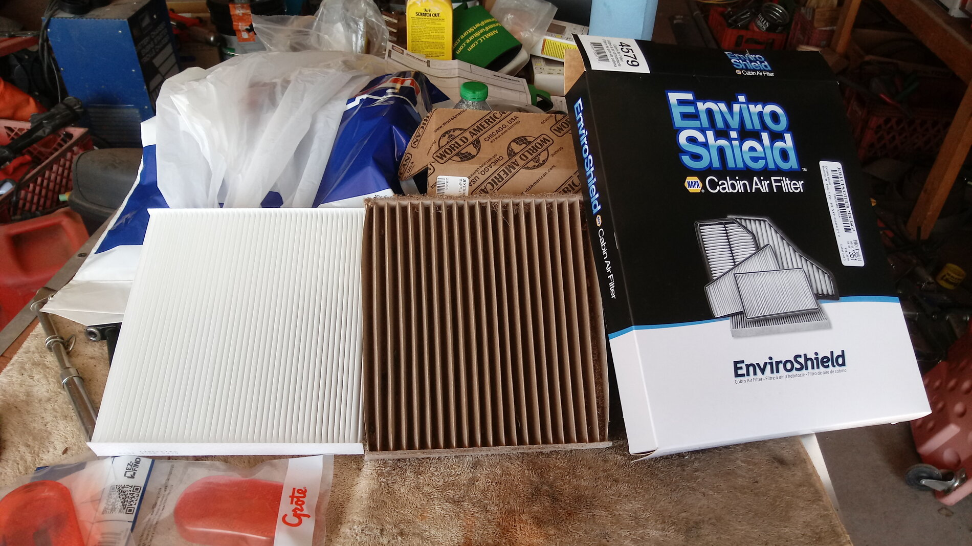

Changed out the cab filter, 2 years old is too long for my travels, will need to change yearly. Appears the Napa is a much better filter than OEM, if pleats mater. Picked up 2 quarts of Mopar B/W t-case fluid, $44.75 each:eek:
Yeah cabin air filters don’t last that long. I’m already on my 2nd in 10K miles and 8 months.
Ram claims it’s a 12K mile service interval, but mine never last that long.

Changed the t-case fluid, it was very dark red. 30k recommended, I am at 28k. I think I will change out the transmission fluid soon, dread that. Recommended is 60k but...

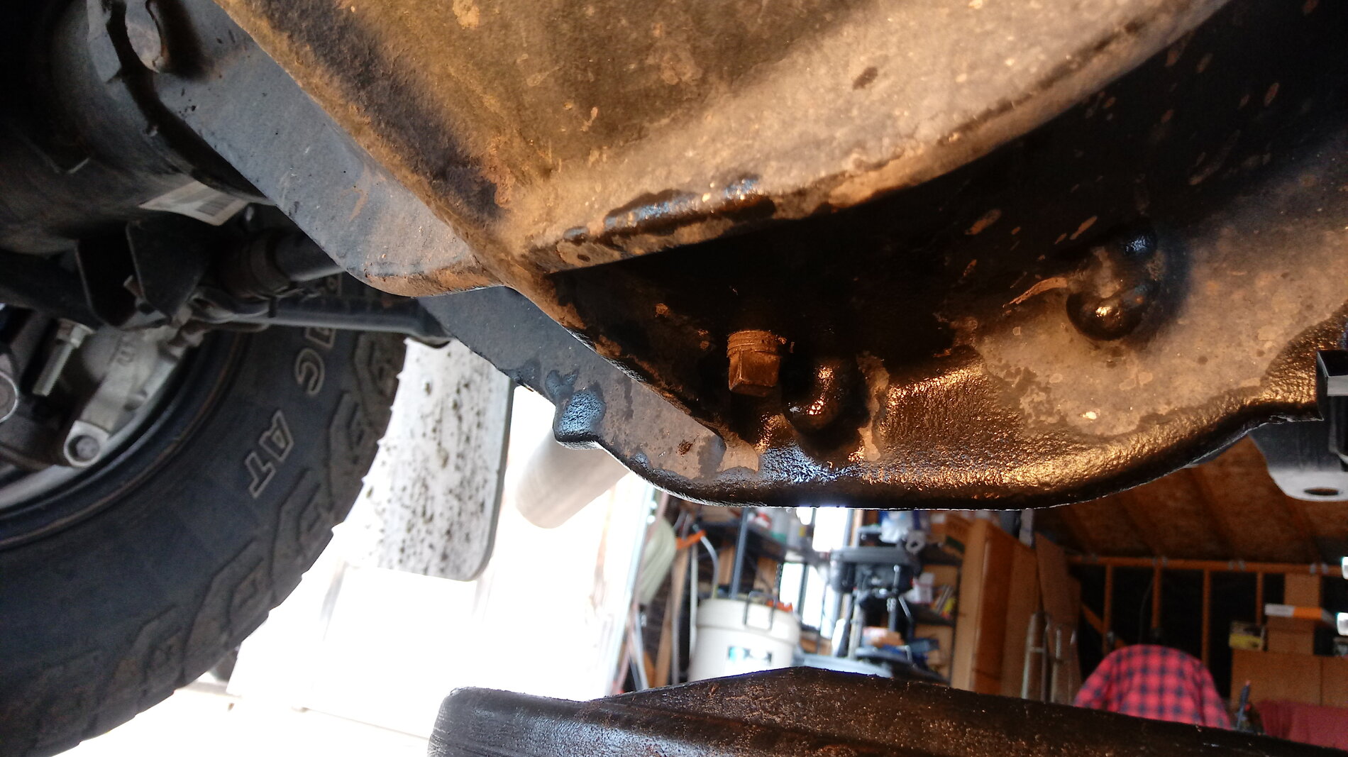

What do you guys think about using a roofing screw for a drain plug? Will the rubber washer stand up to ATF? What is EPDM rubber? Some descriptions say Neoprene.

@NIsaacs, Why not drop the pan and add the B&M drain plug kit or just have a bung welded in? I wouldn't trust a roofing screw to hold on the bumpy trails you go through the pits on! I added the B&M to my 68RFE and haven't had an issue. Been about 40K since it was installed. If my TIG welding skills were better, would've added a bung. :oops: But maybe as I get more practice in, that'll be a choice down the road. :rolleyes: Either way, it's much better the ATF in the face deal on the last bolt!

Okay, like this? I wanted to avoid trying to weld a bung in.

Every one of those B&M kits I've installed have leaked... finally on my Chevelle, I welded in a bung and put a plug with a crush washer in to solve that issue. Just a little more work to tig it in,

12v, why not the screw? Seems simple enough. Can't imagine it coming loose and the rubber washer won't leak. I know it seems funky but is it really? Ya know, thinking outside the box:)
The problem I see with the screw is the thread count - it’s pretty coarse. Just screwing it into the pan doesn’t give much thread contact area. If you used an awl to make the hole, it would push metal up to give more contact area, but I’d be afraid of wearing the hole out with a couple of removals. Myself, I’d still TIG a plug into it, but that’s just me. Not everyone has a TIG welder…
