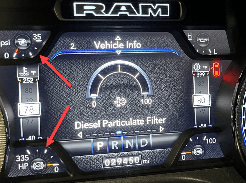

A few days ago when I pulled into the yard to load some cinders, I noticed I was in regen, you can hear it at an idle. So, for the first time, I switched the dash to watch it. Pretty boring, lol. After I loaded and got on the road it lasted about 20 minutes.
Then since I was messing with the display I went to boost and exhaust brake several times to see what that was. The most boost I saw was 27 psi and the highest brake reading I saw was 180 hp.
Just curious, what do you guys see on your SO or HO?
Yeah there isn't a lot of excitement out of the regen page.
Boost is supposed to go to 33 on the HO, but I don't think I've seen that yet. I also don't watch the digital readout very often.
Retarding HP should be the same HO vs SO and will be the highest at 3200 rpms. I'll have to pull the digital readout up and see what it shows on my next tow. It would be nice if the boost gauge would swap to retarding hp when the EB is active.
Agreeed!. I have both up permanently on the display but rarely look at them intently... I know pulling my 44' 5er there is plenty of retarding effort applied, no regrets. FWIW I know I've seen the EB go past 1/2 way many times.
If there is something else you would like to watch you could drop oil pressure, it's a fake reading.
Nah... Already too much to watch :D
I do however really like having the Engine and Trans temp on the scrolling side readouts. Really the only thing I do look at with any frequency, especially towing and slow speed (less that third gear) towing.
