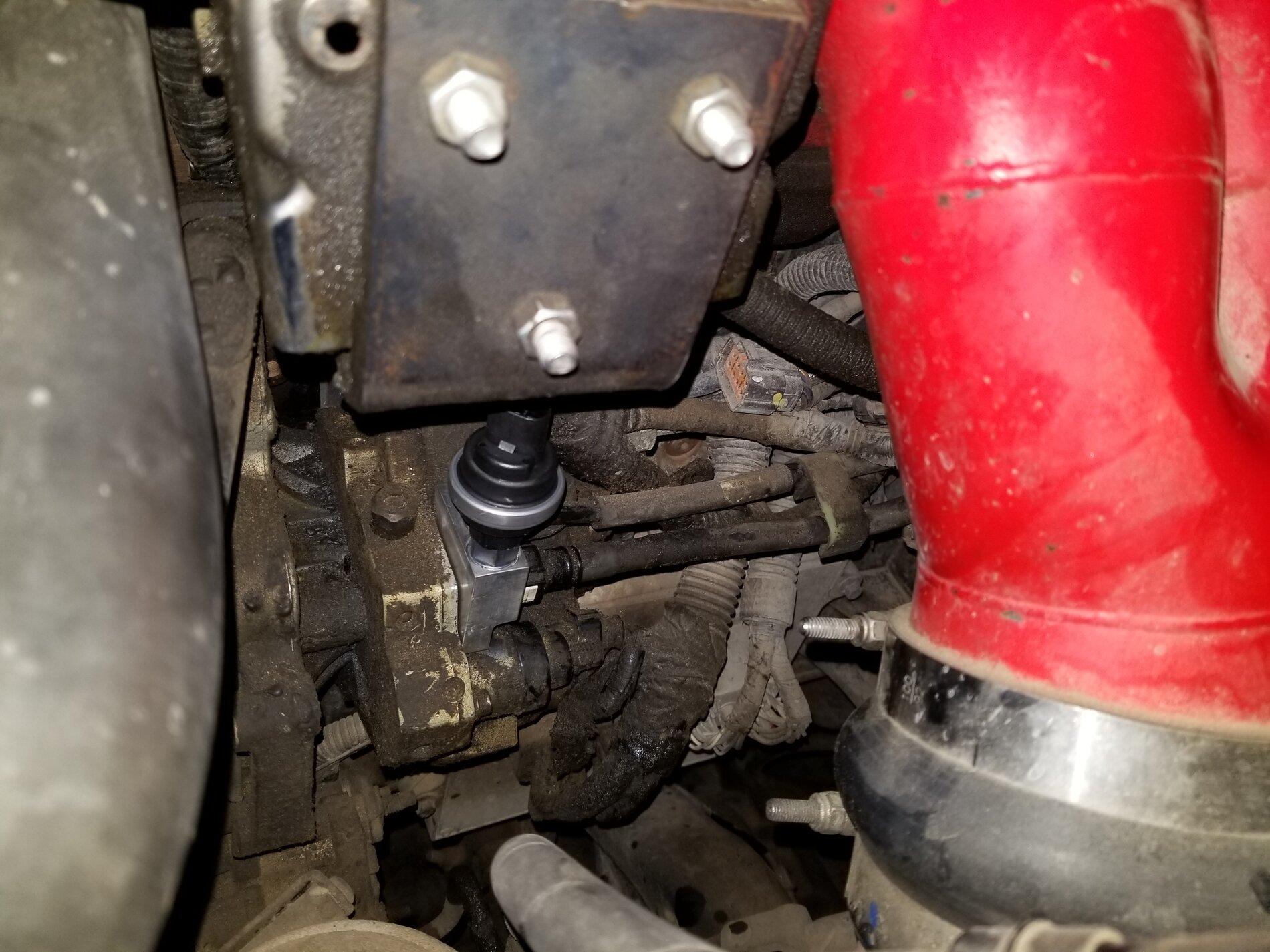

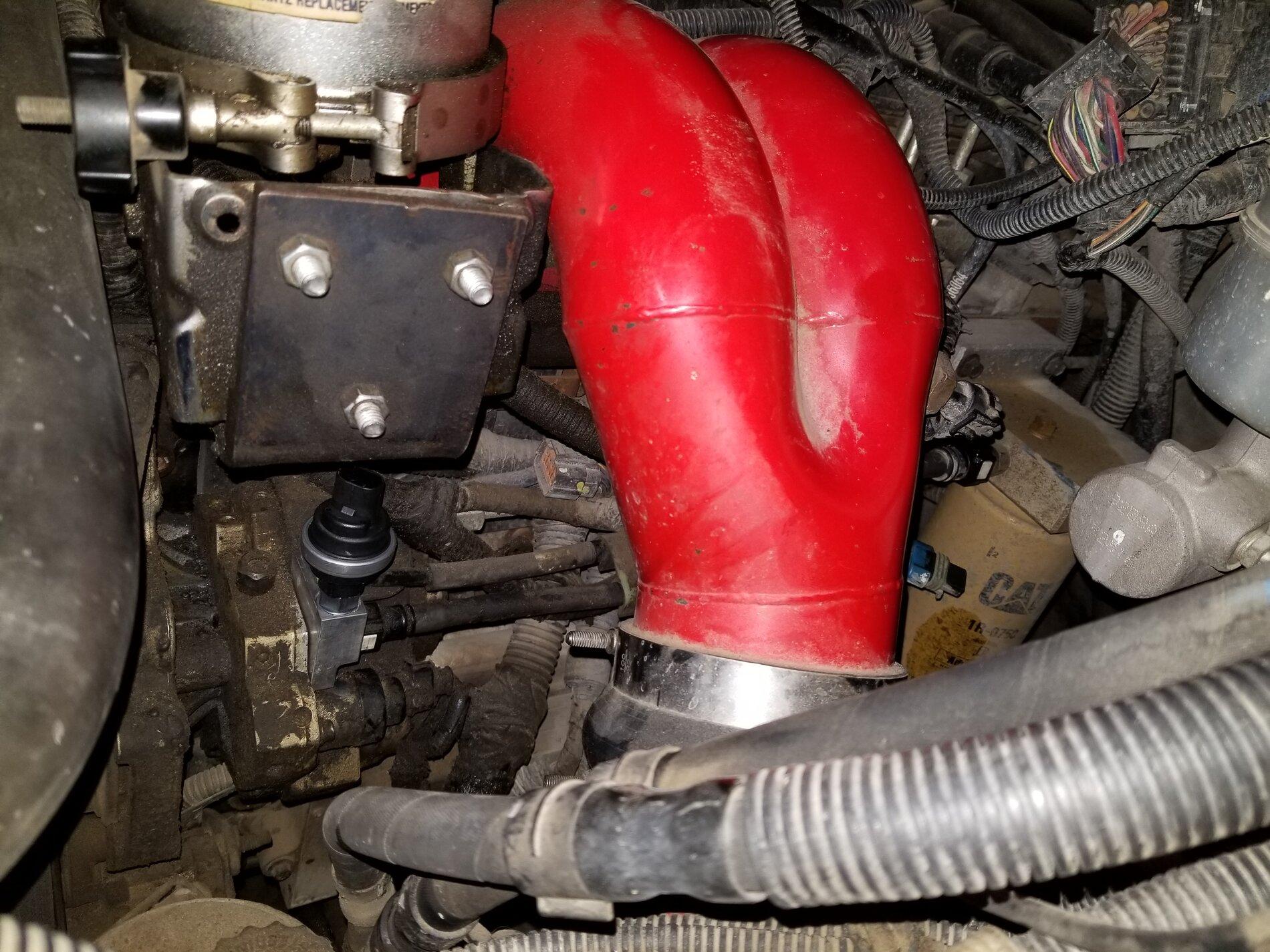

Install went pretty smooth... My only issue is locating my factory WIF sensor plug, so i can hook up the wiring harness!!

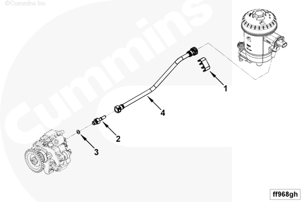

The fuel line connections are different between the 5.9 and 6.7 engines....so you are not going to be able to use the "65" kit on a 5.9 without some modification..
Fuel Line for 6.7..That's why the new banjo bolt in the "65" kit has the stub for the quick connect.

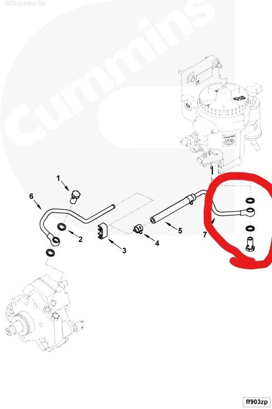

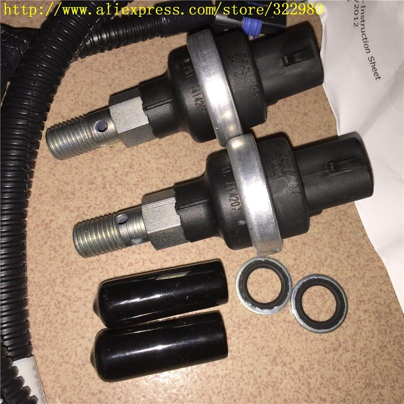

This is the sender / banjo bolt combo for the 5.9 contained in the "64" kit...I don't know why there are two pictured.....only pictures I can find of the older sensor.
So if someone can prove that the Banjo Bolt contained in the "65" kit is M12 x 1.50 like the 5.9 then you could either rig up a dead end quick connect to plug onto that tail OR have someone weld it closed....
I cannot prove the "65" fitting is that thread...I am pretty sure it is but I can not prove it...
Edit...scratch that idea, the banjo fitting will not be long enough to go through the existing banjo on the fuel line plus the added thickness of the adapter.....
If the "64" can still be purchased somewhere that's the way to go for a 5.9.
