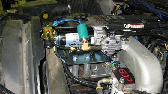

This is where it went on my 06
Note I notched the radiator shroud to give it a little more clearance.
