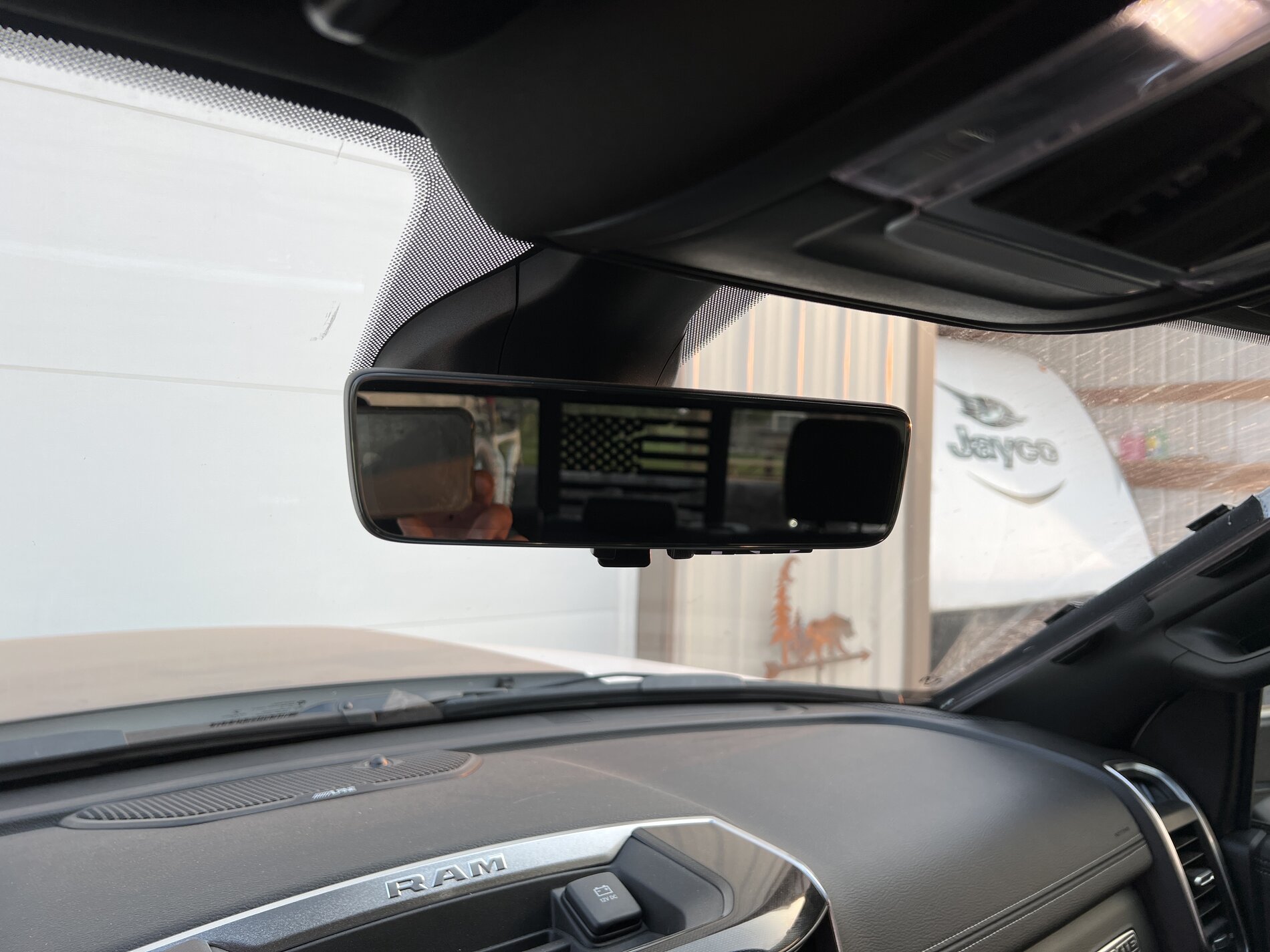

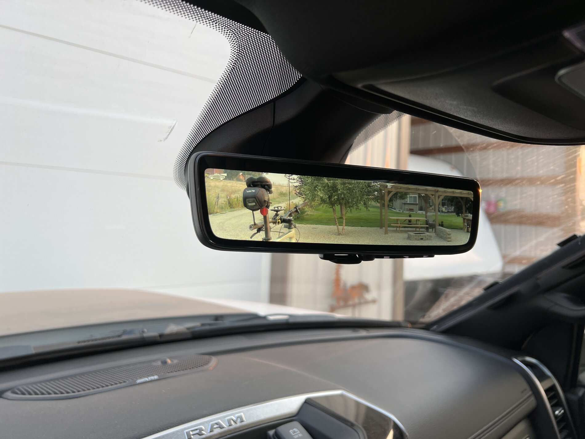

Mirrors the same size but the modular thing behind it is huge
Yes it is, but it extends above the mirror and not below or beside it so I don’t see it blocking anything for me more than the standard mirror on my’18. Time will tell.
When I picked up my truck I was surprised how small the box behind the mirror was. It didn’t match any of the photos I had seen of the digital rear view mirror. I figured out why today.
The huge box behind the mirror is part of Safety Group B and must have the camera and/or radar for adaptive cruise control and collision avoidance. Since I didn’t get that package I don’t have the same setup as most the photos.
