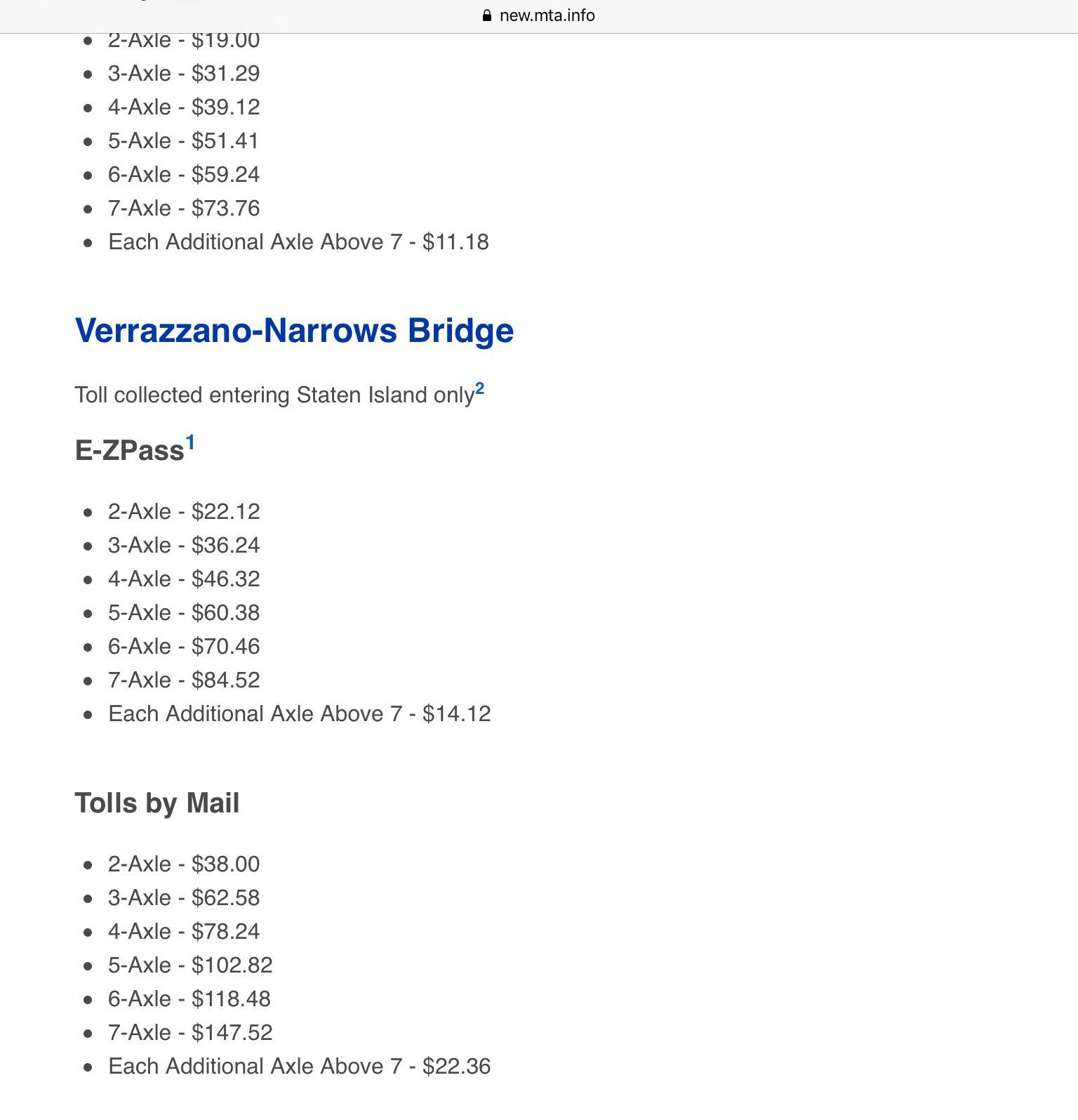

Yup! Wanna talk tolls? The consumer pays. Big.
Thanks for link. Ocean County
