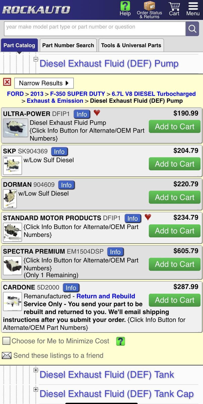

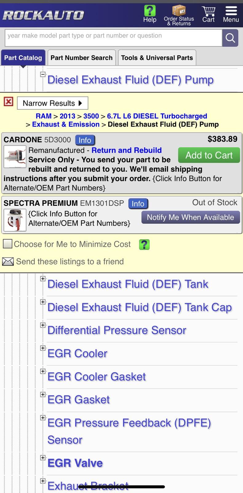

My point about the aftermarket parts situation.
Here’s Rock’s offering for a ‘13 Ford DEF pump. The OE Ford part is less than $300 and very available.
Here’s the same part availability for a Ram. Hey at least Cardone is offering to rebuild yours. Last I checked, that wasn’t available. The Spectra pump hasn’t been available since I started looking a long time ago.
