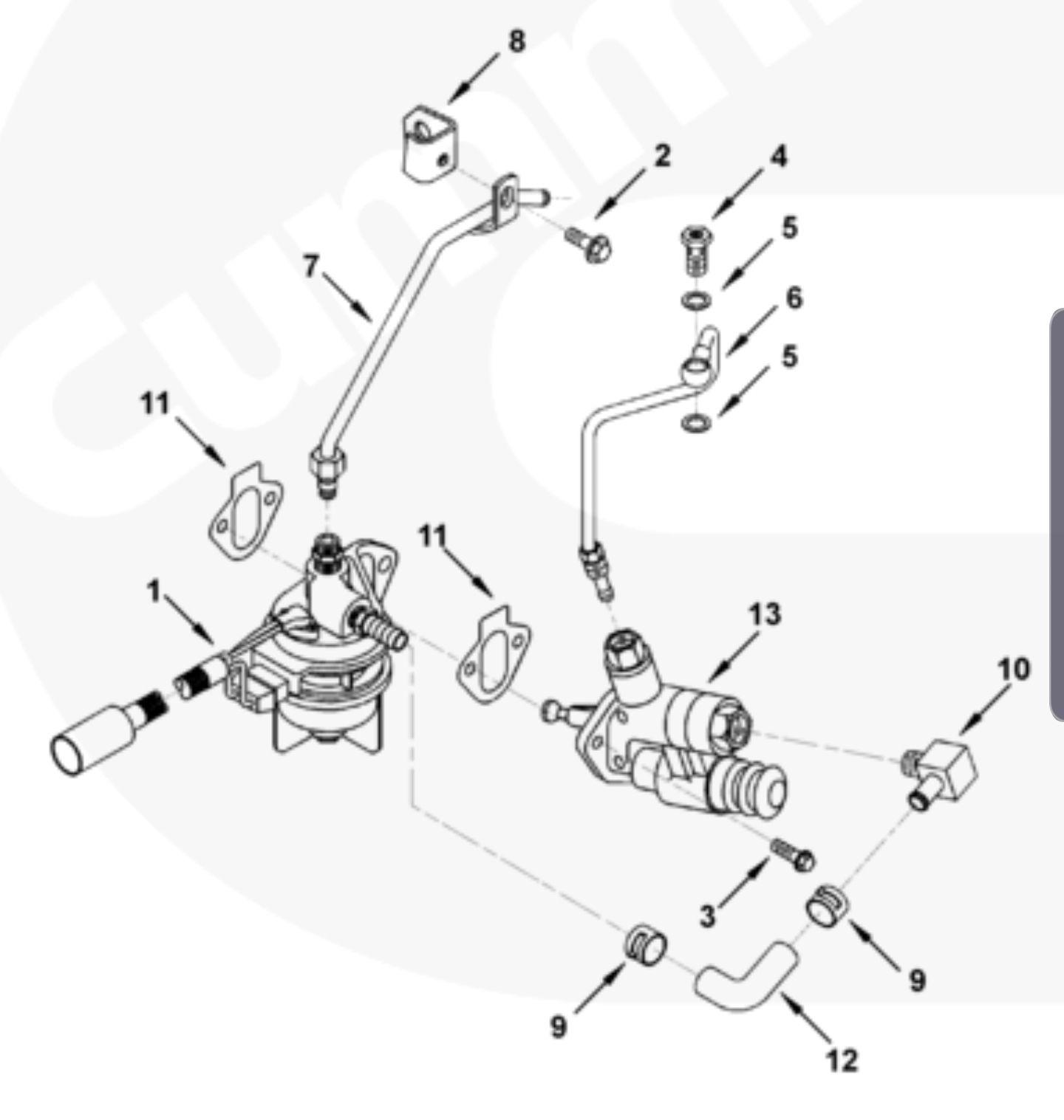

Next question..the rigid tubing line from top of lift pump to top of fuel filter housing ( banjo end there)...roughly 12” long..The best place to get a new one?? It’s shot...
Also, I didn’t find any washers there on this double banjo setup (bigger with small on top of it) on top of fuel filter housing. Should there be? I’m curious about this....
GAmes, I will do that going forward. There are washers with these 2 banjo fittings, yes. I had to run my fingernail around them & they separated from fittings. They were stuck. Since I’m at a standstill now with this job & time & weather is a factor, I bit the bullet & stopped at the dealer. The length of tubing they will have by Wednesday ($110 ouch!) with washers except for the smaller banjo fitting washer which is discontinued now. I’ll try to reuse that one. No choice? I also told them to throw the 90° rubber hose piece (lift to heater) with it. (Another $30 on order). I know I can easily find that one but time is of the essence here. Gonna be cold next couple days while I wait for stuff to come in. Wednesday & Thursday gonna be 50°...

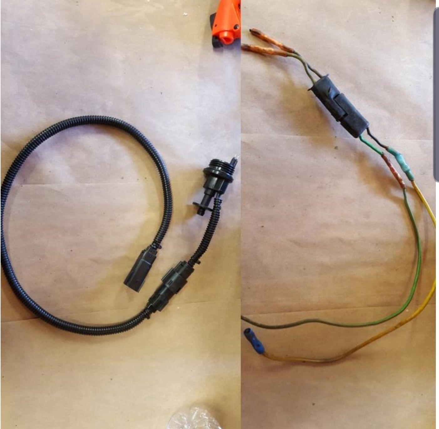

Quick serve sounds like a great connection. I’ll do that in future. I didn’t realize Geno’s would carry this fuel line (lift pump to fuel filter). Too late for me cuz I went to dealer ( very silly of me.) paid $100. So after I replaced that cuz old broke when replacing new lift pump, new fuel filter, new torktek overflow valve, cleaned up fuel solenoid & replaced relay, the truck starts & runs great! Alls I have going on now after this job is the WIF sensor light came on & staying lit after I drove some. I flushed some fuel out of filter but light stays on. I gotta fiddle with plug connection. Maybe this will kill the light I’m hoping. Don’t want to have to drop the filter to replace sensor. A PITA job that is especially since I plastic rivoted back the wheel well insert.
Yeah my WIF sensor someone must have not known it unplugged and they were just unscrewing it for a long time and fixing the connectors. I've posted this a few times. But I wound up remaking my connector since my factory one was beyond shot.
Yeah I had a bunch of stuff apart when I did mine. Pretty sure got it from Genos.
I would think it closes the contact, to light the light there was another harness up on top of the engine from what I recall towards the back of #6 cyl, that's why I have 2 plugs. Those are aftermarket plugs I made up, yours will look different. You could try to unplug it.
I disconnected my WIF connector years ago. For one thing, the only time the light came on was when I washed the engine and the connector got water in it. The other thing was the difficulty in unplugging it for a filter change always resulted in me bleeding. I use thousands of gallons of fuel from all over the US and Canada every year and I don't worry about a WIF light.
