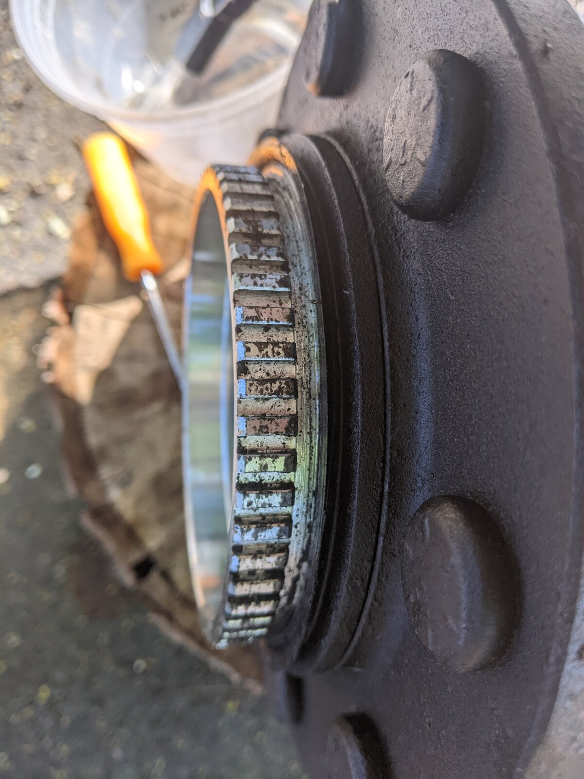

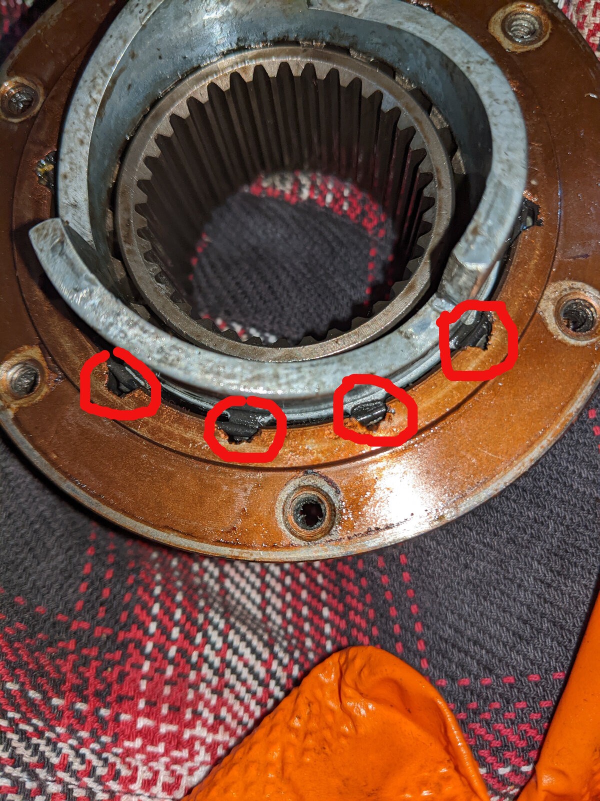

That’s a strange ware mark. I agree. Take the lock mechanism out and give everything a really good cleaning. I almost wonder if that is some rust and grease…
Thanks for responding. Definately not grease. Original photos make it possible to zoom in and see what looks wear or damage to the body, but I've not investigated further. I did send the same photos to Mile Maker, but they haven't responded and if I understand their warranty correctly it's only one year on non OE kits.
