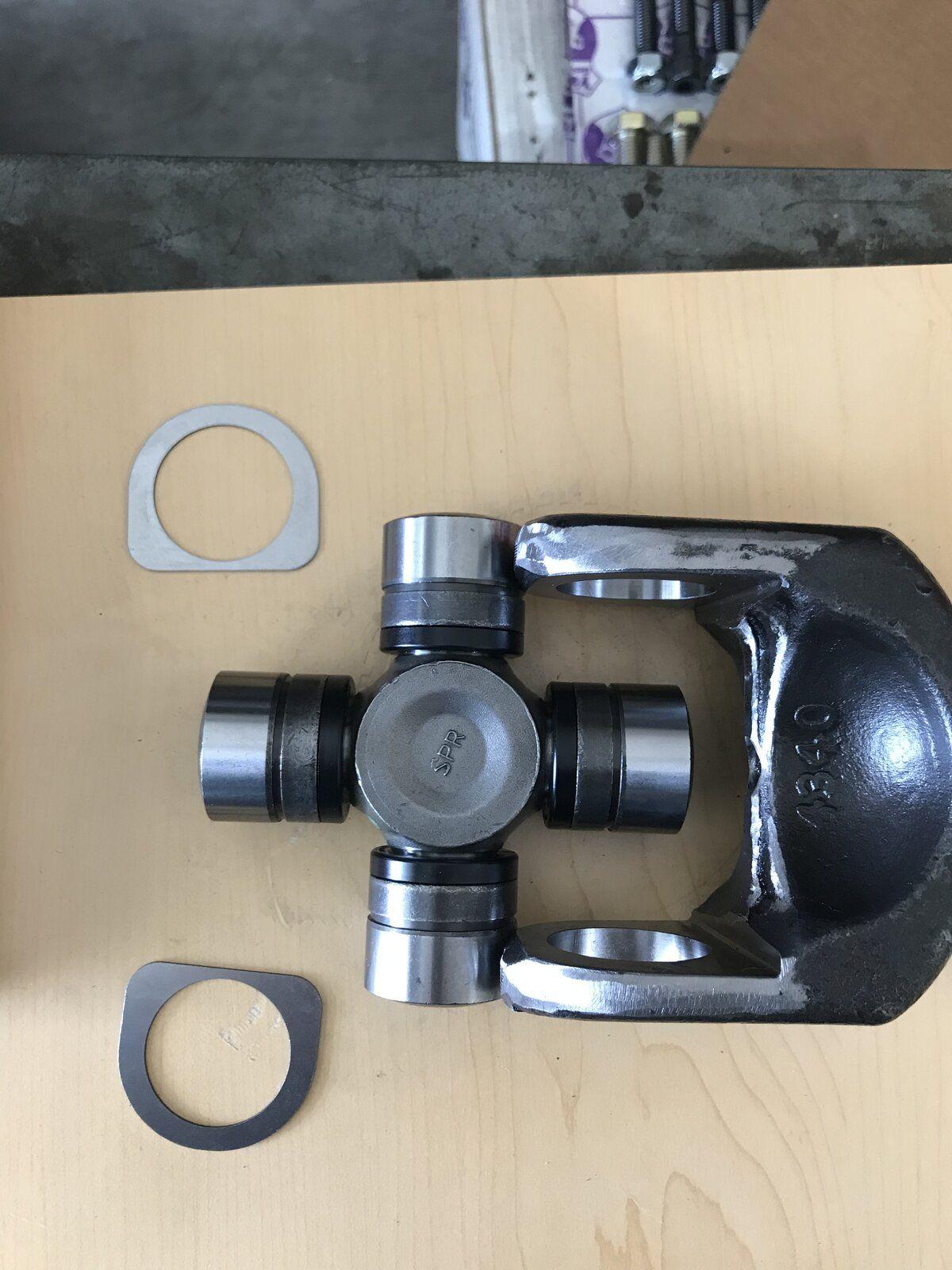

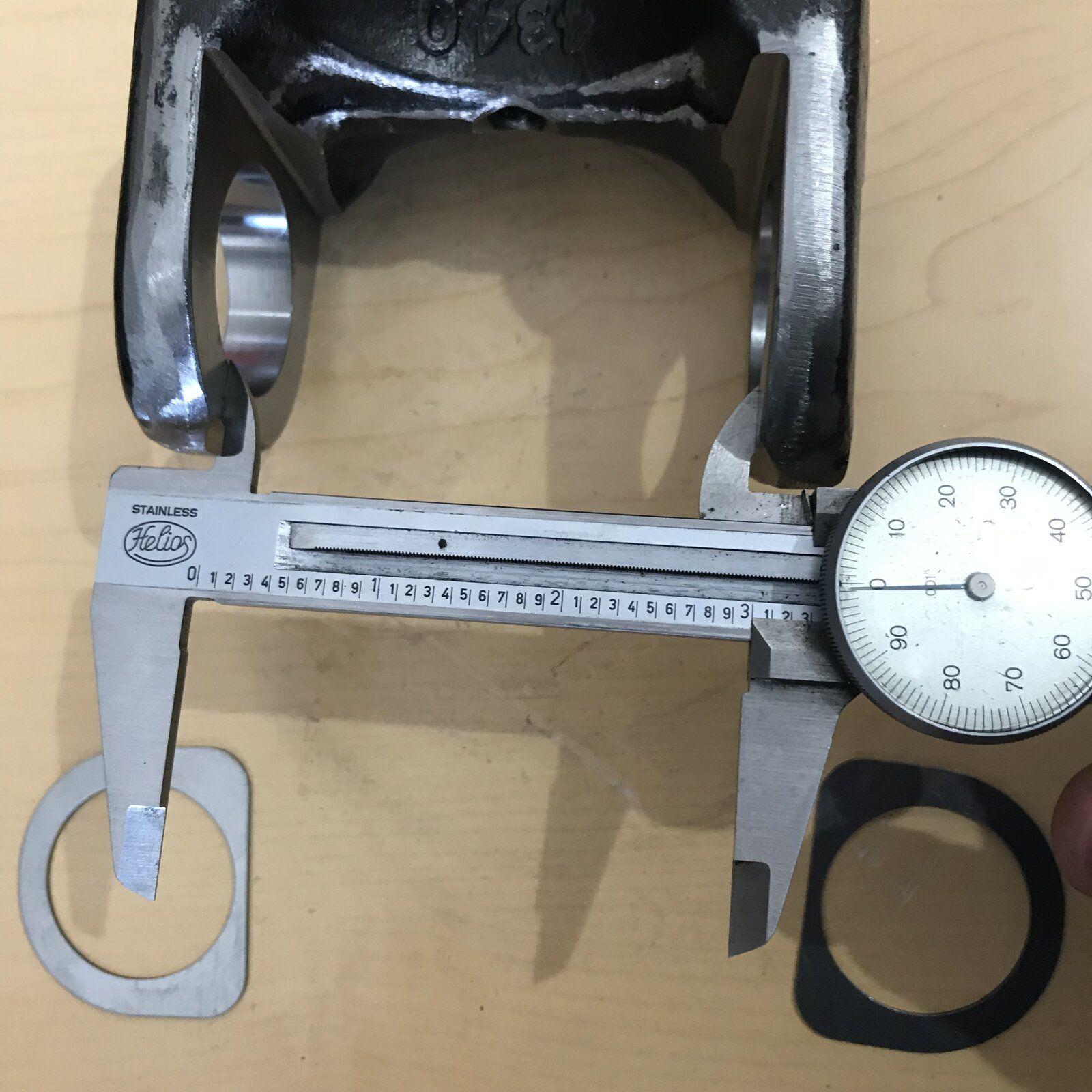

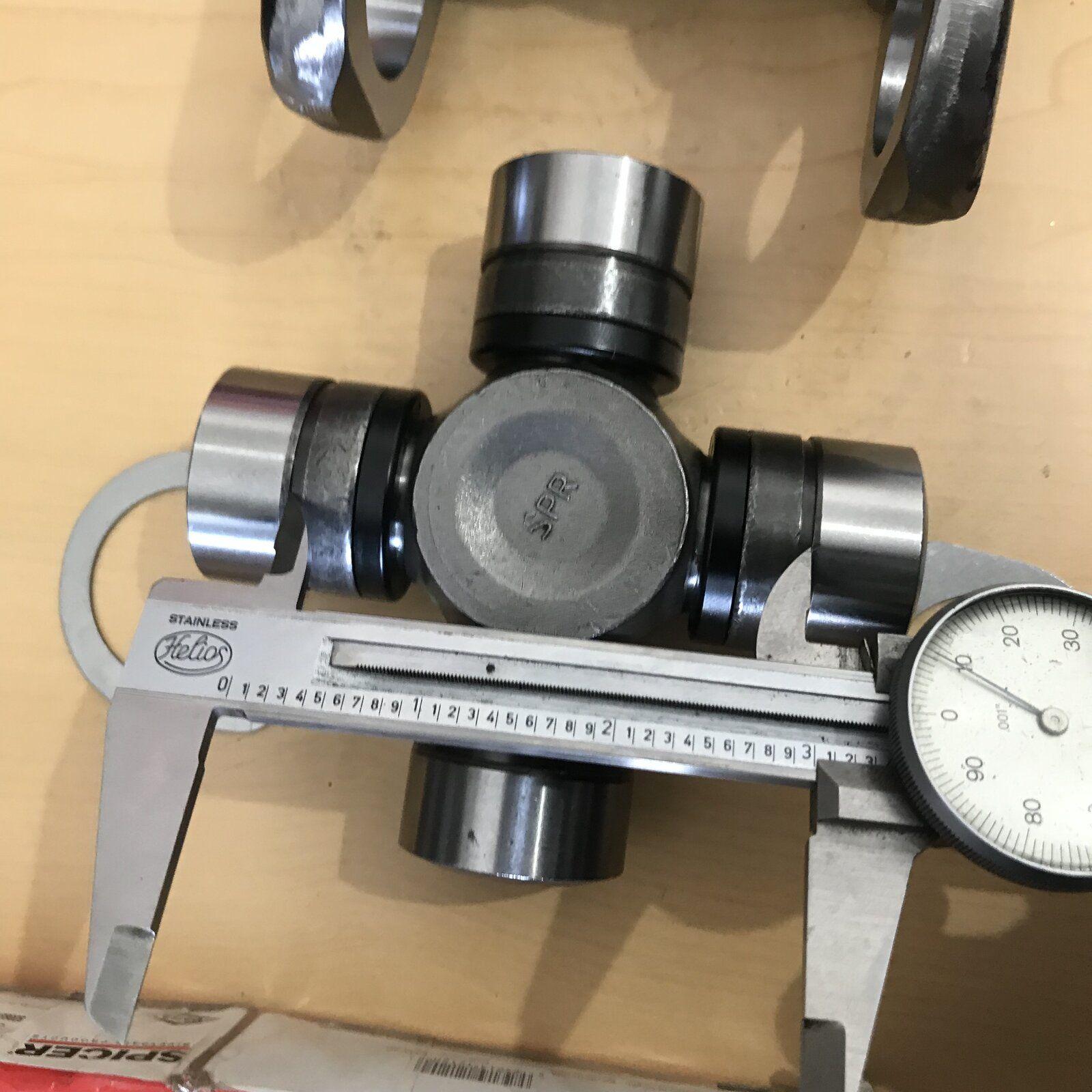

Now my issue is with the Yukon yoke as you see in the pictures, the u-joint and yoke almost measures exact. My caliper measures it out to only a few thousandths different, but the shims I’m supposed to use are .80 thousandths. Which could mean the u-joint might not fit the axle yoke. I did buy the spicers u-joints from Geno’s, so I don’t think it to be an issue. Will the seals inside the bearing caps seat to the inside, flush with base? That might get me the .80 thousandths I need to use the shims provided.
Thats exactly what I'm thinking, I thought about using the press to see if it will, but I dont want to lose the virgin seat, if that's the case. I want to prep the Yukon yokes prior to tear down, to save the time the truck is down. But I'll have to add the shims that will put it .80 thousandths off, if thats not the case, and have to press out the u-joint out again, if it doesn't fit properly.

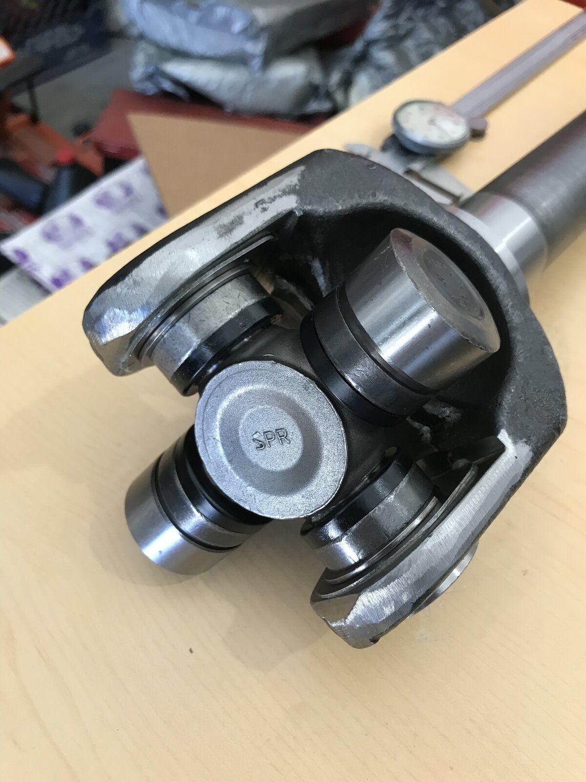

So I did them, assuming just that, and it seems to have worked, see picture. It seems to be tight, but no rough movement.

I still have to install the locking mechanisms though, as I ran out of time. Part of the reason the install was delayed, was due to tool purchases with several trips needed. I really had a though time with the ears to the axle shaft U-Joints. Keeping them as strait as possible, during the pressing out of them, it was because the casting wasn't equal on each side, which made it a chore. The 12 ton press wasn't the problem, it broke them loose with a bang. The ears ended up bending inwards, I didn't notice at first and pressed in the long shaft U-Joint and found the clip groove partially covered on one side. I finally managed to straiten it out (THE HARD WAY) and got the clip in. The short shaft did the same thing, but this time I was ready for it. I reversed the old U-Joint caps in one side only, so not to egg out the hole, and beat them strait with a small sledge hammer, It worked great, the U-Joints went in smooth and true.
