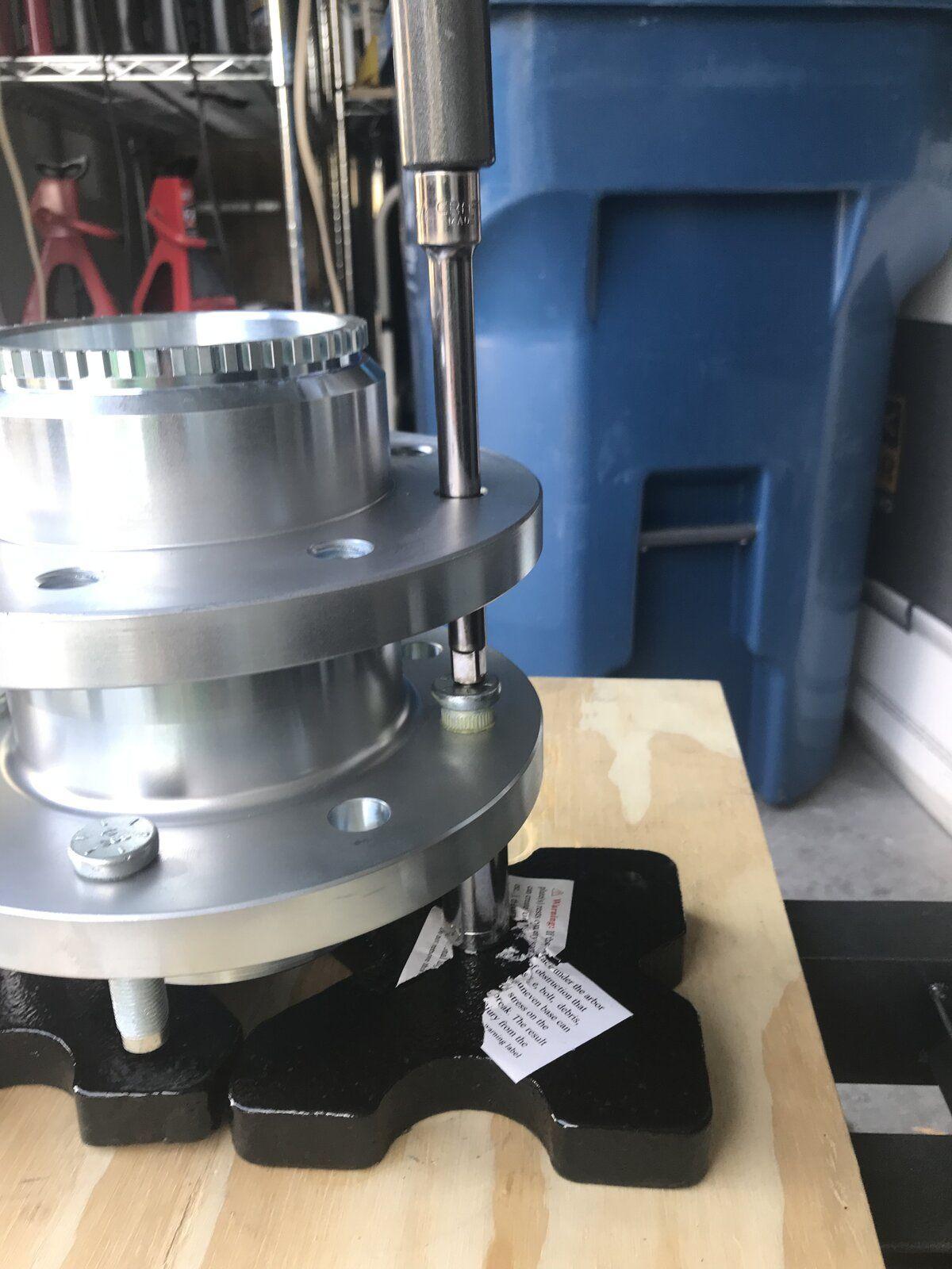

Got the studs in, as you see in the picture, I went through the threaded holes for the rotor. Note the 3/8 extension with two deep well sockets opposite of each other. I used Mercury 2-4-C marine grease with Teflon, went in like butter.
