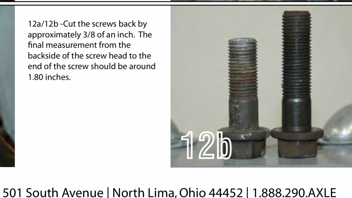

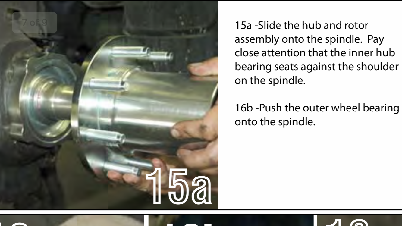

The spindle has threads that you bolt to the knuckle, instead of the traditional nut and bolt configuration. The instructions even ask you to shorten (cut) the four original mounting bolts that bolted the unit bearing, due to length. The second picture, you see the spindle side of it.
This issue above is no big deal. I don’t know of any OEM hub bearing that is drilled through and nut/ bolted. The material the spindle mine was made of seemed of high enough quality to not be a concern. I’ve been under there repeatedly checking torques for settling, etc, and never had a problem. I’ve even had them apart once to repack (water intrusion concerns). I would surely do my kit again to another truck.
Ok, I just purchased the Yukon kit (YA WU-05). I think that the threaded attaching spindle is OK on the Spyntec, now that others have confirmed that they haven't had any issues. I still don't like the fact you have to cut the bolts to fit. I decided on the Yukon kit due to any hub failure, it will default to four wheel drive. I also like the fact they give all new hardware with the kit. When I started this thread, the Spyntec site or vendor stated (somewhere I read it, but I can't find the info at the moment) that you had to put a core charge on the front DWR hub, so they could machine it for the next kit they build. With Yukon, everything is included, and after I called Yukon they gave me a $100.00 discount as well. The kit cost me $1766.40 after discount. I'm thinking about doing it myself now, but I'll have to do it in two parts, one side one day, then the other side another day. So I'll wait until I know I have a weekend to do it in, if I do it.
